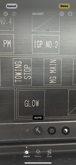

Theres an odd relay in the main fuse box under the bonnet called TOW STOP ?? Actually that relay is missing
Dealership just called I may have hit on the problem they want to try a relay in the spot where the TOW STOP Should be!🤞
I wonder if that “towing stop” relay is for the US versions with the tow hail electric braked trailers, which we don’t have.
I, going int Steven Eagell today to get the TOWING STOP relay see if it works they are trying there best but they are as frustrated as us customers James the after sales manager is being very good I wouldnt be at all surprised if they look at this forum ???? if so good morning James .
Hello all just pluged inthe TOWING STOP Relay and no difference the car is not recognising the trailer
That’s annoying - as you said, maybe it is a coding issue / software update needed.
