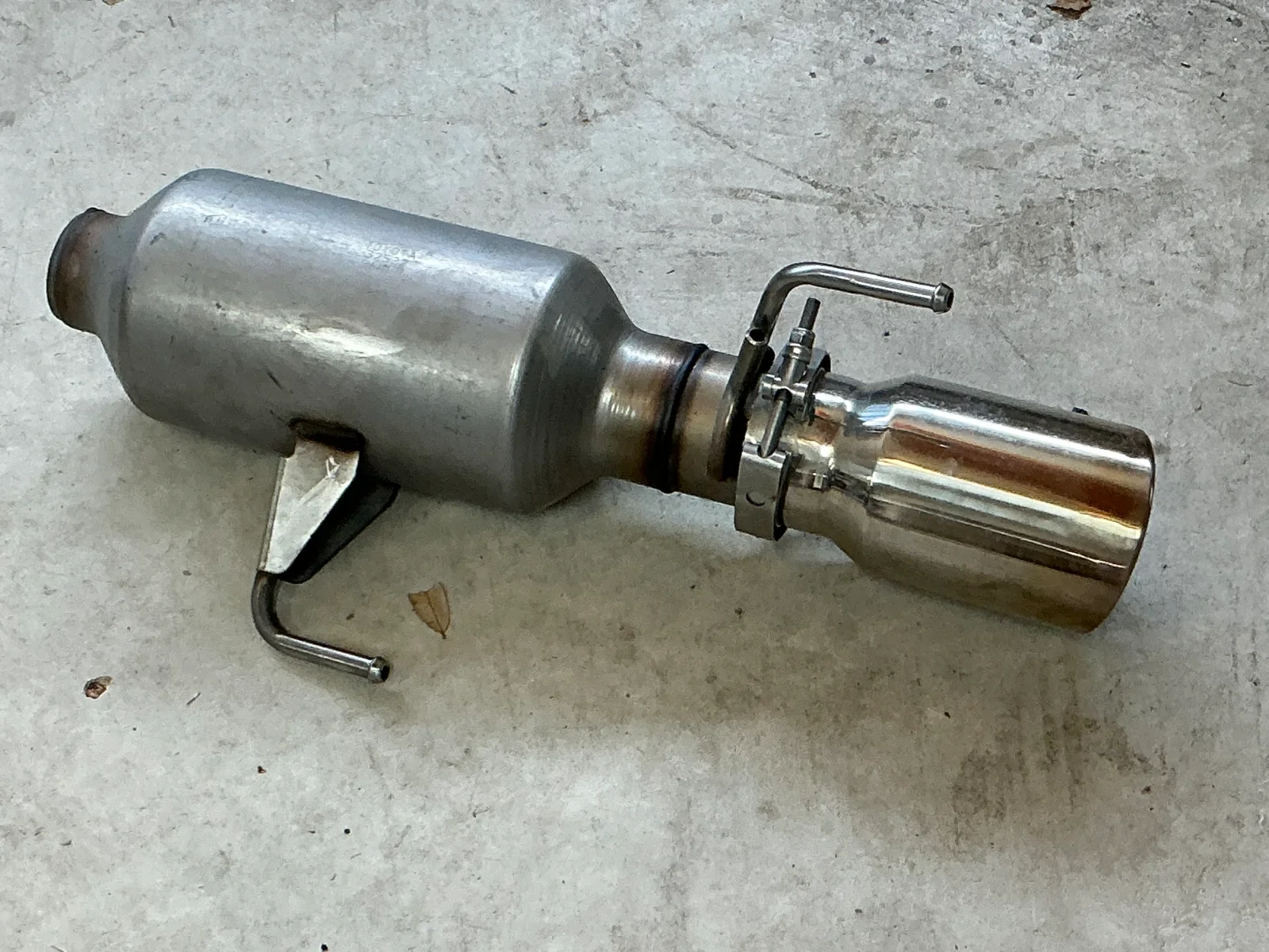

I actually like the lower tone exhaust, & removed the rear resonator. No drone at all on the highway. I think your main center muffler should have a small dead end pipe coming out of it - 1/4 wave or Helmholtz pipe to reduce exhaust drone. Those mufflers can take a few 1000 miles to break in.

You can have my resonator if you’d like, just pay to ship from TX.

Ray - This is what resonator delete sounds like
Wait do you have a dual exhaust system? is that an aftermarket add? Also without the resonator wouldn't you expect more noise inside the cabin since that's the function of the resonator? you mentioned earlier too that you don't hear the highway drone after the resonator removal which I'm not able to understand how? Can you explain it if possible?
