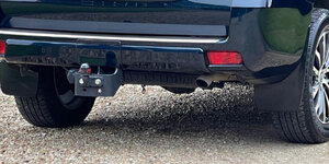

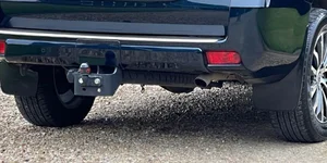

Dave that’s massively impressive, hats off to you. I guess you need to buy a pack of plastic bolts/clips to re-fit the bumper and taking that off / re-fitting is the worst part of the job?
One of my previous LC’s had that towbar, can you adjust the height once fitted? I can’t remember.
Yes mate you can just the hight but it’s at about 50 mm as it comes it’s mostly push fit and 10mm speed bolts

Dave - this is the Toyota flanged towbar that I had on the other 3 LC’s.
I think the fixed version you have is neater but is it as easy to change the height on as I have two trailers of very different size??

You have done a great job there Dave.
Thanks for the photo, I see how it pivots on the rear bolt to alter height.

How low does it sit? Does it greatly reduce the departure angle?
No worries it’s a pleasure it’s a great car but I’m not sure it’s a tough off road vehicle after stripping down the rear end the plastics are very flexible flimsy maybe unfair but certainly not tough the FE mud flaps look good but not sure how they will stand up but you will be pleased overall
This will be my 5th LC so there’s not much that will put me off!! Good to hear you like it though.
What do you think of the engine? That’s my one concern as it’s the same one as before and I felt it could do with more power and be quieter / smoother.
The bottom of the tow bar / swan neck is the same level as the spare wheel tyre
