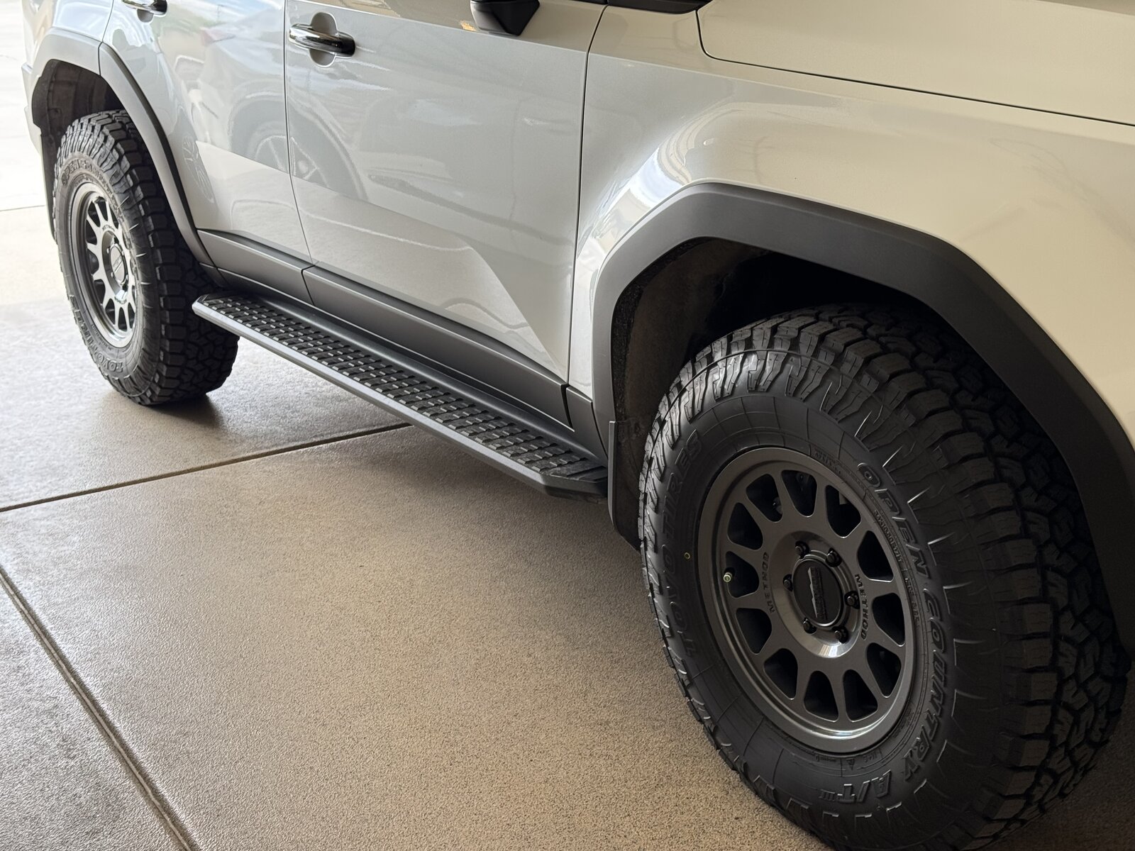

Hi! Are you on stock suspension/no lift? I’m considering 285’s as well (but on 17’s with a + 35 offset).Trying to see if they fit without modification.

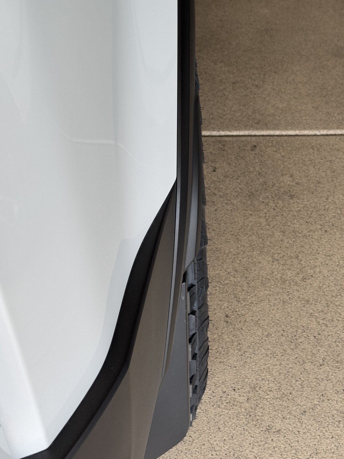

I originally installed on stock suspension w/ only the slightest rubbing in full right turn backing up, and not enough to bother trimming plastic. With the other heights I've had the aftermarket suspension set at, +1.75" up front had a decent amount of rubbing, again full right in reverse, but +2.5" up front has no rubbing at all.

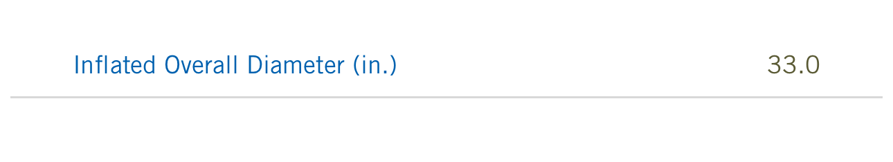

What was the diameter of the wheel on your 18s?
AT3 285 on a 17 would be 33 and 275’s on a 17 would come out to like 32. Wondering if I can get away with 285s on 17’s without lifting
Not sure I understand your Q... The dia. of 18"s is 18"......
Whoops! My bad haha. I meant overall diameter.
This is for the 285/70/r18
Oh you're talking tire!!!! lol My fault! I believe Toyo says they're 33.7?
Got it! I think I most likely will go with 275/70/R17 E for the AT3’s. The lightest in that size I’ve found so far at 51 pounds.
You would need to reposition components near the wheel well as well as a lot of body trimming, As 35s are bit aggressive looks
His offset is +20. With less poke (+35 or more) he would have no problem with 285/70/18. He could even go larger in diameter with less positive offset.
Also, you are talking 285/70/17, which is even smaller in diameter. You should have no issues- just watch the offset.
Im sorry, I meant to say higher positive offset. Our trucks come stock at +60 which keeps tire tucked in wheel well. The closer you stay to that offset the larger the diameter tire you can go. I am sorry if this is common knowledge.

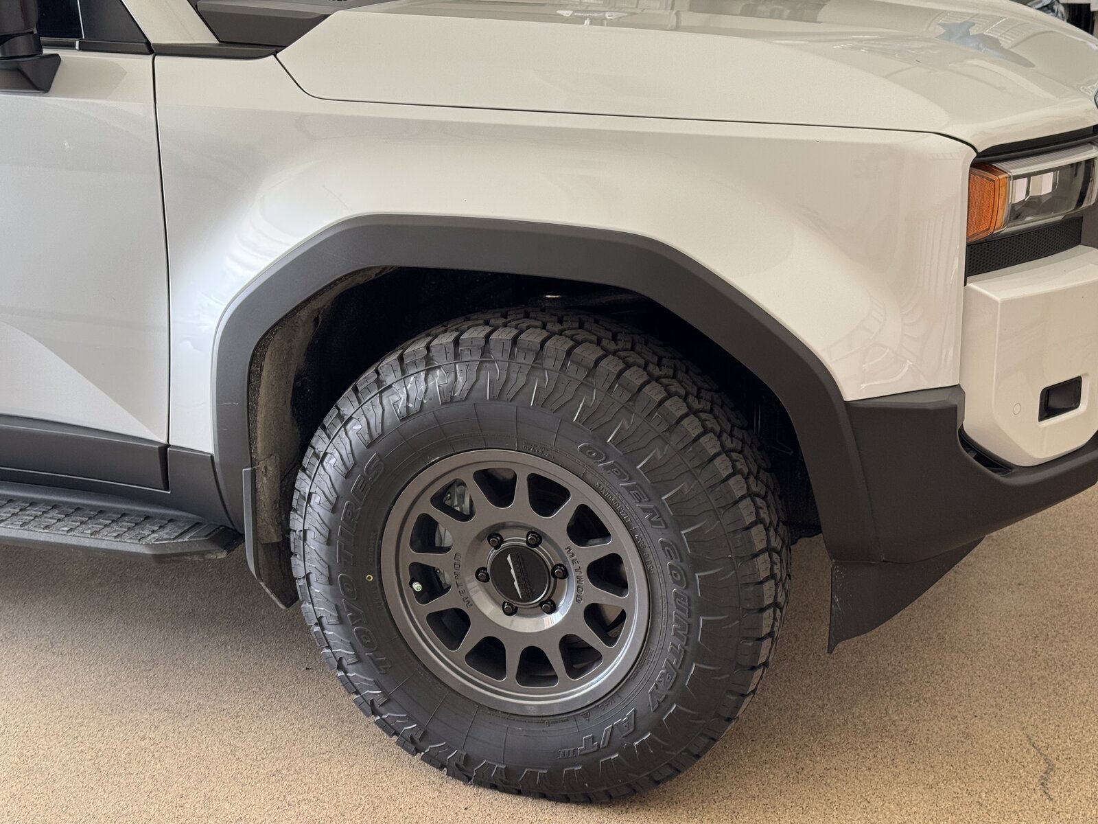

As noted above a 275 70r 17 is a 32.2 inch diameter tire. The 70r is the ratio of the sidewall to width. The smaller the rim the bigger the sidewall and changes the overall diameter(smaller).
On the 17 inch rims you can choose a 34 10.5 r17 Toyo AT3. It is a 33.6 inch diameter tire a “34” if you will. It comes in a D rating (8ply)which is super durable but not as harsh as the E and fits much better in the spare well and weighs 54.9 lbs. a few of us run them and they need no suspension modification at all as they are a hair thinner than the 275’s. Best blend of on and offroad IMO. I would put them on my rig again in a minute.
Im set on the Nomad 504’s with +35 offset so thank you for reassuring that I will be fine lol
Correct, the TH rims are a +20mm offset. Not a fan at all of a lot of poke out, and there's only mild with these rims. Also, with the front lift set at +2.50" and aligned I have no rubbing at all.

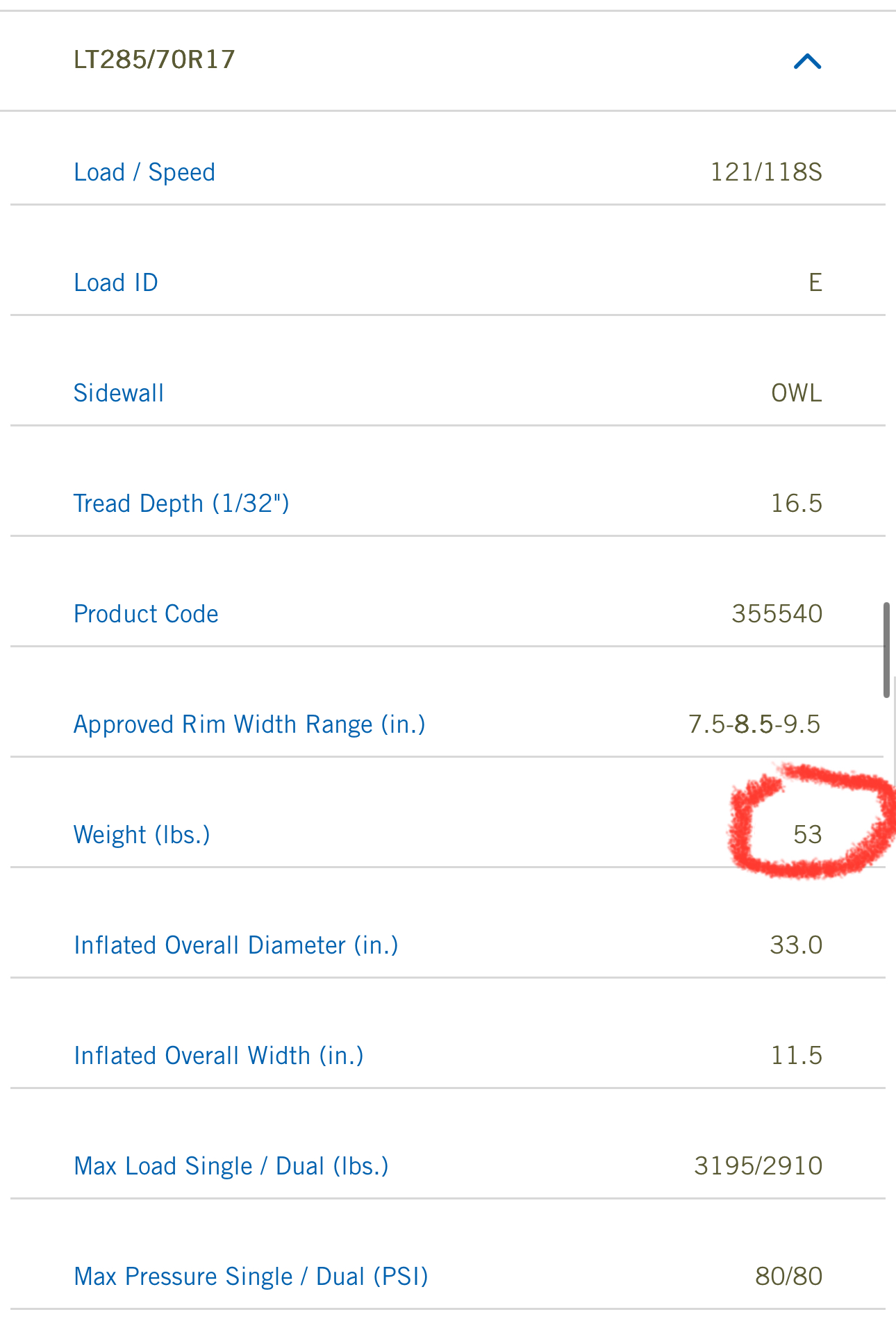

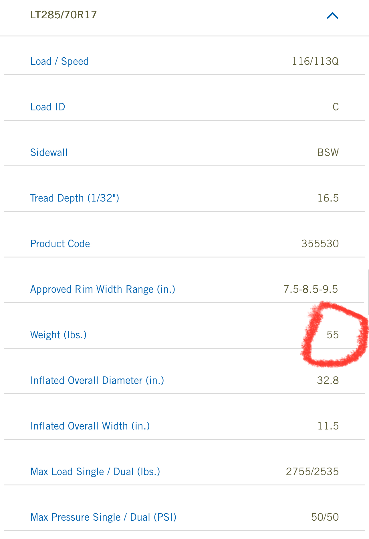

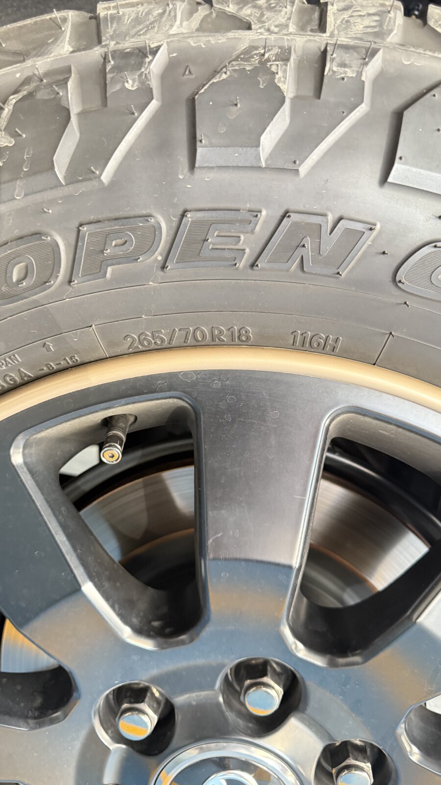

Sorry if this isn’t a good question but again, new to this.
For the 275/70/r18, I notice that the C rated is actually heavier than the E rated. Why is this? And what would the benefit be of getting the C rated over the E rated since the E rated are lighter?
