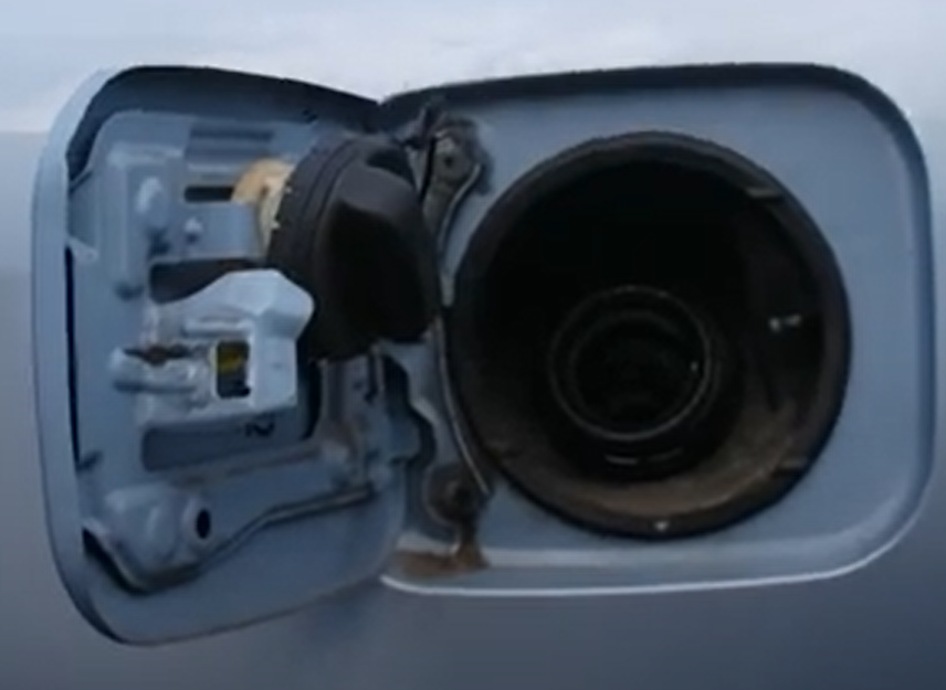

Has anyone found a solution to a fuel door that barely wants to stay open and closes with the slightest amount of lean or wind? Mine regularly closes as soon as it is opened and or/while the fuel is pumping.

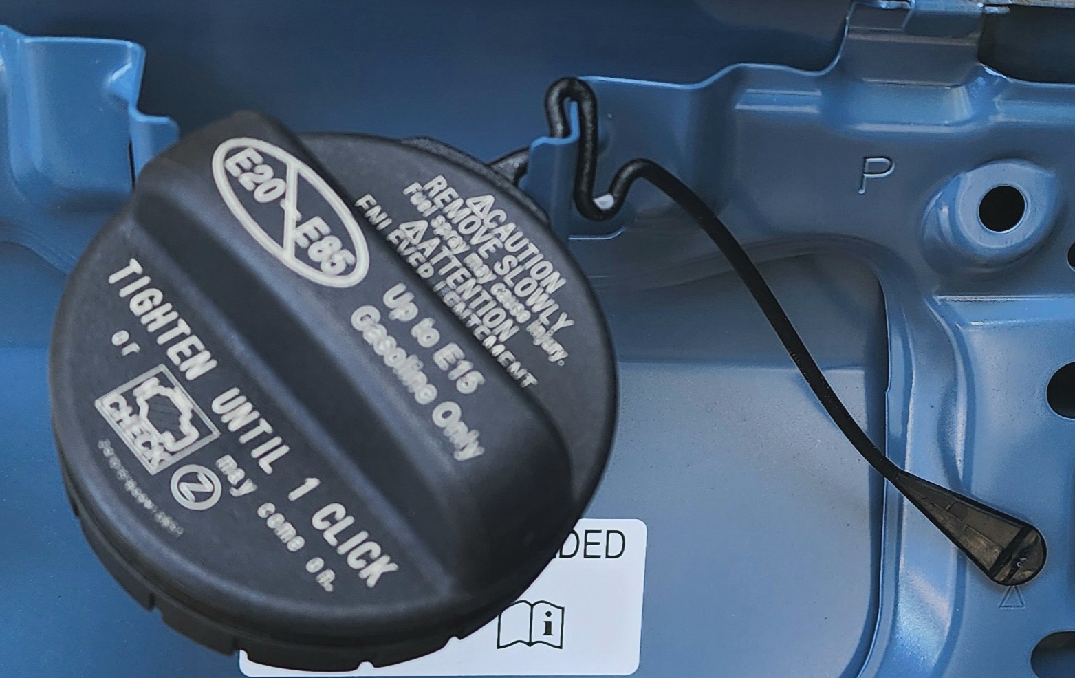

The cap hanging on the inside of the door seems to be working perfectly fine for me. There is definitely tension holding the door open - wind isn’t blowing mine closed.
Because of your post, I found it! The line was so tight I missed the little kink.
Still a little wobbly compared to the ones where you just hang it loosely over a hook.

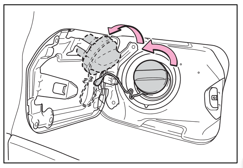

Wait, what? Why not not hang the cap like it was intended. View attachment 41855
Thanks, I made the mistake of Googling it which gave me a generic and inaccurate answer. I should have looked at the manual which shows you are correct. You have also demonstrated that this forum (at least for the time being) is better than AI :)

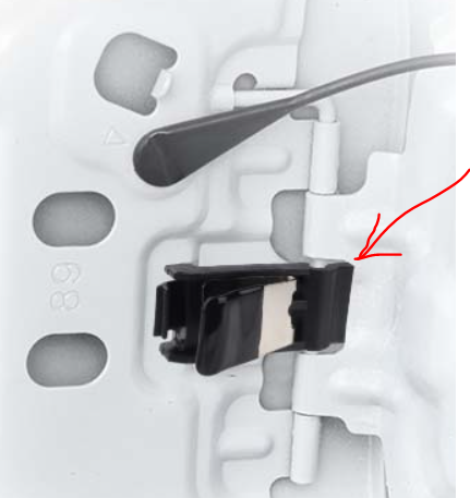

Can you pinch the little bracket that holds the hinge wire with a pair of pliers to create enough friction to keep it from swinging around?
