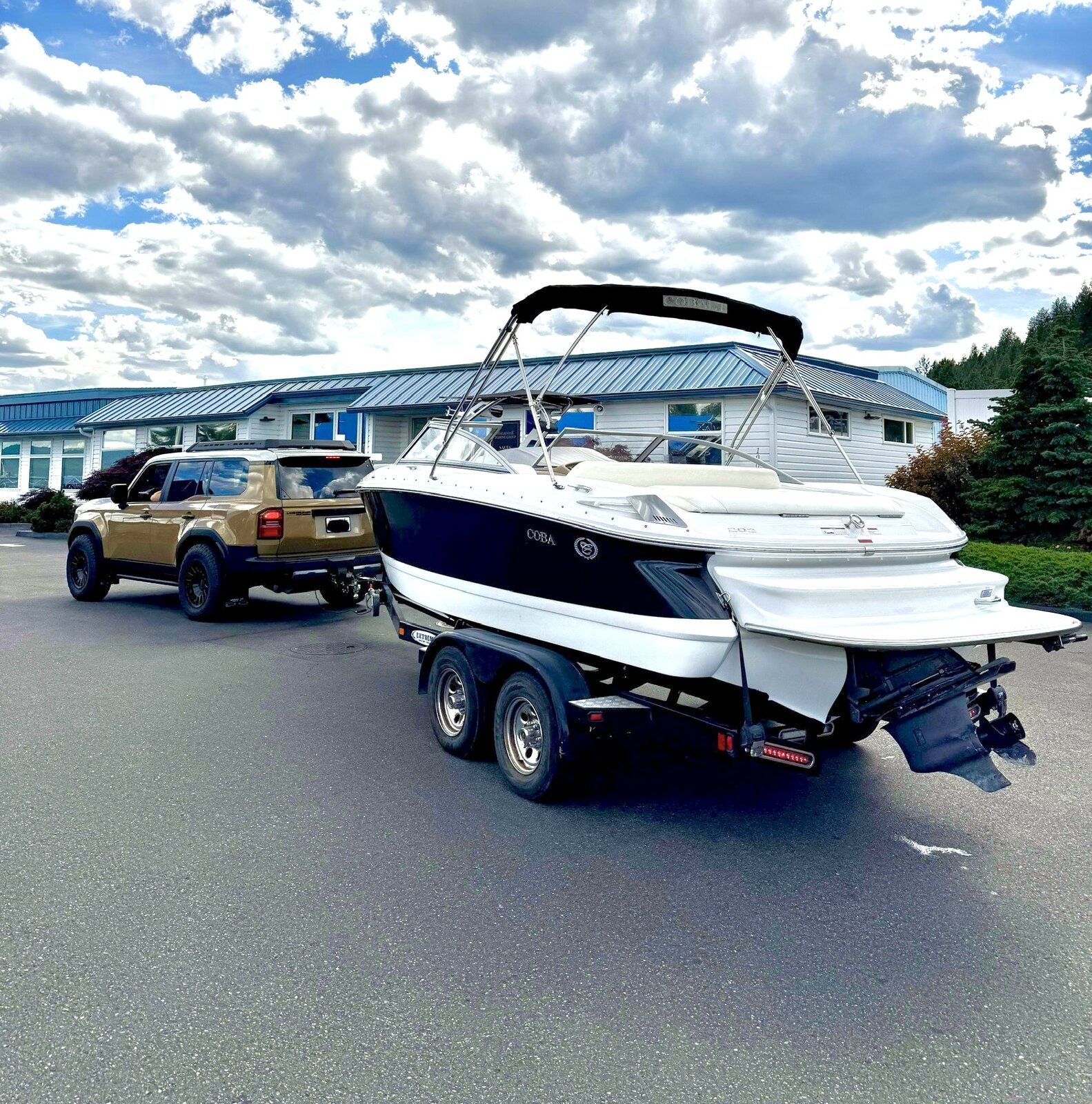

Ask those who have towed with it. I think it does a decent job towing. Not much different than my 1500 Ram pickup (with a hemi V8). I have towed several smaller trailers and my 4500lb boat. The boat it did fine with. I towed it 2 hours over some hills. Towing it back in the next month. Pic below.

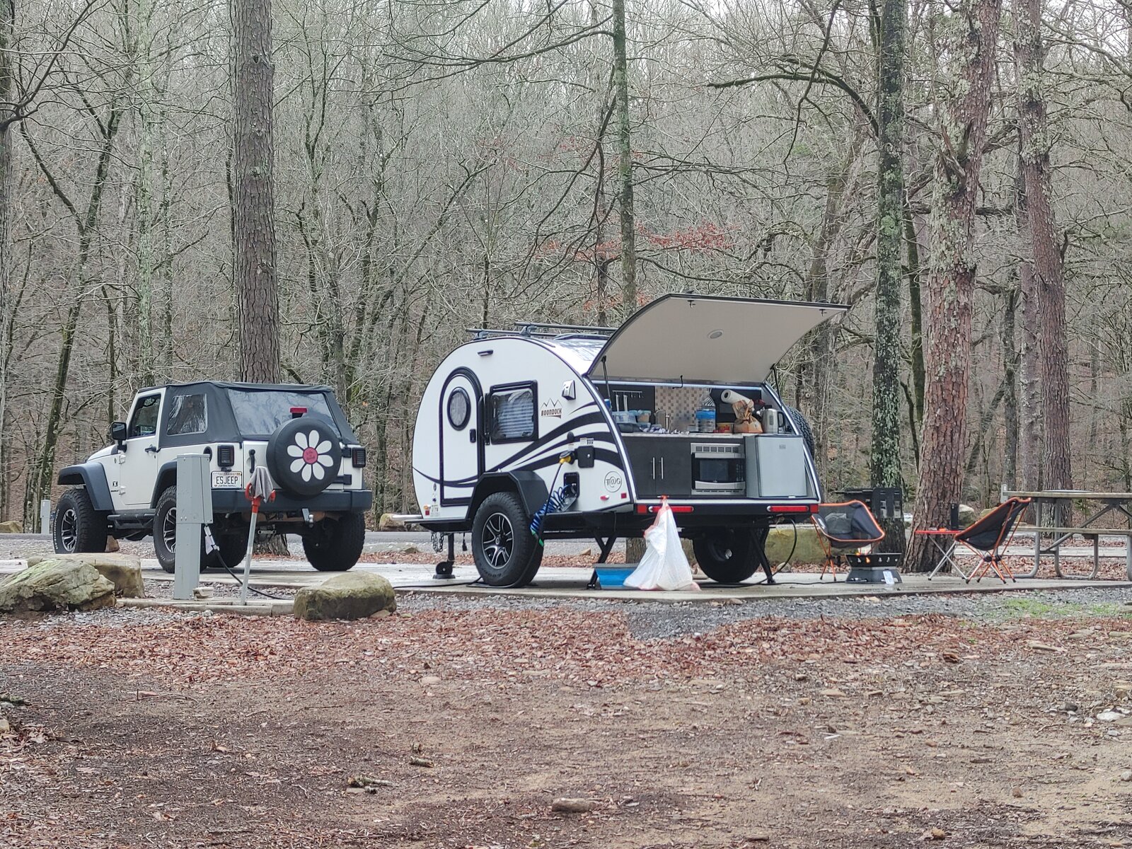

My Bean is 14 feet and about 2000 lbs. Pulling it up and over the Rockies was very nice compared to the Jeep Gladiator it replaced. The Jeep would whine and get very loud in 4th pulling the same trailer. This one just glided without any noticeable effort. Smaller trailer agreed, and that is perhaps the key.

My Bean is 14 feet and about 2000 lbs. Pulling it up and over the Rockies was very nice compared to the Jeep Gladiator it replaced. The Jeep would whine and get very loud in 4th pulling the same trailer. This one just glided without any noticeable effort. Smaller trailer agreed, and that is perhaps the key. View attachment 46072

The teardrop is great, very cozy once you get settled. A bit of hassle getting in an out (I am 69) but pulling it is a breeze, setting up and down quite quick and it does feel like you are camping; without having to worry about rain and animals.
Only downsides would be what to do on a rainy day (not that much of an issue) storage.

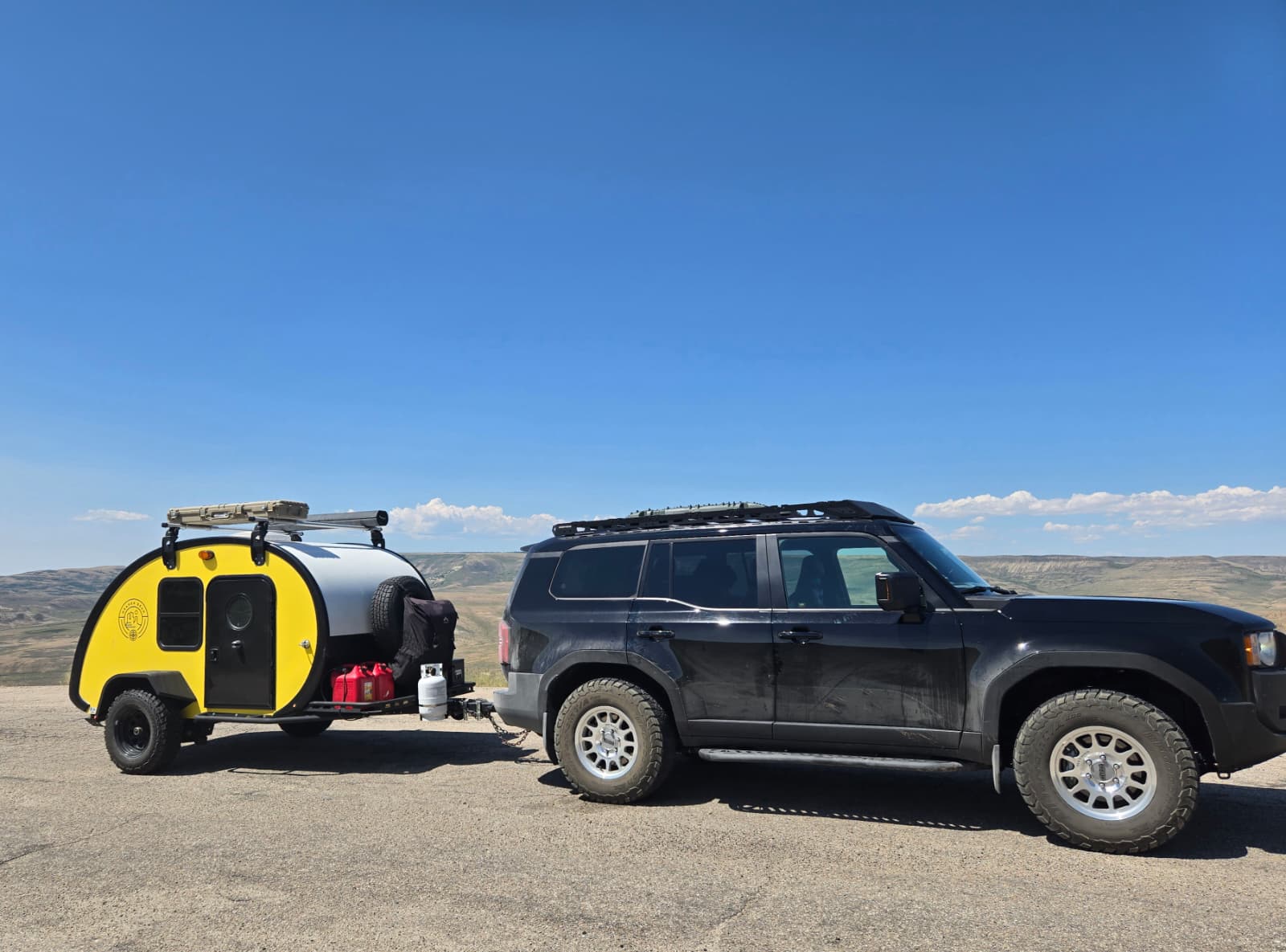

i have a 2018 Tacoma and it struggles with the teardrop trailer we own, an Intech Luna Rover, probably weighs ~ 2000lbs loaded for camping. The LC tows like the trailer isn't even there. zero struggles even up long grades through the mountains east of San Diego.
i could not be happier with the towing capabilities of this rig. That being said, the powertrain is slightly different for your region but lots of videos out there to help with your decision making

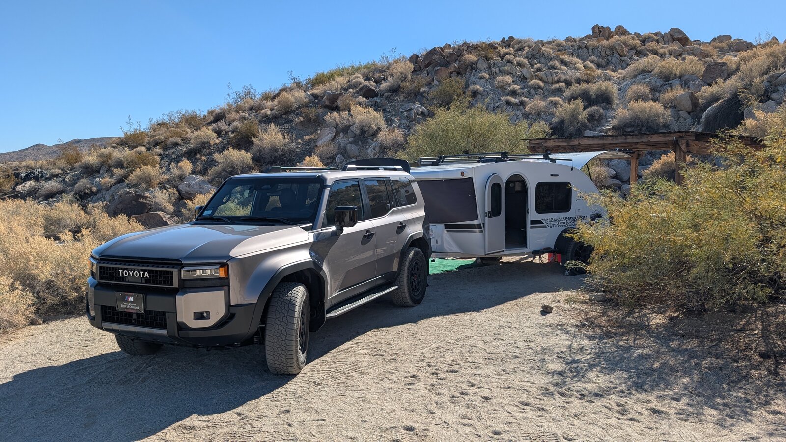

Dont have pic with landcruiser but these teardrops are awesome. Barely notice it's there over hills and (mild) offroad. One negative i have encountered with LC towing is the built in brake controller. At max gain setting it doesnt lock up tires on our trailer. The aftermarket controller in our jeep locks the tires at ~50% gain. Still need to investigate what's up. Likely operator error. Wish we had diesel options in USA!!
