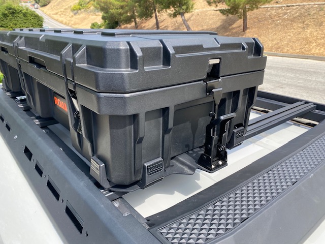

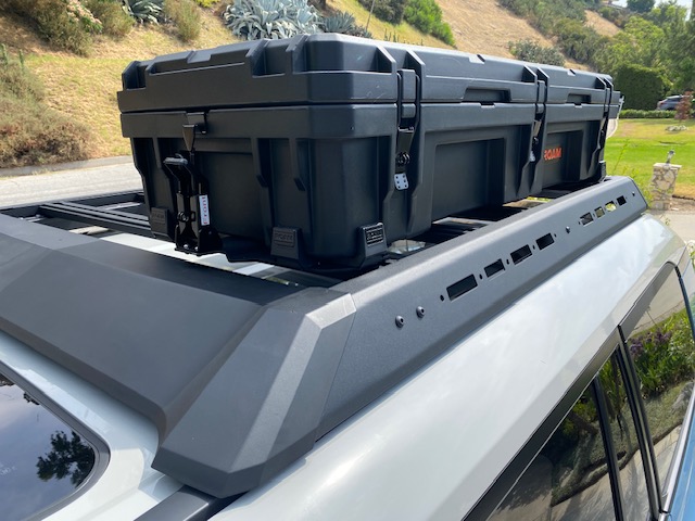

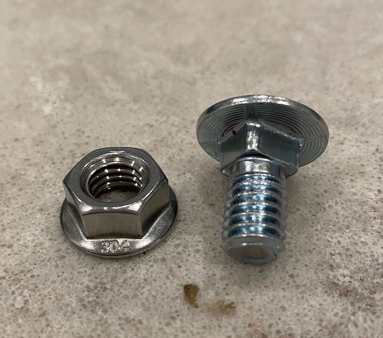

Thought I would share this in case it helps someone thinking of this product.
Installation of 95L Roam Rugged case on First Edition Roof Rack using the 95L Roam Rugged Mounts.
  • The First Edition Roof Rack needs 5/16" carriage bolts: the Roam carriage bolts are too small for the T rails.
    • Use 5/16" diameter by 3/4" long carriage bolts. If the bolt is too long, it will hit the bottom of the case.

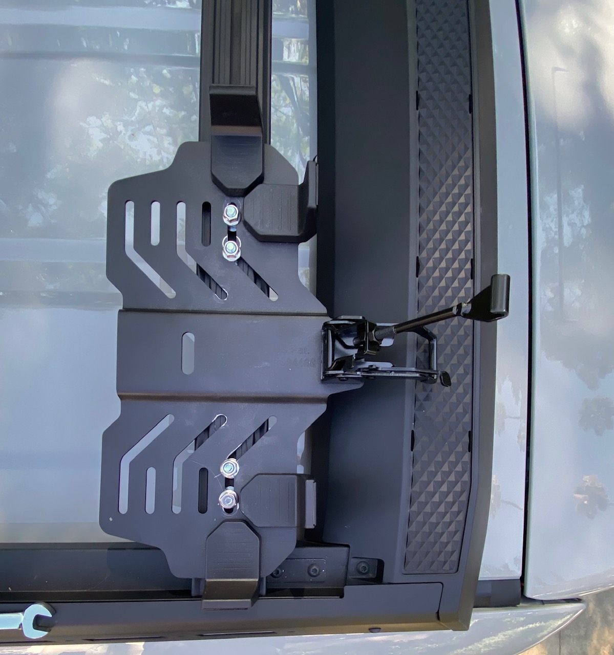

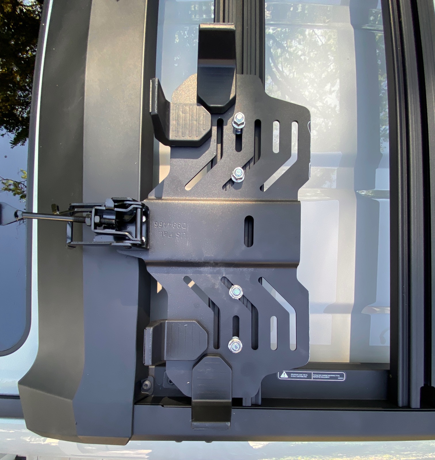

  • The Roam Rugged Mount slots are just under a mm too tight for the proper sized carriage bolt, but it is easy to widen slightly with a Dremel. Be sure to Dremel enough to let the bolt screws pass easily.
    • These pictures show where to widen to accommodate the bolts for the Front and Back Mounts.
Front
  • For the back, use a Torx wrench to move one of the cross bars to the back.
Very secure and lockable clamp mechanism at either end.

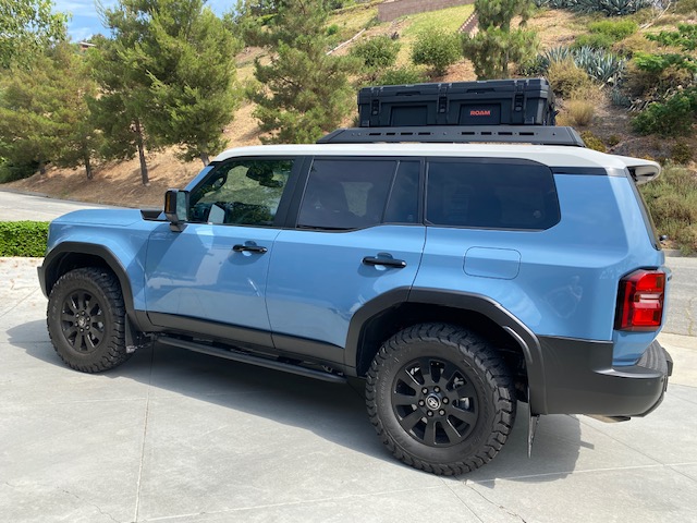

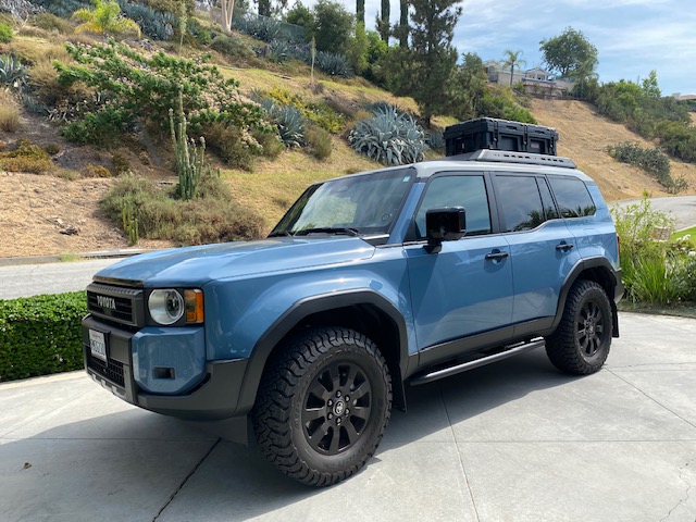

Tire specs and name please. Any rubbing when off-roading?
They are BF Goodrich KO3's: LT285/65/R18; Load Range E, 125/122S, M+S 3PMSF snow rated tires. No rubbing around town or with some light off-roading. I'll be testing them on more serious terrain this Sunday-Monday in the Mojave desert. I'll report back if they rub, but I doubt there will be any issues.
They look and feel great on the road!
This is great info I'm finally locked in with 285/65/R18 stock rims. Keep me posted please after your Movaje desert trip. I cant wait to go tire shopping :)

Curious as to why you like that size. Stock size is 32.602โ€ tall. That 285/65r18 is 32.586โ€ tall. Not challenging your decision. Just curious as to why. Seems like most of the evidence shows a skinnier tire is better off road in most situations and has less rolling resistance on pavement. And I would think a 285 might be heavier.

Finally, which rock sliders do you have? They look good. I have the RCI off road ones on the 4runner and the dealer only has the step ones which I don't like.

The rock sliders are the factory installed OEM equipment that comes standard with the First Edition model. They don't function as a step but are excellent off-roading protection.

Do you think you'd be able to get a second one of those cases up there and still be able to open at least one lid at a time? Based on the numbers it looks like it'd be tight but only if the lid is less than like 2.5 inches. If you get the chance can you measure the thickness of the lid?
Sorry for the delay in responding. I've been out of the country. I don't believe you could get two of the Roam 95 liters up there. I plan to put a small basket on the other side. The limited roof weight capacity is also an issue.
No worries. Thanks for the reply. Hopefully you're traveling for pleasure. Enjoy the trip.
Do You think the 83L box would fit? The pictures make it look like it might.
Thanks for the info
Yes, it would fit.
Just curious if you tried the fit of the 83L. I was looking at the 95L and now I am thinking the 83L would be better. However, the 83L has an additional 4 inches in length and it looks like you are already pinned at both ends with the cross-bars.
