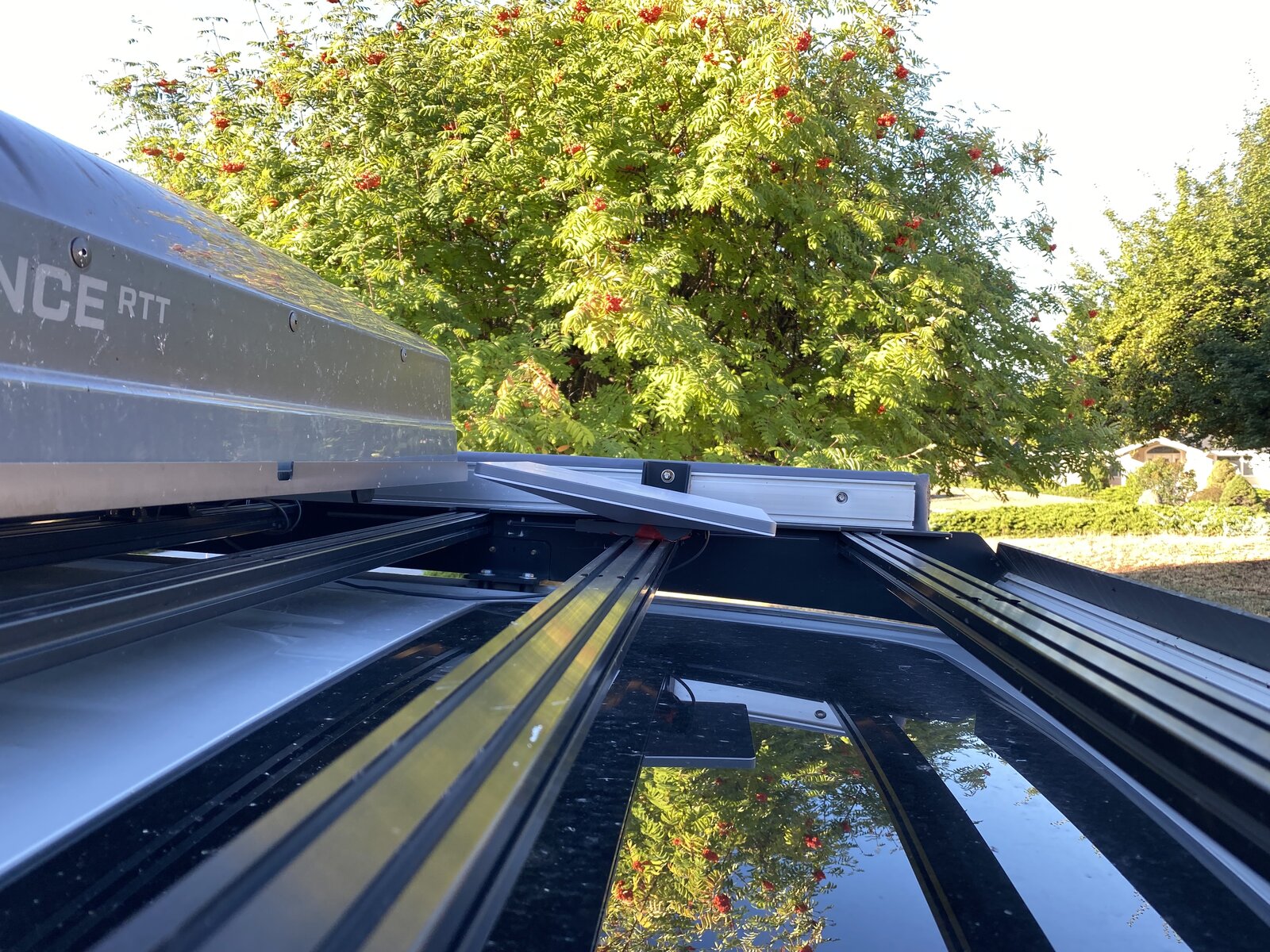

Interesting. Keep things cool then…. Not to hijack this thread but how is the star link-mini working out for you?
It’s working well. It uses more battery than the fridge - maybe double. The biggest problem though is that when you drive where there’s no reception you need to use wifi. So, wireless CarPlay won’t work there, so to setup wired CarPlay. Then everything works pretty good. Last year I used the gen2 actuated and it took a tonne of space - I didn’t roof mount the gen 2. I have it plugged into the Jackery battery for continuous operation.
I guess I'll hijack your hijack... I'm also running a starlink mini mounted almost exactly like the photo posted here. I've just been all the way up to James Bay road and the entire trans taiga road and have had multiple people in two vehicles using the starlink which is just been virtually perfect. The other vehicle is even enjoying wi-fi/internet while in convoy except when we had to spread out except when we had to spread out because of dust.
The thing also happily sits up there and keeps on working at 85 mph on the highway. Pouring rain hasn't been a problem.
Yes there are some interruptions when you go under or near trees or any other obstructions.
But even when you have partial obstructions you can still get out text and email and download stuff and whatever.
My buddy who I was camping with had an original dishy starlink in a Rubbermaid tub in his truck and he thought it was going to be great to set it up at camp when he wanted but he ended up never touching it because he was connected to mine virtually 24/7 during our trip.
