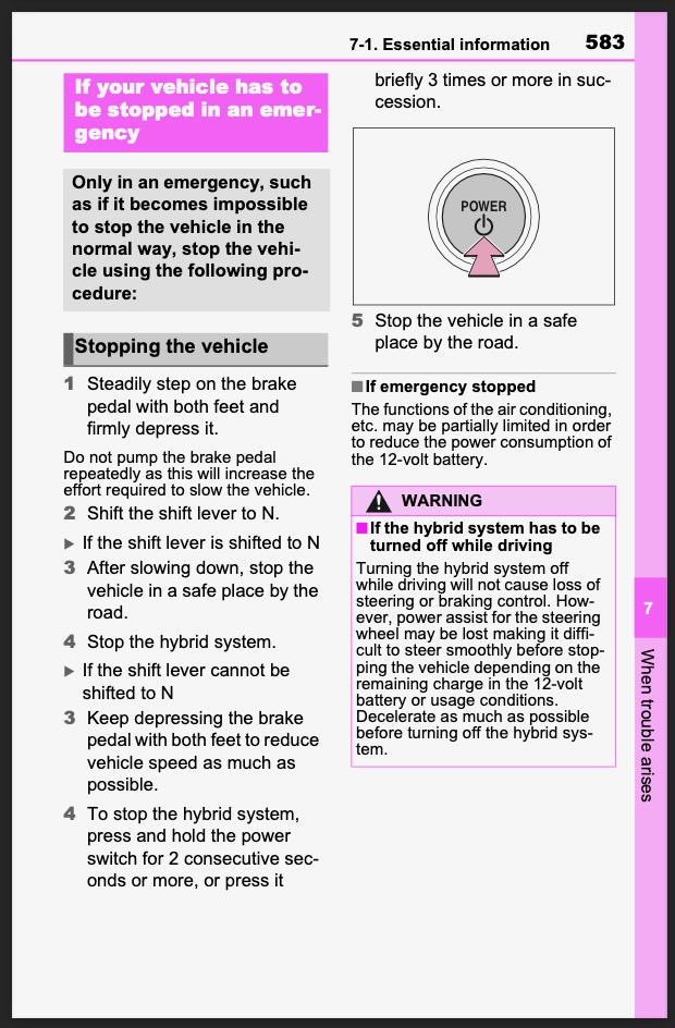

It appears that you can drive with the hybrid system off.

When Toyota references "the hybrid system", they are referring to the powertrain as a whole (the turbo 4-cylinder, battery, electric motor, etc.).
