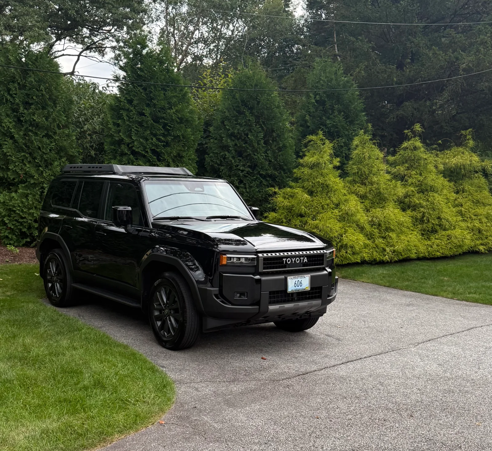

Not till I change the tires!! I have been staring at 275 specs night🤪
Ok, I guess this will be the before, it’s beautiful isn’t it 😉
