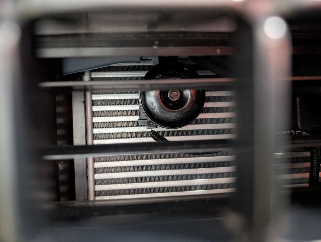

Next, confirmed that our horns are where just about every other horn on the planet is located, in front of the radiator.

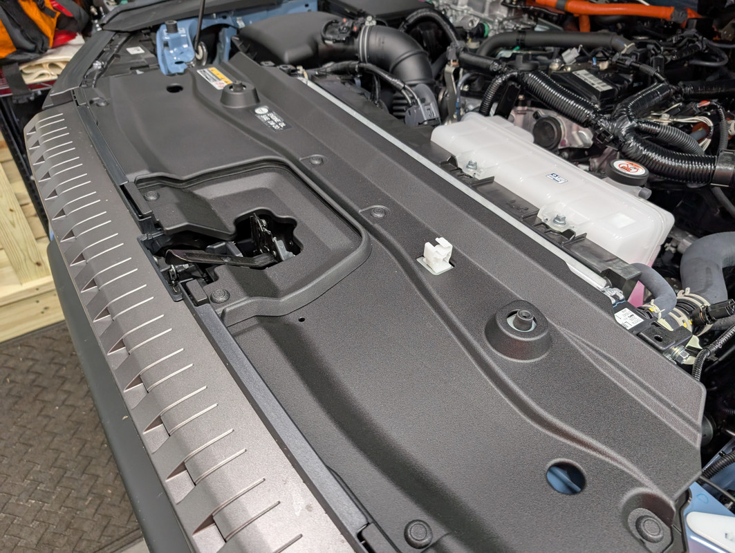

This plastic cover pops off by removing the 8 plastic rivets.

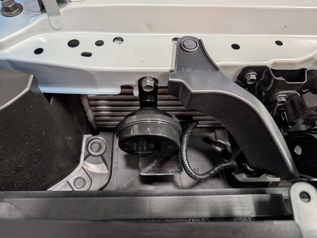

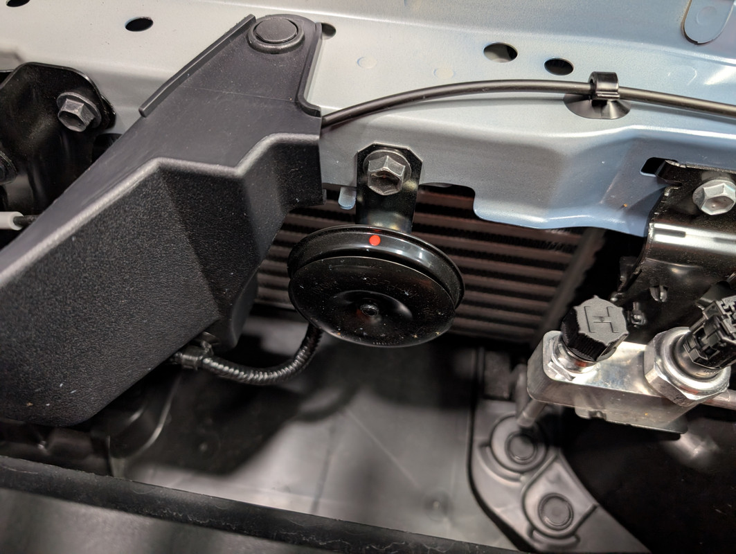

Thus exposing our horns, one on each side.
Remove the 12mm bolts, and unplug, reverse it for the new horn.

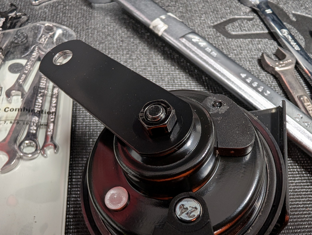

For the driver side (US) horn, the cable is a little short. What I did was pop out this cable tie to get more slack, and use a 10mm wrench to adjust the horn hangar a bit, worked perfectly.

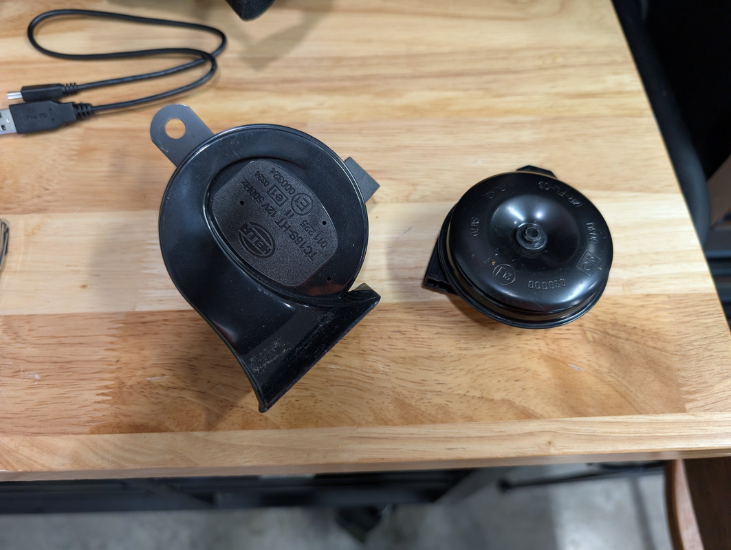

For comparison.
Voila! A truck sounding horn!

To remove the plastic fasteners....... just push the center down. It will disengage the rivet, then you can pull it out (no tools needed).
You know, I read that the first time you posted that and I forgot to try it that way.
I didn't know you could do it that way, but thanks cause I'll need to remember that for the next time. I've ruined a few of them in the past.

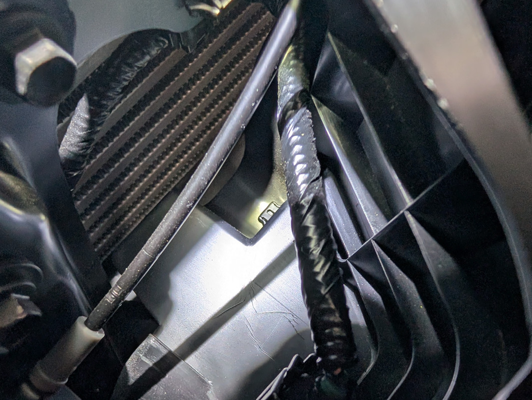

Question for you guys on the toyota premium horns… the metal hanger that bolts/screws into the metal part of the truck, they arent positioned the same as the factory horns (vertical). One premium horn bracket is sideways and the other is diagonal. I wasnt able to unscrew the brackets to adjust the them to be vertical …seems like thats not possible?
i had to install the right side at an angle and bend the hanger bracket back a bit so the trumpet housing didnt hit the black plastic that is around the hood release latch. Seems a little wonky but i think it works. Not sure if vibration over time will cause it to move or hit other parts of the frame.
If you have an impact drill, use a socket to knock it loose. I had the same issue and the impact drill loosened it right away. I have my horns point down.
I’ll try that. You used a socket bit on the hex bolt/washer, not the Philips screw part right?

It was to get them to fit properly. The way they shipped, one of them wouldn’t fit on the right side. Once pointed down, they fit. You can see them through the front grill so having them symmetrical was important to me as well.

  1. After you push in the center of the plastic rivets to release the cover (Justin's pic. #2), it becomes very loose in the hole. If you pull up the plastic shroud to remove fastener as I did, they may pop freely into the air and into the deep recesses of the front end. Be a little careful (ask me how I know!)
  2. The Hella horns are mirror images (not identical). If you use the 400HZ horn on the drivers side the horn itself will be on the other side of the mount from the hood latch cover, leaving more room there and eliminating the possibility of it rubbing against the cover (this will be the opposite of the direction in Justin's picture #7)
  3. By doing this you can get the horn facing down at about 5 o'clock without putting any stress on the electrical connection, assuming you popped out the wiring clip as JustinHEMI suggested (thanks for that idea)
