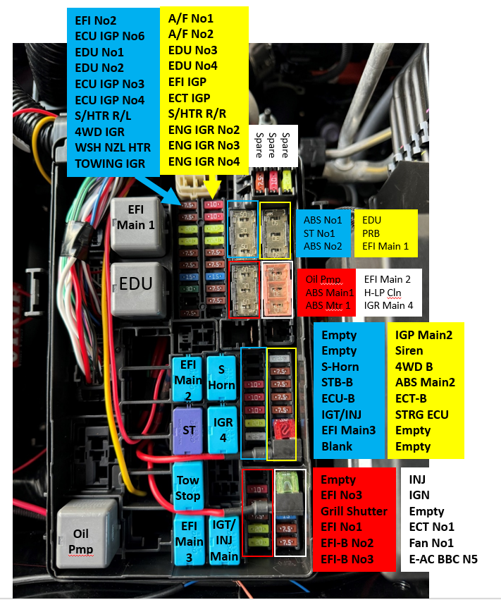

Not sure I can answer your questions. The link below includes a video that shows which fuse to connect to. The fuse had a red cover with'10' on it. I pulled the tab and inserted the connection from the lights
It appears that fuse is the "A/F No.2" which is controlled by the "EFI Main No. 3 Relay" (page 2 of the PDF). If you move the fuse tap to the "Empty" slot (lower R/H corner of the picture) Where I have my fuse tap (yellow fuse, not the red fused tap) located, it's an ACCY section of the fuse box. I have an accy buss connected to my tap and it powers off when the ignition is off. Be advised if you put a tap into an empty slot, you still need two fuses in the tap.
