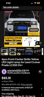

These are the ones? They don't quite look the same.
Yes, but look you can pick multi colour or Amber, I have amber.
ITrims Front Grille Marker Lights... https://www.amazon.com/dp/B0DNZ77CHH?tag=landcruiserforum-20
They have an upper and lower option but I have a bumper installed so I just went with the uppers. Only had em in for a couple days now but so far so good

https://www.amazon.com/dp/B08C9HNL5D?tag=landcruiserforum-20 For under hood
and below for the grille lights. I offered $60 shipped on these and they took it.
They will hook straight into headlights if you want. They have a plug for that and the wiring harness and all are actually very well made.
