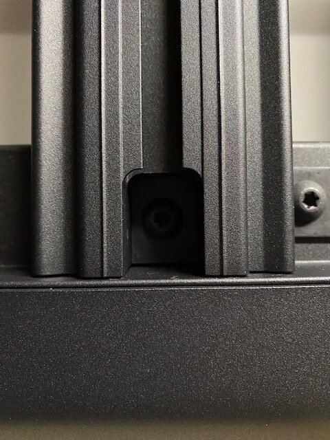

Looks like you have an office in Los Angeles. Want me to bring mine over?
The cross bars are fixed (4 fixed bars) and slotted. See attached pictures.

Looks like you have a office in Los Angeles. Want me to bring mine over?
Any insight as to how the tent would mount to the rails? Do they move or come out? I just sent you a DM with the contact information for the rep.
Slotted rails at fixed intervals.
Thank you very much!!
Do you know if the cross rails are removable via the arrowed bolts? For example, could you mount the cross rails on the tent and then bolt them back to the roof rails in the arrowed locations?
Just trying to get a better understanding of the rack system - thanks for all your help! (Living vicariously through your pics until the QC lifts..)
