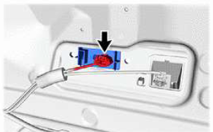

I got curious as I didn't know exactly how the manual unlock worked.......... took off the access panel, turned the screw and the little white arm dropped down.......... then what? The owner's manual wasn't clear (to me anyways). I took off the entire trim panel to figure it out.
Once the white arm drops, you will see a silver tab/arm, push the tab to the right. It would be fairly easy to make a tab extension with a piece tubing squished flat on one end (not completely closed, but just enough for a tight slip over the tab) When camping, you could install the extension and when not needed easily removable.
Wow! You are incredibly helpful. Thank you!!

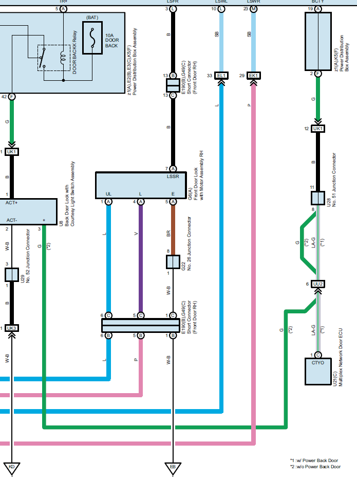

So the doors are unlocked and you press the open button on the rear hatch...... that button is an electrical switch?
If it is an electrical switch, adding a sister switch would be very easy.
If not, you could probably just leave the white cover thing or remove the white cover thing. I'm thinking a piece of 3/8 dia of brake tubing (flattened on one end and cut to a 2"-3" length would work. You can buy brake tubing at any parts store.

By simple I mean, splicing into the trigger wires for the door lock (one will be hot at all times the other leads to the lock), adding lengths of wire (to where ever you want the switch to be mounted) connecting those wires to the switch.
I may see what's required to add a sister switch. The goal would be to tap into the wires inside the cargo area vs the hatch. Tapping into the hatch would require longer wires fished up and through the hatch-to-body grommet etc......... I have an electronic tracer and may be able to locate the wires, hopefully in the battery side panel, which is easily accessible and be a good location to mount a protected sister switch.
