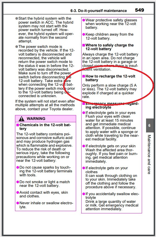

Note that the LC owner's manual specifically states that you should not use a charger that puts out more than 5 amps (if I recall correctly, it says that higher amps may cause your battery to explode!!!!!!) 💀
I thought that I had read that! I should probably revisit that seciton of the owners manual.
Reactions: SJR
Oh, lovely... and here I got the 10A because it was supposed to be faster. The Noco Genius is supposed to be 'smart" though. I regret tossing the box now. 🤣 I swapped the OEM AGM H6 for a H8 in my pick up.
