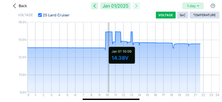

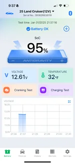

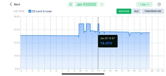

Have you considered changing to a Lithium direct fit Automotive Battery? I will be installing an Antigravity 60ah lithium battery in mine shortly as it would be the equivalent to having a 120ah agm battery installed. The LC has a solid charging profile that should be perfect for this application from what I have seen so far.

For full transparency I have been using/selling their batteries since 2014.
I have their lithium batteries in my Subaru BRZ’s, my Motorcycles and two in my FJ Cruiser a 60ah group 27r for starting with a RedArc BCDC charging a 120ah deepcycle house battery.
I used their battery tracker to watch and log the charging profile of my 2025 LandCruiser.
