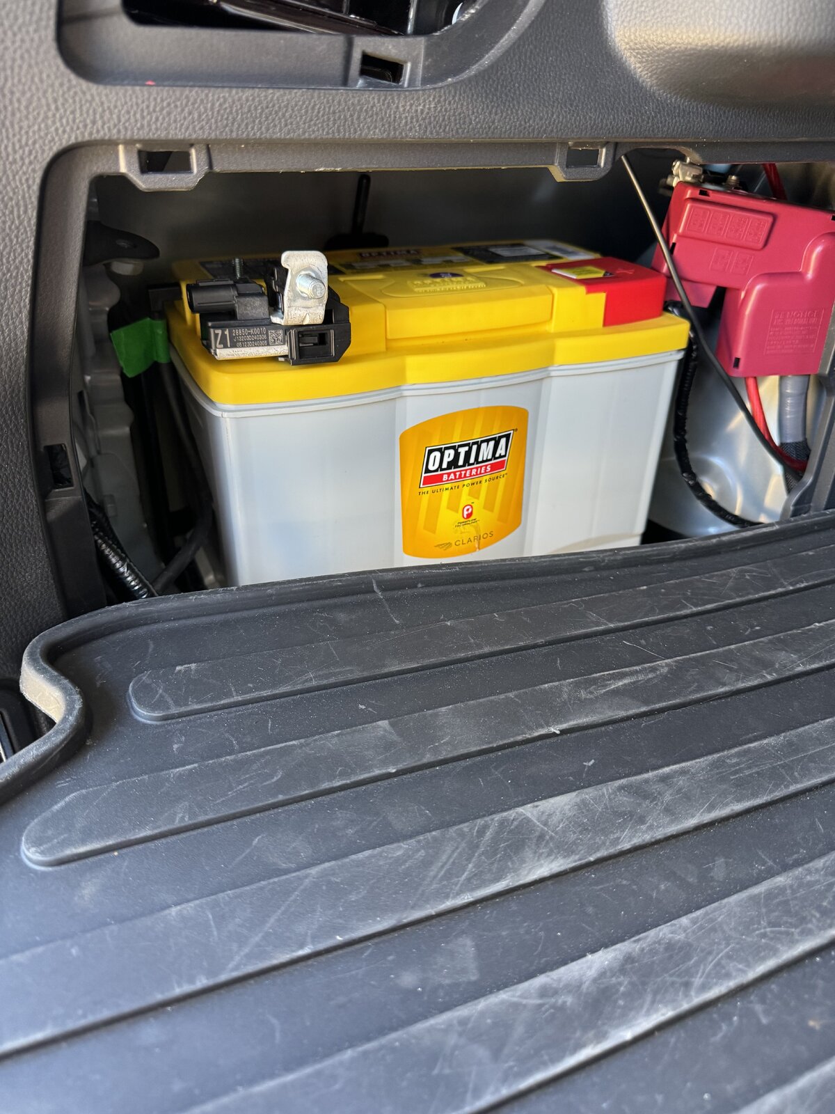

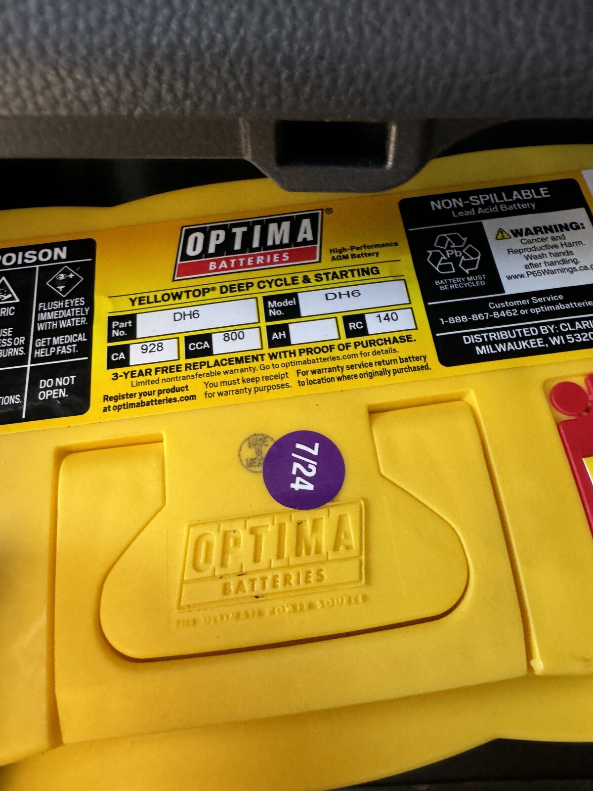

This is the Optima I purchased.....

AGMs IMO, aren't as prone to harsh ride vibrations etc........ The Optima has a higher CCA (Cold Cranking Amps) and I haven't had a failure with an AGM
Do these special types last longer than our traditional lead plate technology? Tell me more about them. Very interested.
Let me know the type number model etc for the LC as OPTIMA says they don't make one for our LC.
