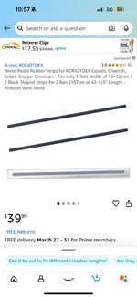

Very interesting. I don't like the noise of the crossbars. I have been contemplating taking them off when we are not using them (which is prolly 50 weeks a year). This is interesting solution. Do you hear any noise with the rubber? What is the link for the rubber piece on Amazon (or at least the search words?). Thanks.
This should work. You can place it on top of the existing rubber
