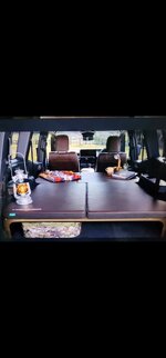

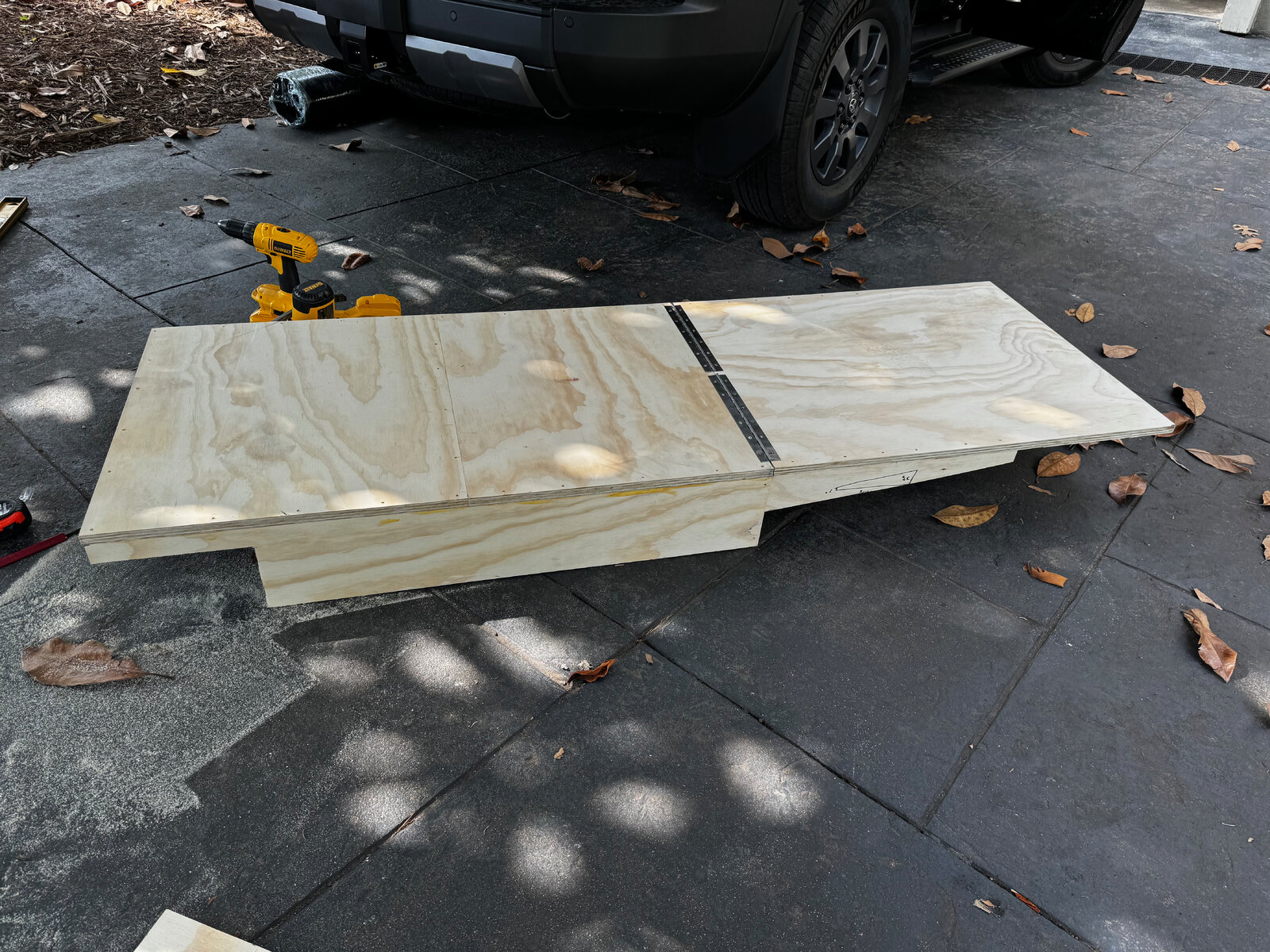

Platform built today. I plan on adding some mounting points to secure it, but its hefty enough that I don't expect it move around.
That turned out pretty slick! I assume the hinge is for folding and being able to store in the back.
Yes, it folds so I can stow it in the back and raise the second row. I have a 4.5 inch inflatable foam mattress that I'll place on top. Its 26 x 80 so should fit perfectly on the 78 x 26 platform.

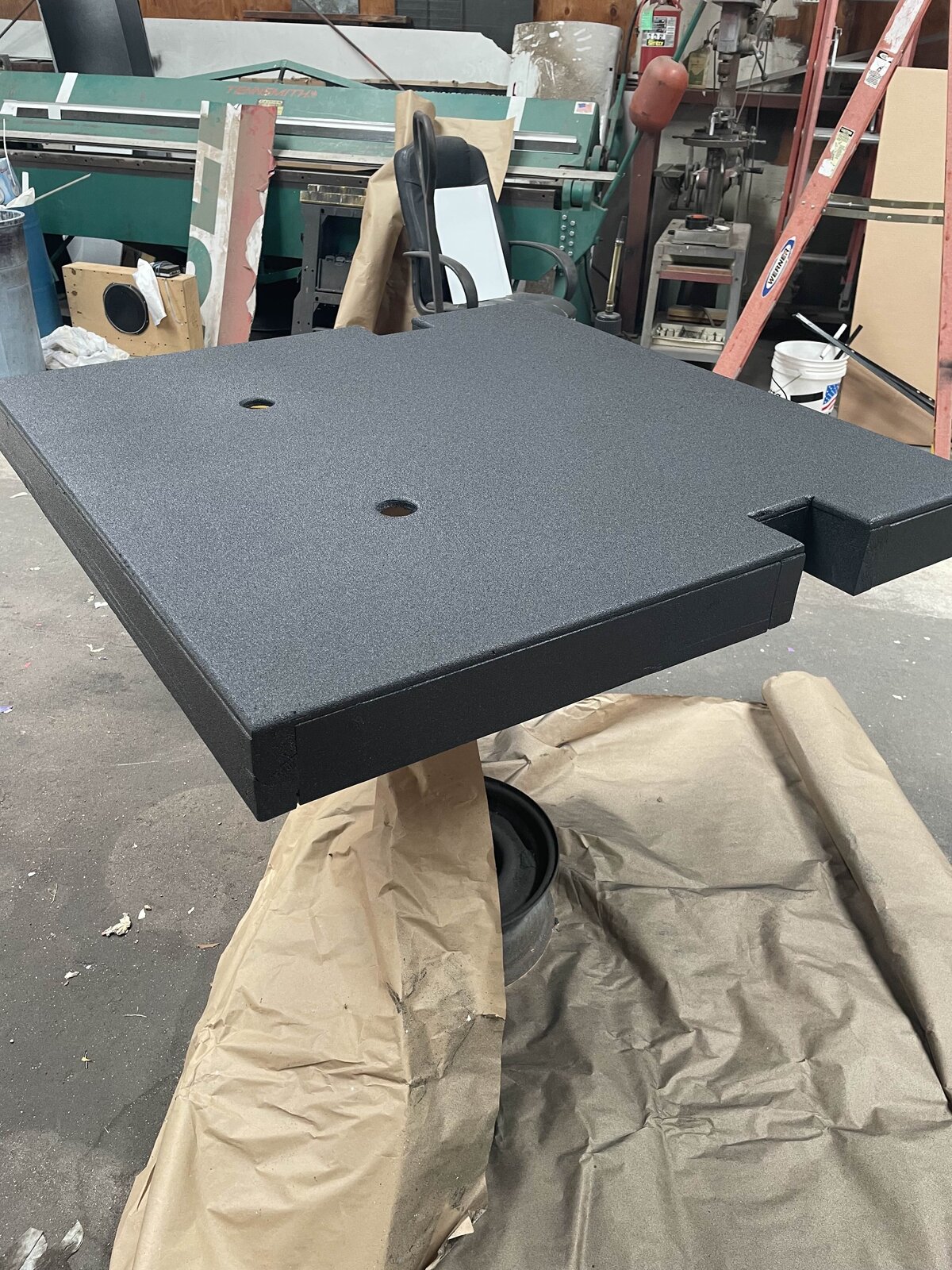

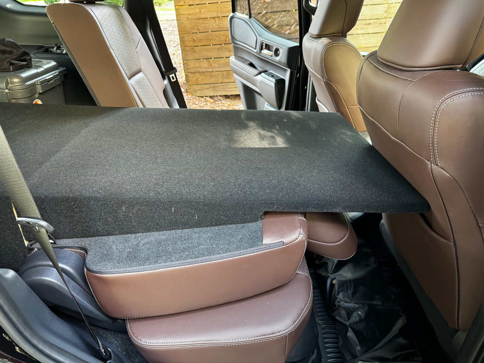

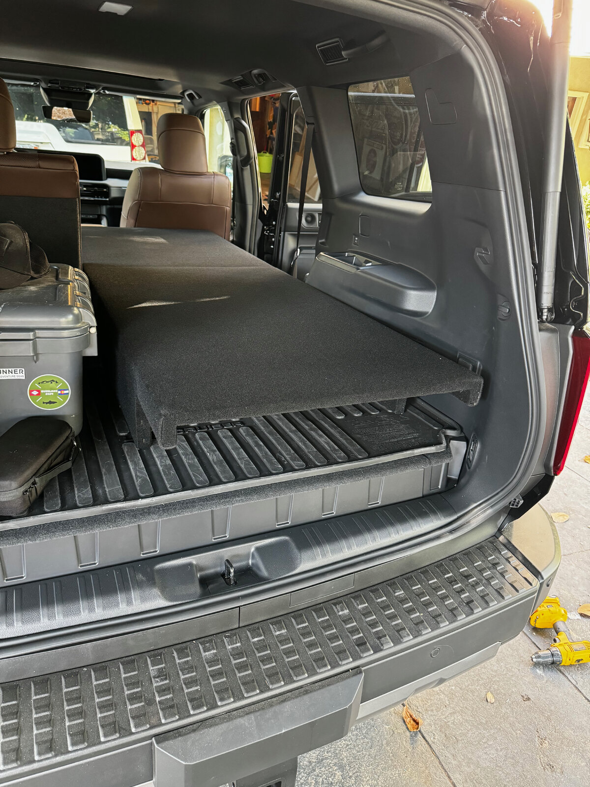

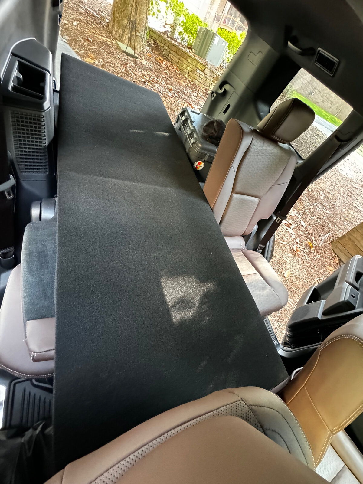

@shinkle23 Here are my rudimentary plans, and you can do it all with one sheet of 4x8 sanded 3/4 " plywood. I had Home Depot make the main cuts for me at the store, then the others at home. Squared up and butted the edges together, glued the edges and used countersunk screws. Purchased 13 feet of exterior black carpet off the roll at Home Depot and stapled it down. Later added a cut-out at the feet to allow access to the rear storage cubby. I was planning on using a bungee of sort to secure the head to the child seat anchor points on the back of the folded seat, and a turn-buckle to secure the body section to the front cargo tie-down, but its heavy enough that I'm not sure I need all that. I might just strap a bungee across the top during travel/ off-roading and undo it when sleeping.
I used a couple 12" hinges to allow the upper section to fold back (can't fold it while in the vehicle) and store in back of the rear seats to allow raising them up and stowing the platform away. I'll be storing it in my garage storage area and pull it out for camping trips. Foam/air mattress and my own bedding or sleeping bag and I should be pretty comfortable .
Anxious to see what a "real" craftsman can do! This is basic, cheap and all I really need.

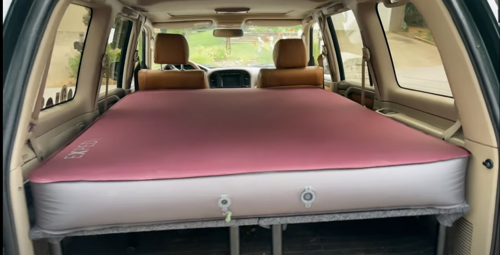

I for one find it comfortable to lay with the seats folded and my torso on the seat backs. I saw a YouTuber (Chloe) take a LC Toyota gave her to an off-road event and she just put an air mattress back there and found it very comfortable with the incline. I haven’t spent the night yet, once it cools down I plan to in testing for a road trip this fall. I’ve seen on the forum people build platforms, you could do single or double if you want it flat, but yeah you’re taking away storage and have a big hunk of wood to store and haul around then.
I bought the same pad, very comfortable. As someone else already pointed out, I put a small blanket in between to fill the gap between the back seats and the floor. My wife doesn't need one as she's shorter. We enjoy the experience.

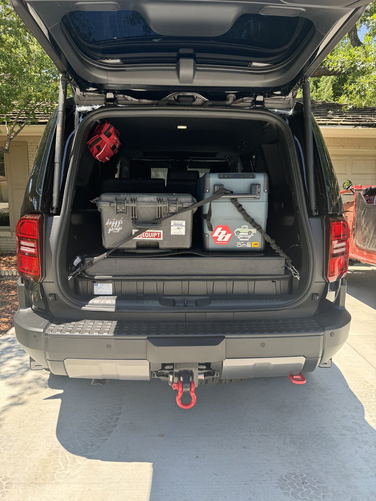

I constructed a 4-inch platform for the back, which levels the floor when the seats are folded down. An Exped Duo mat fits nicely in this space, providing a comfortable sleeping area. The platform is made from 1/2-inch plywood and 2x4s, coated with bedliner for durability. Future plans include rebuilding it with removable panels to store gear underneath.

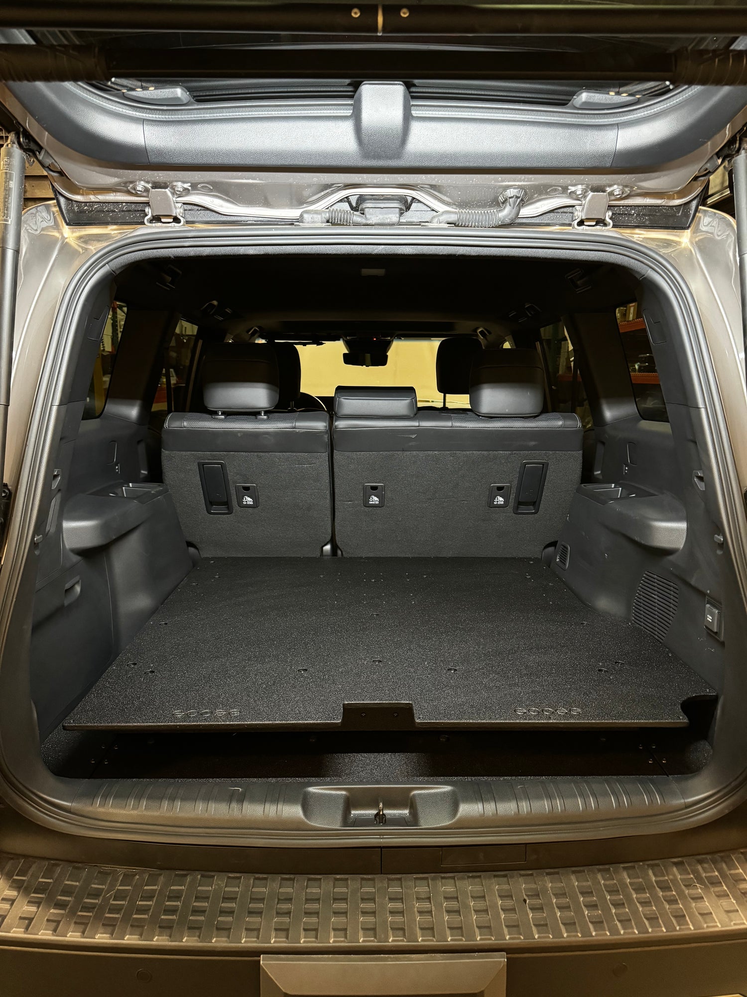

Goose gear already makes a nifty platform that still lets you access storage around battery and have the drawers, it's a good start.
IMG_4682.heic
Seems like you can also get 8" tall drawers that can probably extend over seats to make a nice bed platform, seats height when folded from battery level around 6":

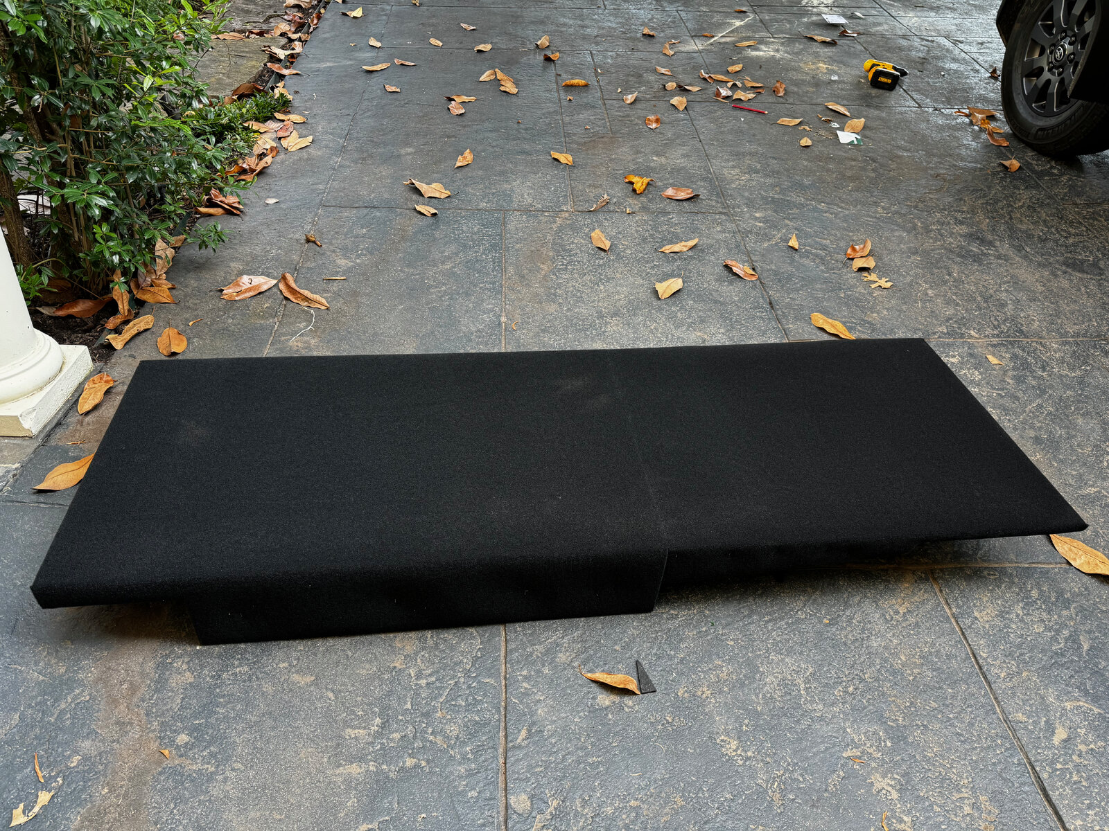

Here is the platform that I built using DctrEvil's plans (Thanks for posting). I modified the dimensions and added a second piano hinge to make it easier to deploy (lay flat for sleeping). Also, just added a simple brace that keeps it level. Looking forward to having a vehicle that will allow me to explore the mountains nearby.
