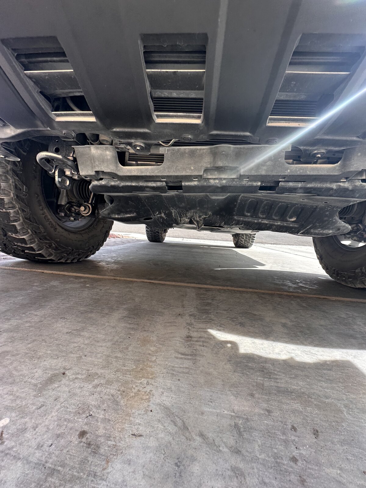

I dont know how robust those FE skids are, but looking at the Skids on my LE Premium, there was no way I was going to keep them. I also like not having to drop skids when I change oil. Here are the transmission skids side by side.

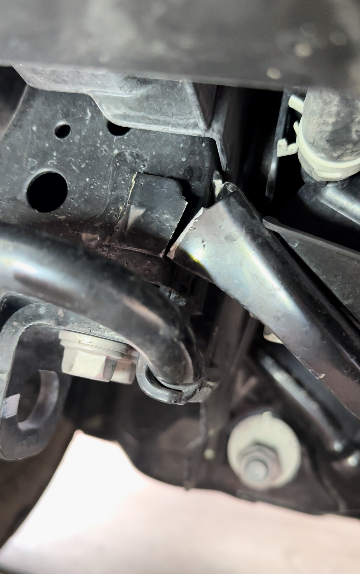

I may have found a weak point in the lc250. Ended up hitting a rock over the weekend with my OEM skid plate and it dented in. As I went to remove it so I could hammer the dents out I realized the welds on my radiator support bracket were broken on the passenger side. Im guessing as the skid plate dented inwards, It pulled on the top 2 bolts that are attached to the tiny radiator support and cracked the welds. After examining the support I realize there is no reinforcement. Other Toyota I've own in the pass have cross bars or a thicker radiator bracket. this one is a tiny support that is not fully boxed in and only attached by some welds. It looks like an easy fix but maybe the aftermarket support will have better anchor point.
was going cruising speed about 15-20 mph/ no other damage aside form these cracks.

I went ahead and used the steel RCI skids paired with their 24+ tacoma mounting crossmember. I had to chop off the broken radiator support to make it work. I will be swapping the front skid to the C4 one which utilizes the recovery points to secure it. as it pairs with their low pro front bumper that I will also be installing. No further issues. the skids hold up nicely while being banged up.
I’m in a similar predicament. Didn’t bust my welds but bent the crossmember enough it’ll be in the way of installing any new skids. Did the RCI Tacoma brace fit without modification other than cutting off the OEM crossmember?
Thanks!
Hey, Although its a pretty close match its not a perfect fit. you will have to widen the holes on the RCI tacoma brace for it to line up to the recovery point holes on the LC. It's not off by much but def not an exact match. I have YouTube video of the what I did and install also under same YOADRIANTRD . hope this helps.
Thanks, I was leaning towards the Victory 4x4 skid plate but I couldn’t be 100% sure it would fit around the RCI Tacoma brace, so ended ordering the same thing you did. Just gonna buzz the bent beam off do it how you did. Thanks! I actually saw your video on YT before coming across this thread. Was definitely helpful!
