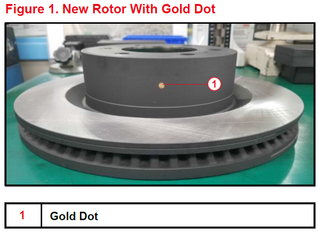

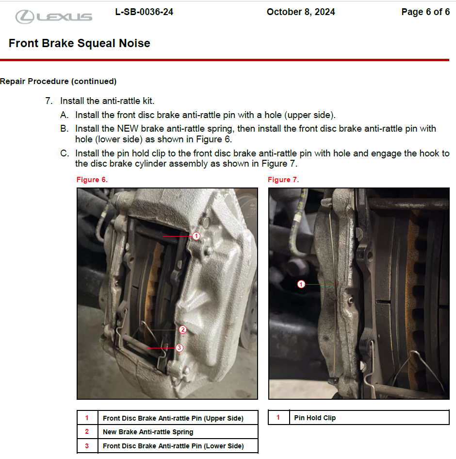

(edit) LEXUS TSB adds a 2nd spring and new rotors (probably harder material) and pads.
The following is a break down from the LEXUS TSB. They specify rotors with a "Gold" dot.
Disc Front, 43512-0C040 - $86.39
Pad Kit Disc Brake, 04465-34040 - $109.32
Shim Kit Anti Squeal, 04945-0C060 - $32.96
Disc Brake Anti-Rattle Clip Set, 04947-60140 - $7.25
Brake Caliper Grease, 08887-80609 - $25.38
