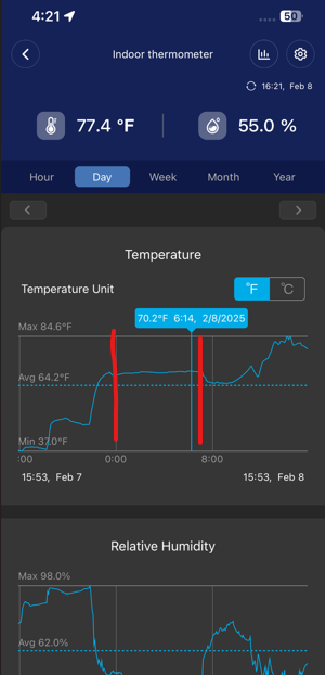

I just want air to blow in my face that isn't 40 or 120 degrees. Auto doesn't do that. It will direct air to the footwell vents when cold out and blow softly but still very hot. By the way, I went car camping in broken bow this past weekend. Had my Bluetooth thermostat record temps in the car while I slept. I set auto (100% everything auto) to 60 degrees. Between those red lines is when that setting was on. It kept the inside of the car almost exactly at 70 degrees the entire night. so no I don't think even auto sets the right temp. Thermometer was sitting in the trunk cupholder the whole night.
So, you left the truck on, and the engine just cycled on and off all night?
