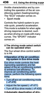

The 250 will definitely regulate AC to help with gas mileage. There's an AC Eco mode that can be manually enabled or is automatically enabled when you put the drive mode in ECO. It also automatically disables the back vents if it doesn't detect any rear passengers when you start the car up.
