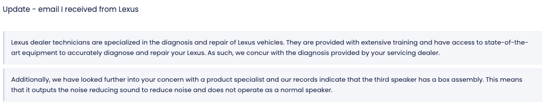

Can anyone confirm if the rear hatch has a sub or are we looking at the "speaker" that is part of the ANC system? The rear hatch on the GX550 has a ANC speaker that people thought were dummy speakers.
Part of the system
  • Act Noise Control Sys (for 6 Speakers)_ PARTS LOCATION.pdf
  • Act Noise Control Sys (except 6 Speakers)_ PARTS LOCATION.pdf
Pretty sure it's part of the noise cancellation crap.
Makes sense why the system sounds anemic to people with it trying to flatten out the curves and eliminate frequencies it thinks are noise. Great for driving around without the stereo on but neuters the stereo.
Sounds like the best solution is sound deadening and defeating ANC. Like all first model year vehicles, probably best to be patient and wait for the market to bring us solutions before I screw something up in mine when it arrives 😂
What if the weird noises everyone's been hearing aren't real and are being generated by the system to get you to bring it in so the dealership can rack up some warranty work........... Stranger things have happened......LOL
I think the illustrations from EOD Guy just show that it uses all the woofers from the stereo to generate the ANC sound, not that they are exclusively for ANC.
I suspect the "6 speaker" is for 1958 and the "except 6 speaker" is LC/FE
