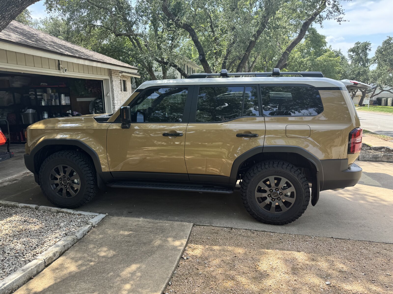

But since you asked so nicely, here's my stock size A/T4W SL on OEM 18" wheels.
I think you'll find a a treasure trove of information in this active thread - Tire Upgrade ?
I looked into that thread and found a few posts about it
But there’s 30+ pages of everything
Becomes hard to find some specifics as OEM size on OEM wheels
That said this looks so much better than the OEM tires, and also looks bigger as well.
Thanks for the share.
It definitely looks a lot beefier. It is supposed to be the same size, and I never actually measured, but I agree, they do feel a bit bigger, but that might just an illusion because of their stance.

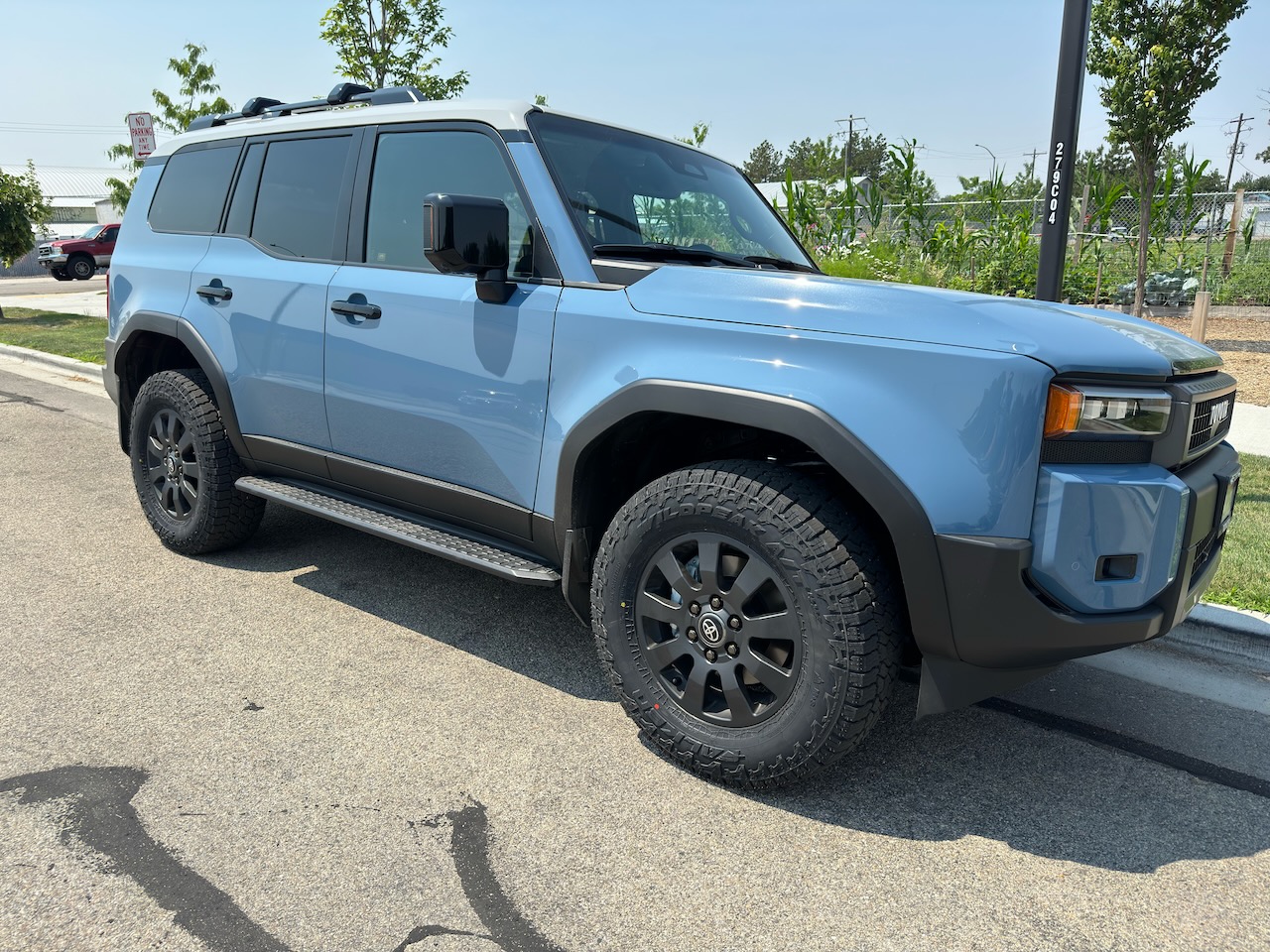

Here’s mine. Also 265/70-18 SL AT4W’s, on First Edition OEM 18”.
Ride before was smooth to the point of boaty. After you can feel the weight in a more solid and planted drive. But still the same overall feel.
MPG dropped by 1 to 2 mpg. Getting 21.1 combined city/highway now.

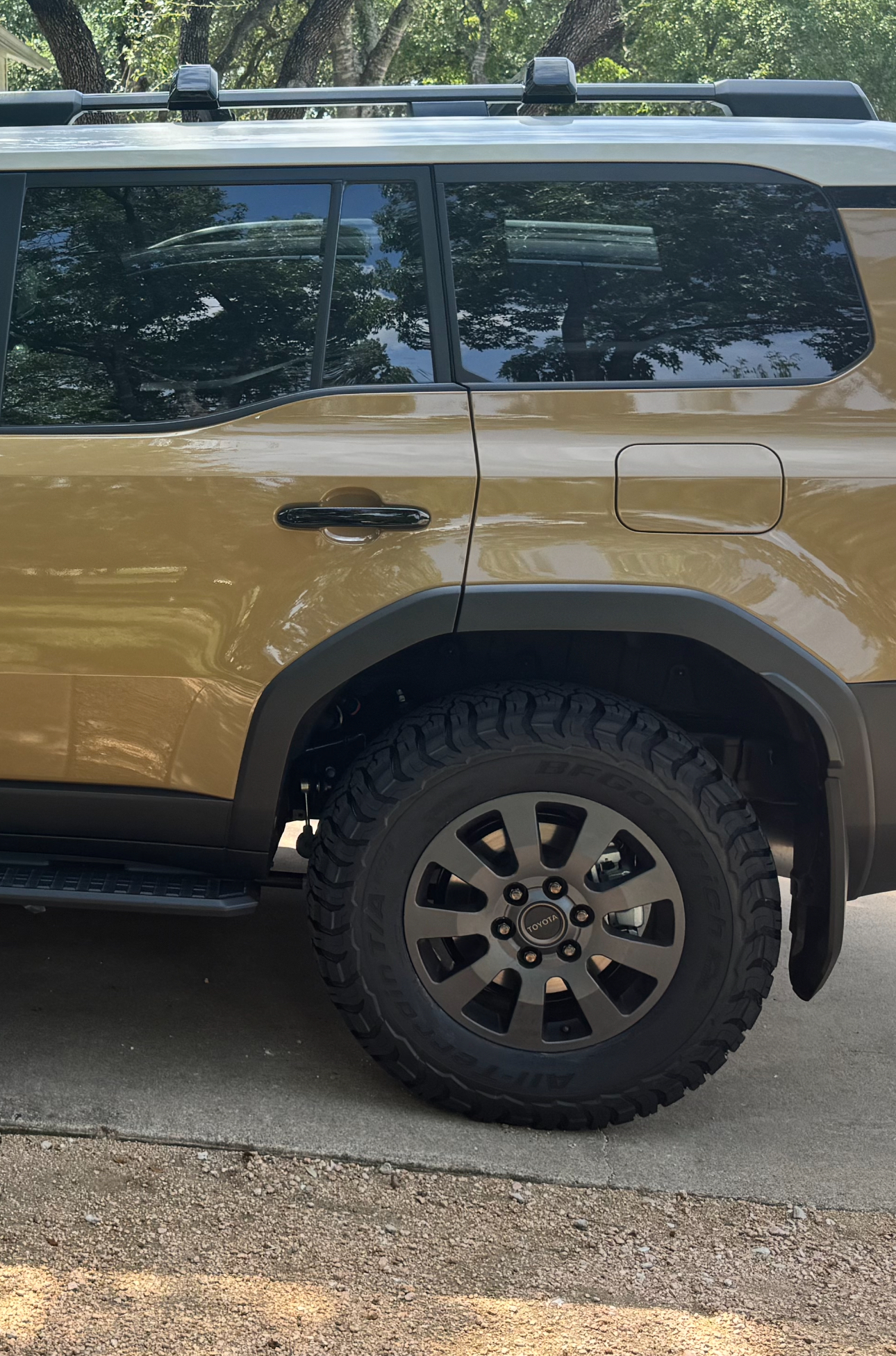

I’m thinking of getting that size KO3. Any wheel rub? Did you replace the spare with the same size? If yes, did it fit? The center caps look great.
No rub, no issues. I did NOT do the spare because I would just use it in a pinch. The KO3s will hang down more and create more drag, without question. I will just rotate the 4 and be satisfied.
