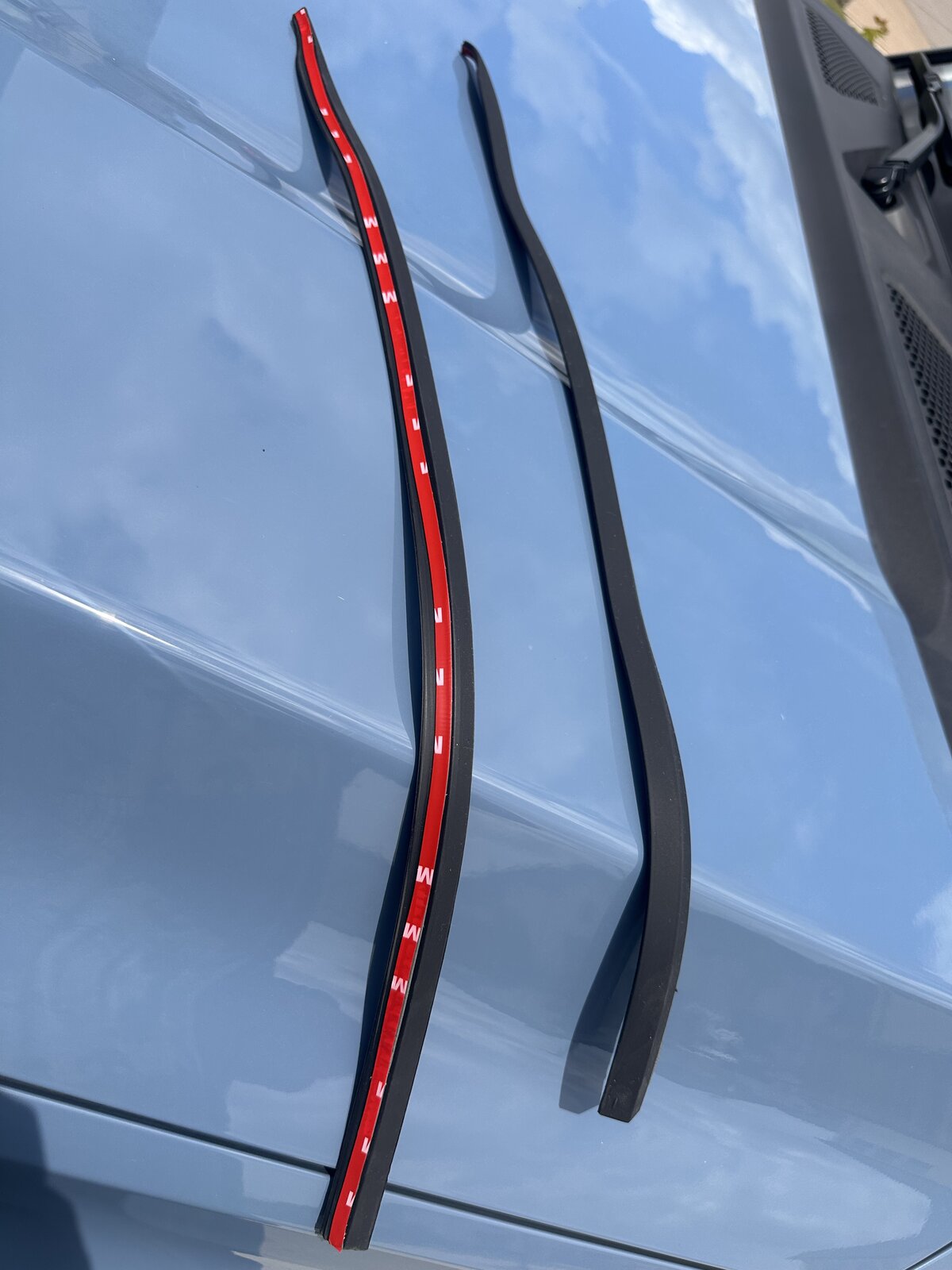

Windshield Seal Tape

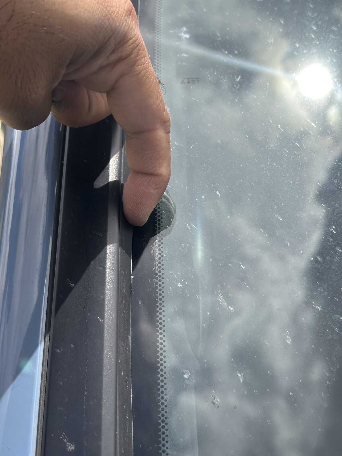

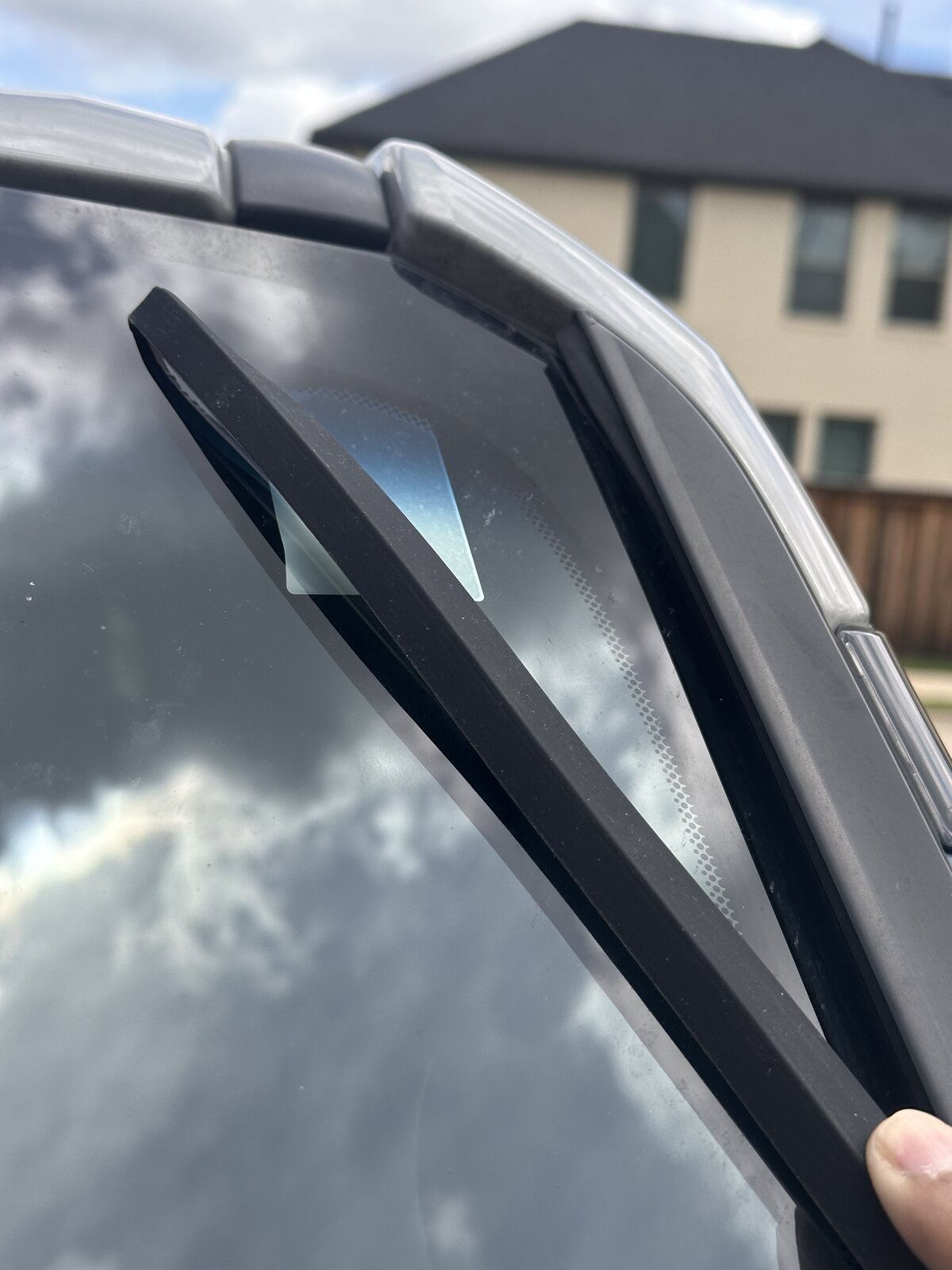

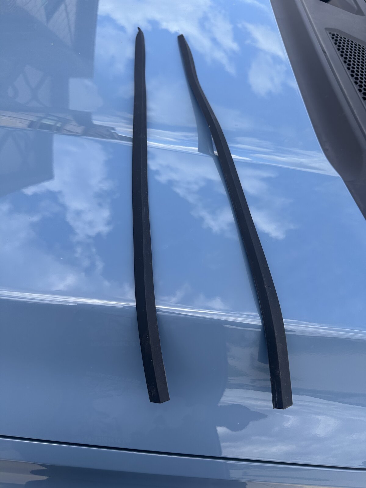

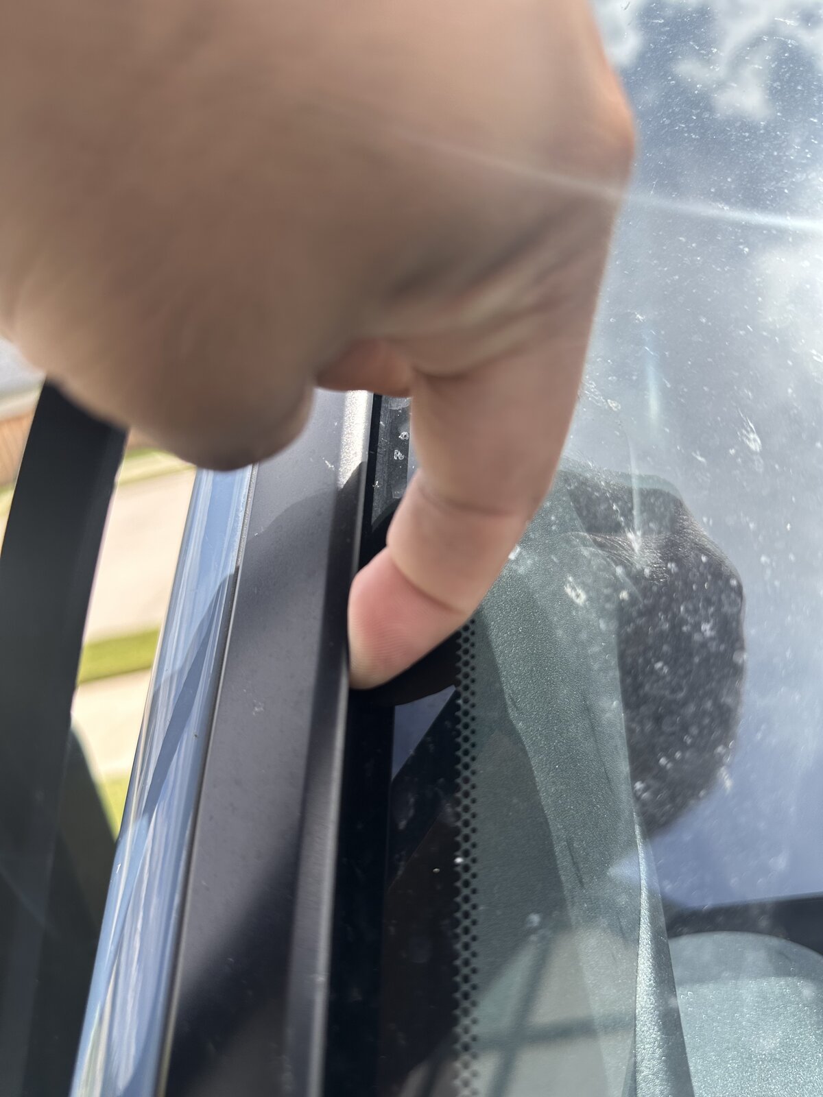

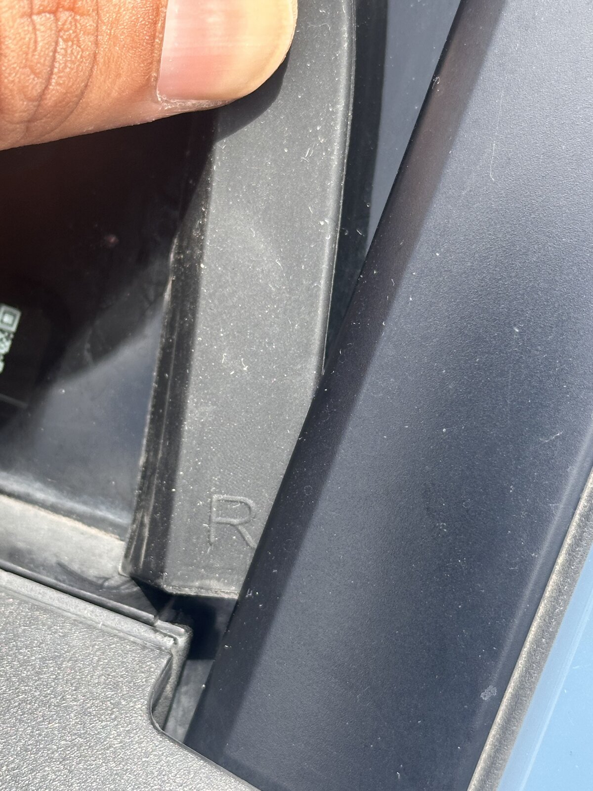

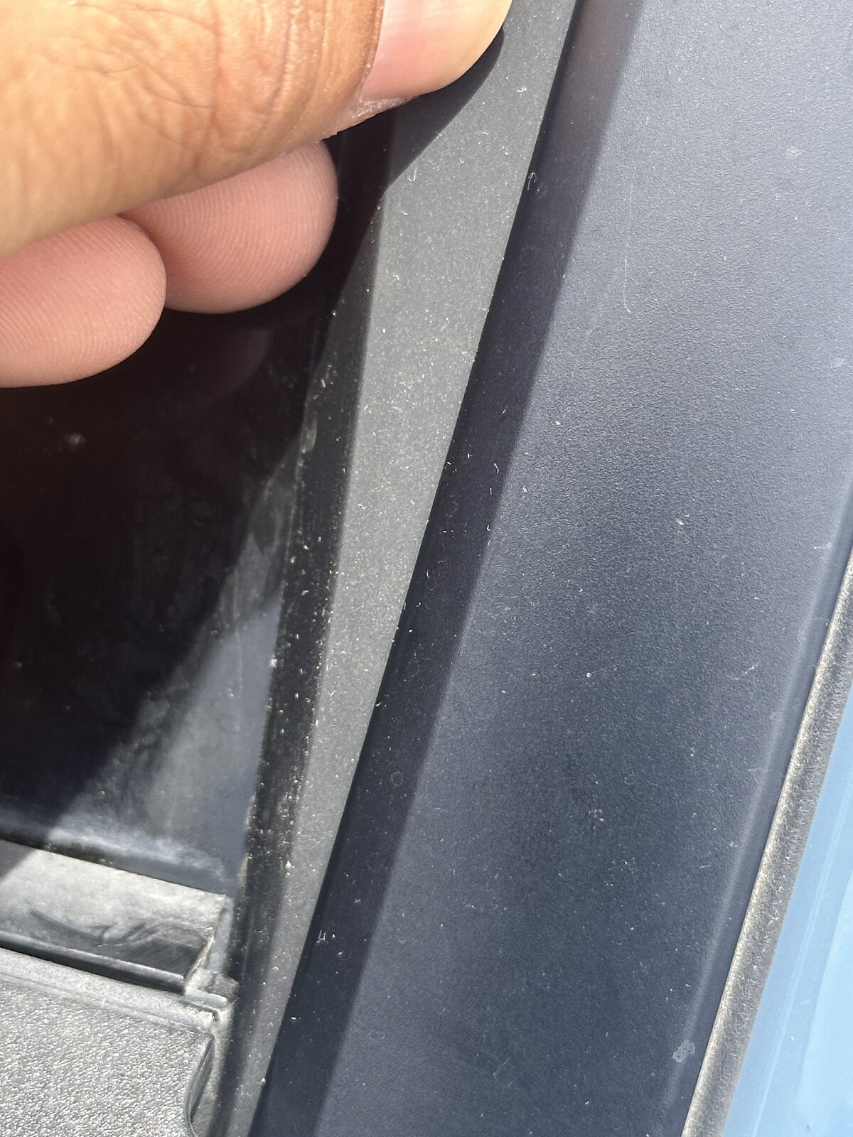

I never even noticed that gap. For those who used these, did you use the 3M adhesive tape? If so, any tricks or tips to pushing the rubber pieces in the gap with the tape backing peeled off?
Not specific to that Amazon tape, but if you peel a corner of the backing off and fold the backing back on itself on a downward angle that extends towards the lower center of the windshield, locate and press down on the exposed adhesive at the top corner of the windshield while gently pulling the backing off some more (locating the trim strip as you go) you should be able to stick it where you want it without messing up the piece.

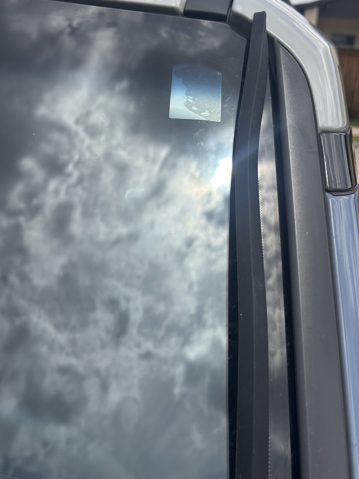

I installed this 2 weeks ago and have helped a lot with wind noise at high speeds.
