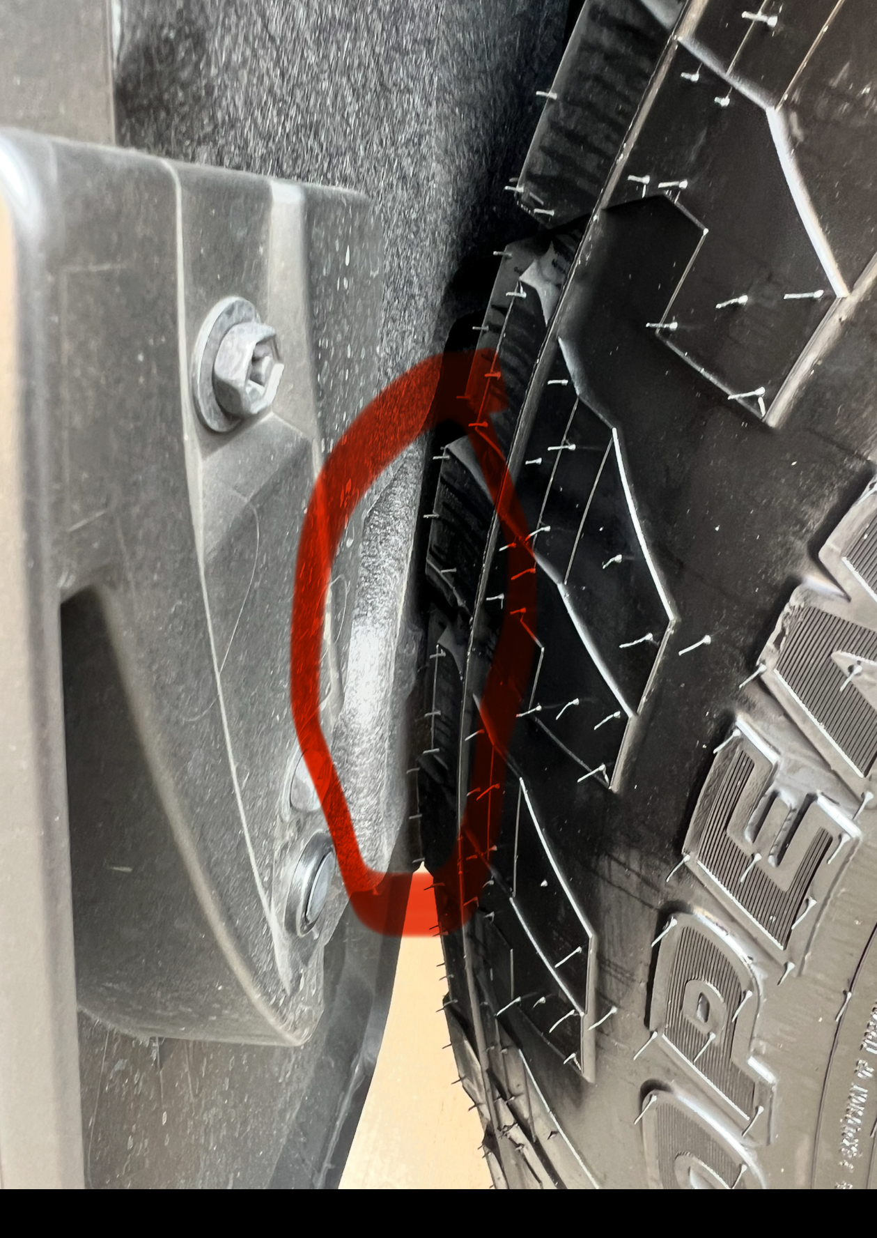

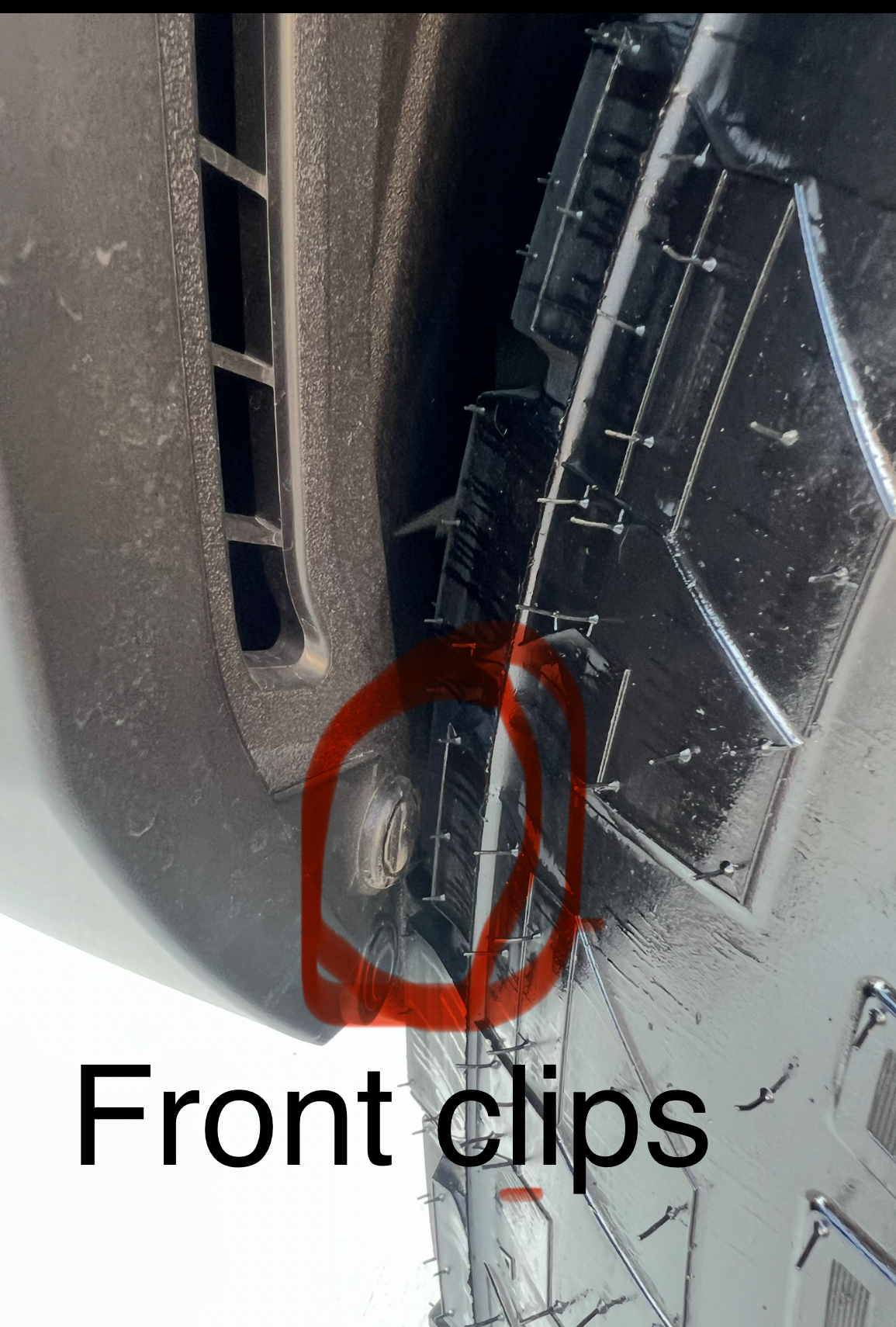

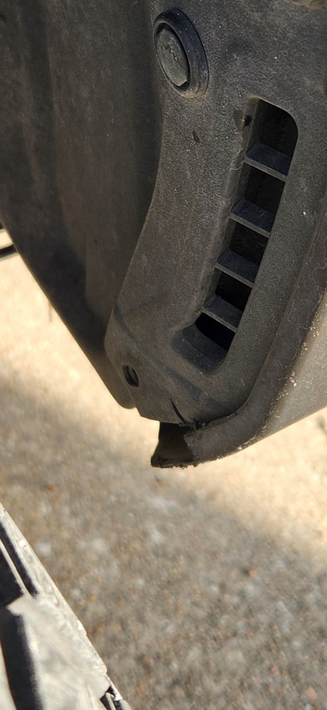

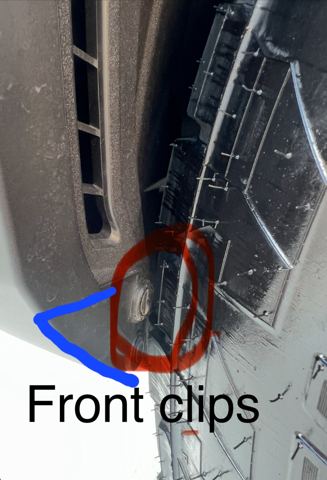

Hello, good day to everyone. First of this is my first time setting up a suv(body on frame). This is my wifes Land Cruiser that I’m setting up. I put on a new set of wheels 18x9 0 offset and 275/70/18 toyo open country at3 tires. Now my problem are I’m having a rubbing issues front tire fender liner and bumper clips, If i invest in a suspension upgrade will the rubbing go away and have a better ride? Ride is now kinda bumpy not sure if its because of the E load tires. And when going 60+mph the car shakes but the steering wheel doesn’t vibrate. I can see the headrest vibrates. Maybe just a rebalance the tires? Any suggestions on a proper lift for long term and will not break the bank?
To all the tire experts, do you think changing tires to 265/70/18 or 285/65/18 will remove the rubbing? To all the people trim or grind the fender liner can you post pics please.
Thanks and be gentle to me please. 😁

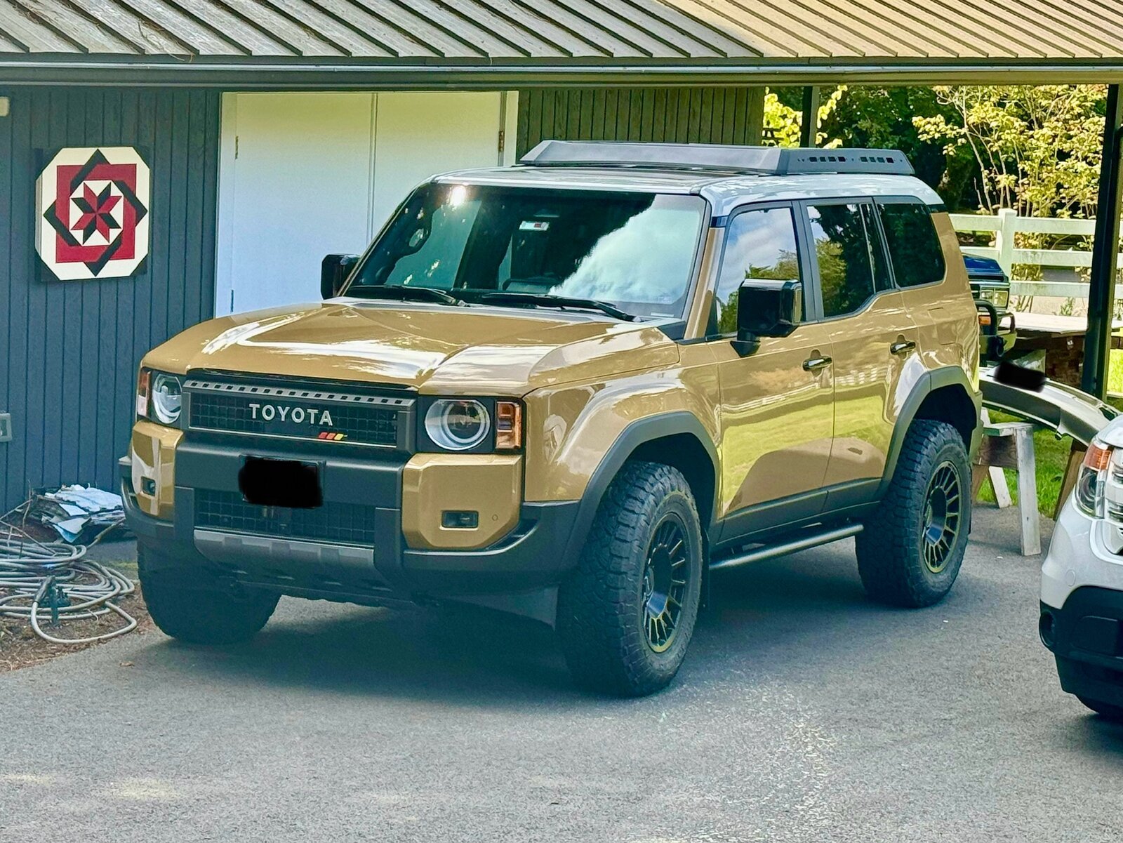

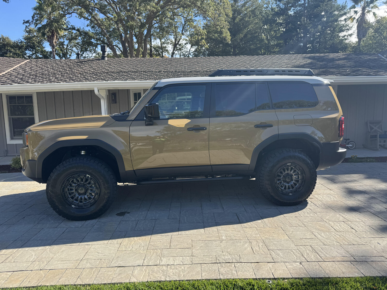

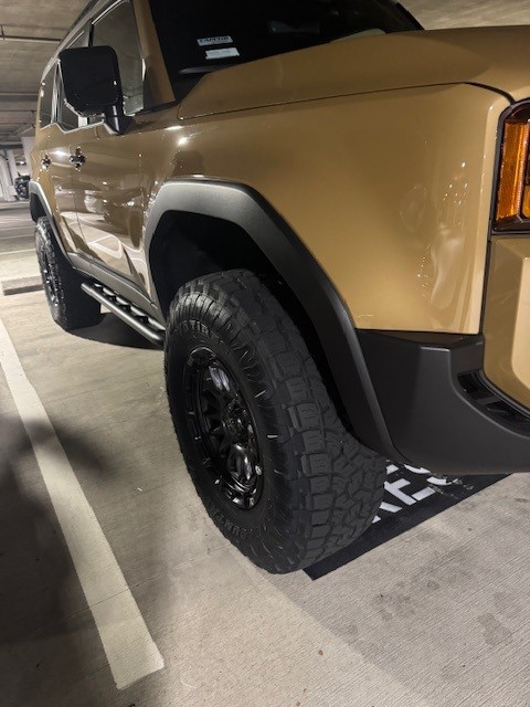

You need at least 25mm offset or more depending on the setup. Here is mine:
17" BLACK RHINO RIVAL 17X8.5 6X5.5 106 +25 M-GNMTL M-
BLK
35x11.50r17 TOYO OC AT lll
Some simple trimming will fix that rubbing very easily. See my post here of what I did
Thread 'Fitting 35s with no rubbing on compression' Fitting 35s with no rubbing on compression
I'll try and get some more photos of what to do with the screw at the bottom. But basically, there's one screw holding in the liner at that position. Unscrew it, push the liner in, and re-screw. That's it

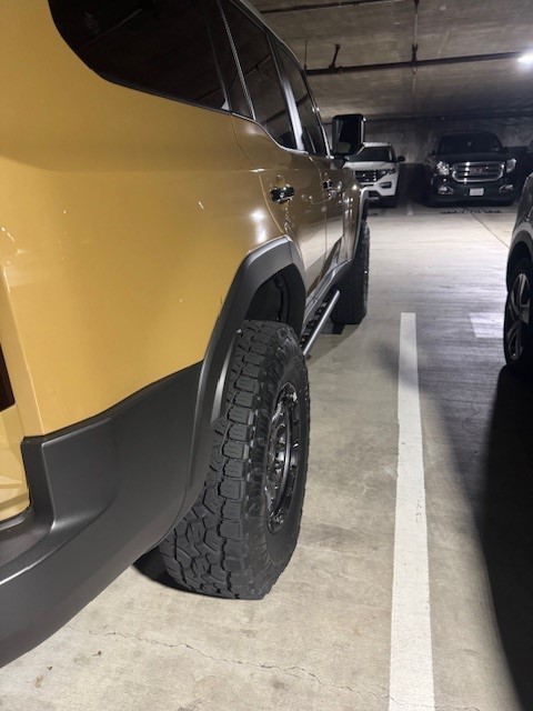

I have 275/70/18 Toyo AT3 as well but my offset is 18mm and no rubbing issues at all.
Did you get a black rhino for the spare and how did it fit? Looks great and Black Rhino’s rock! Very well made.
I kept the OEM spare. They are 707 bead grip Method wheels.

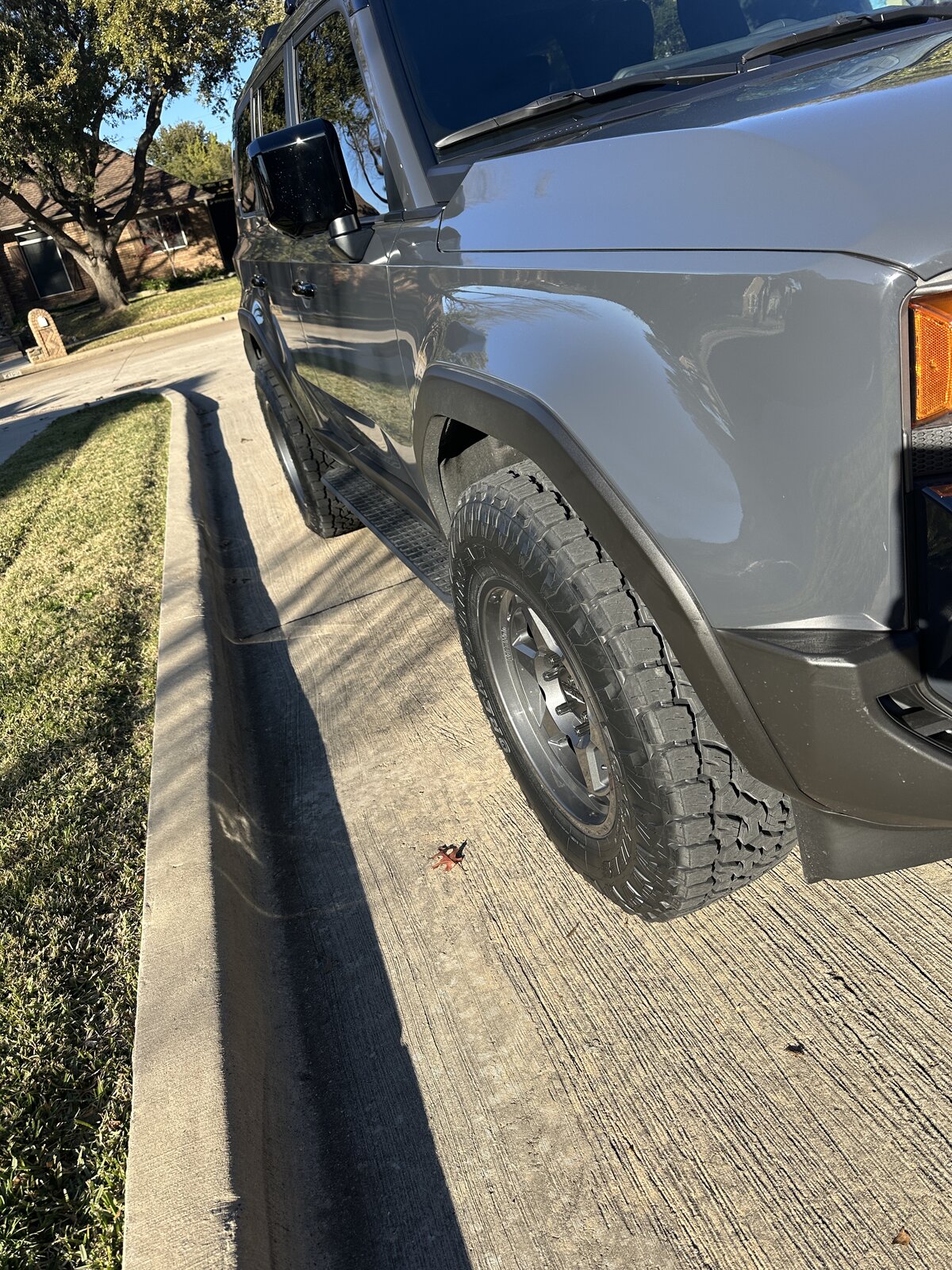

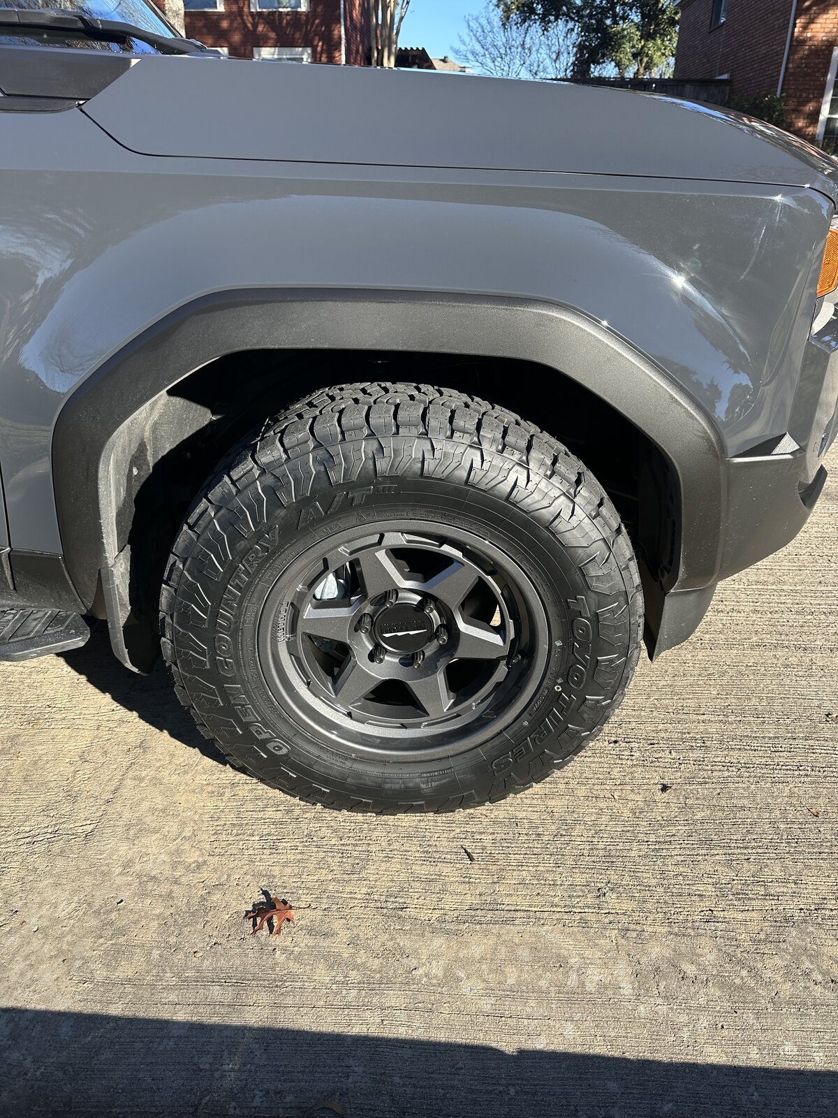

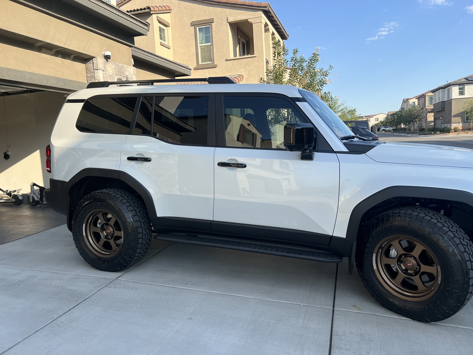

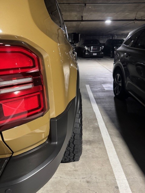

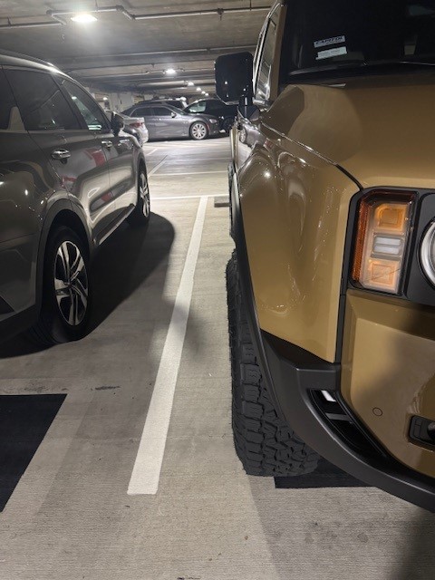

Here are a few pics of my upgrade. Not sure of the offset as Discount tire had the methods listed for the LC. Toyo's 275 /70/ 18 on method 708 Bead grips. Hope this helps a bit.
Thanks for that. From what I can find, that's likely a +12 offset as that's what the 708 shows as an option. The offset is the big part for me. I want more poke than stock, but not a crazy amount. Most Methods I've seen are +18, so that would be about 1/4 less poke than what you have, which might be perfect for me. (y)
You are most welcome. I know this wasn’t exactly what you were asking, but after a ton of research, this was perfect for me.

What wheels are those? I am thinking of something similar in the future. I dig the bronze look on rims.
Thanks and be gentle to me please. 😁View attachment 13896View attachment 13895View attachment 13897

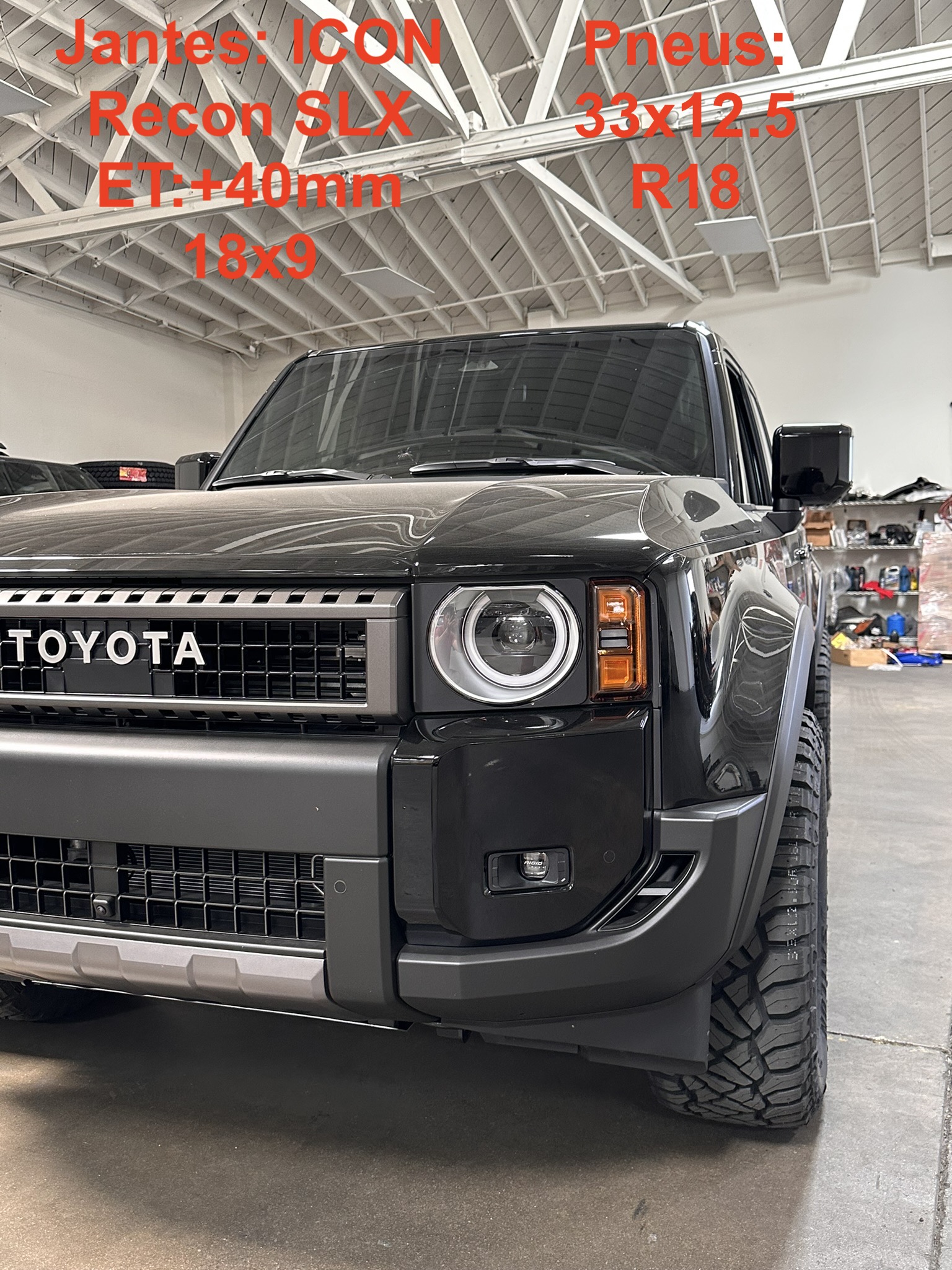

0 offset is too much, try rims between +60 and +20mm offset with stock suspension, and you'll get it .....
