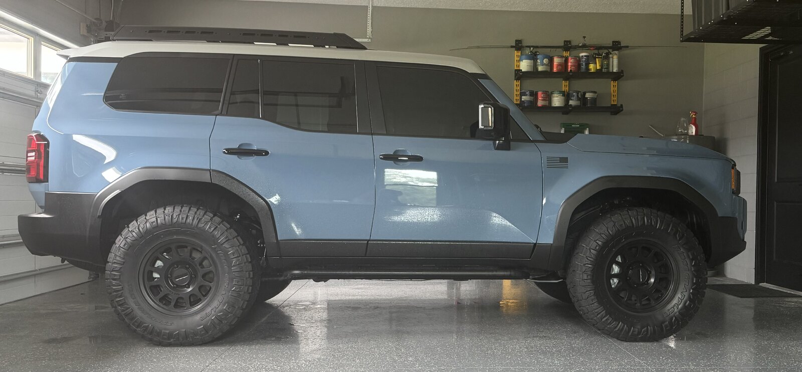

Had the Westcott pre-collar lift installed about 3 weeks ago now along with 17" wheels and 35x12.5 tires.
Floor to fender
- Rear = 39.5"
- Front = 39"
So there's still a slight rake...
The tired and wheel looks good. Which brand? No issues with the ride being stiffer?
Westcott with 35’s.

I’ve had mine on for awhile it does great on and off road. It was in mud, sand, rock, creek beds, and washouts this last weekend no complaints. I haven’t measured the front to rear but mine sits pretty even.
