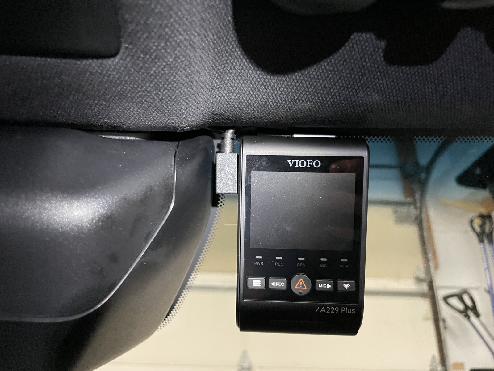

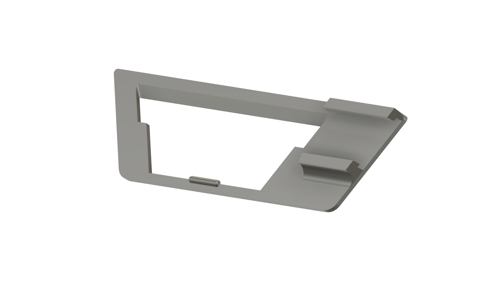

I installed a front and rear Viofo A229 Plus front and rear dash cam with a parking mode option. Here is the process I used in case it's useful to anyone else:

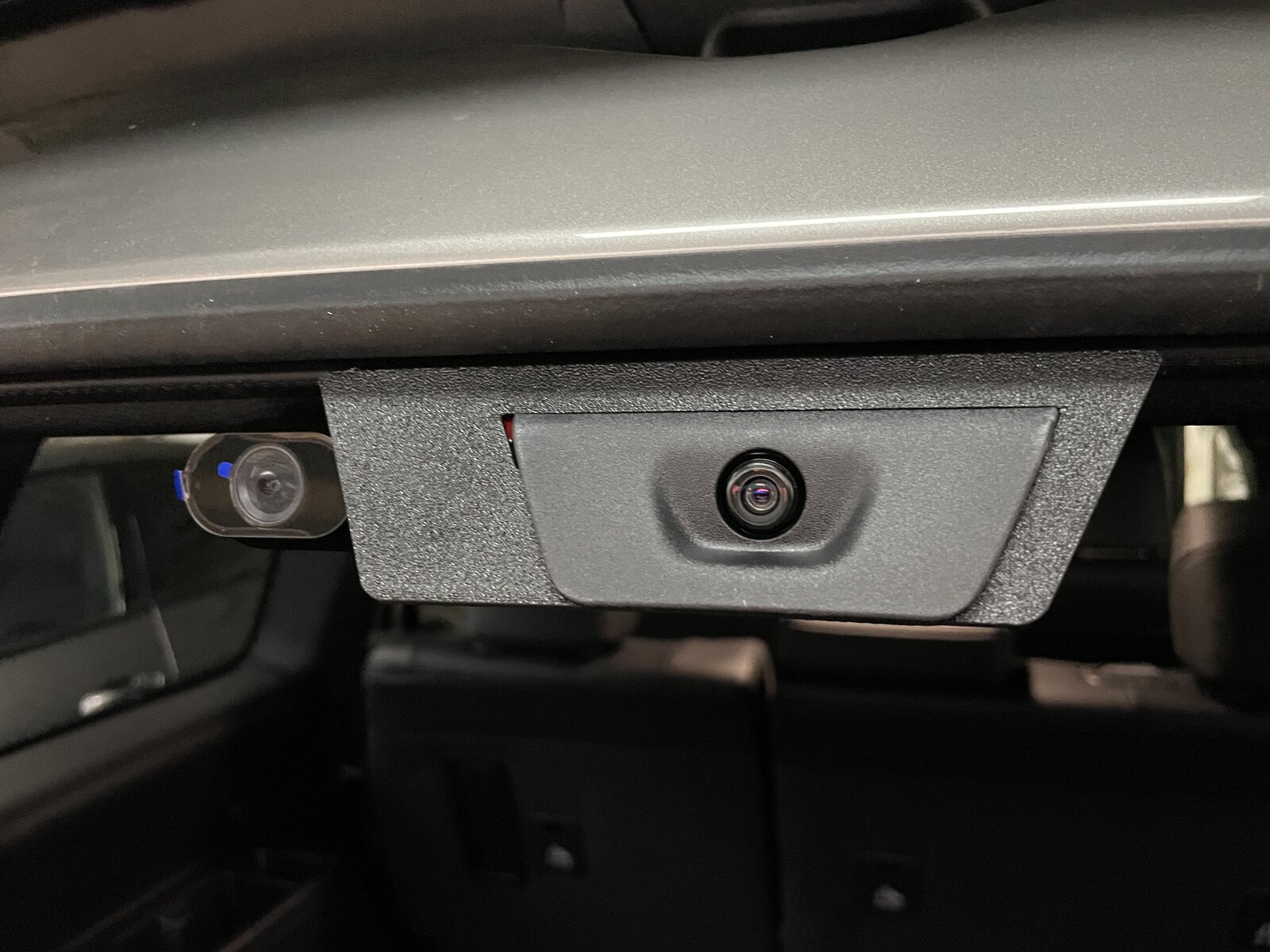

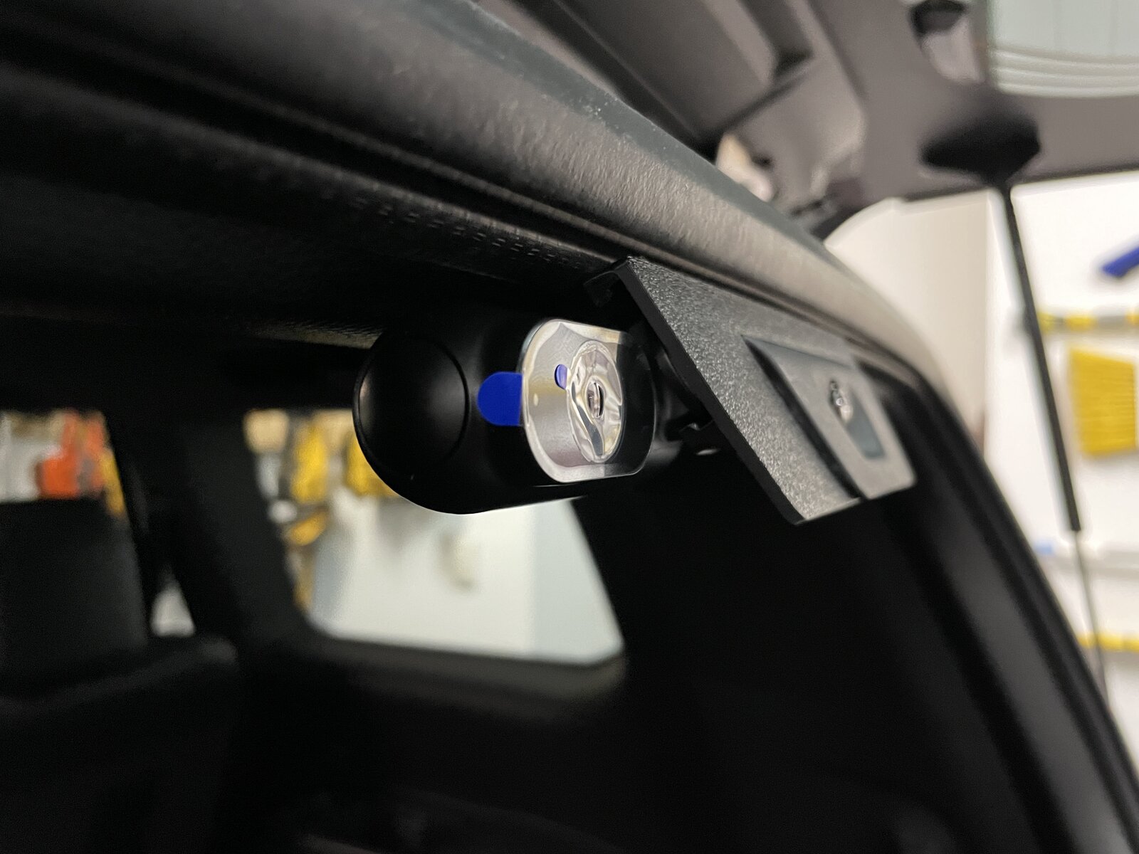

For the rear camera, I wanted something close to factory-looking. I designed a mount that snaps around the existing rear-view camera housing and 3D printed it. The viofo rear camera is a friction-fit slide into the mount, so no adhesives were used and no changes made to the LC (you can of course just use the supplied adhesives and stick it next to the existing camera instead):

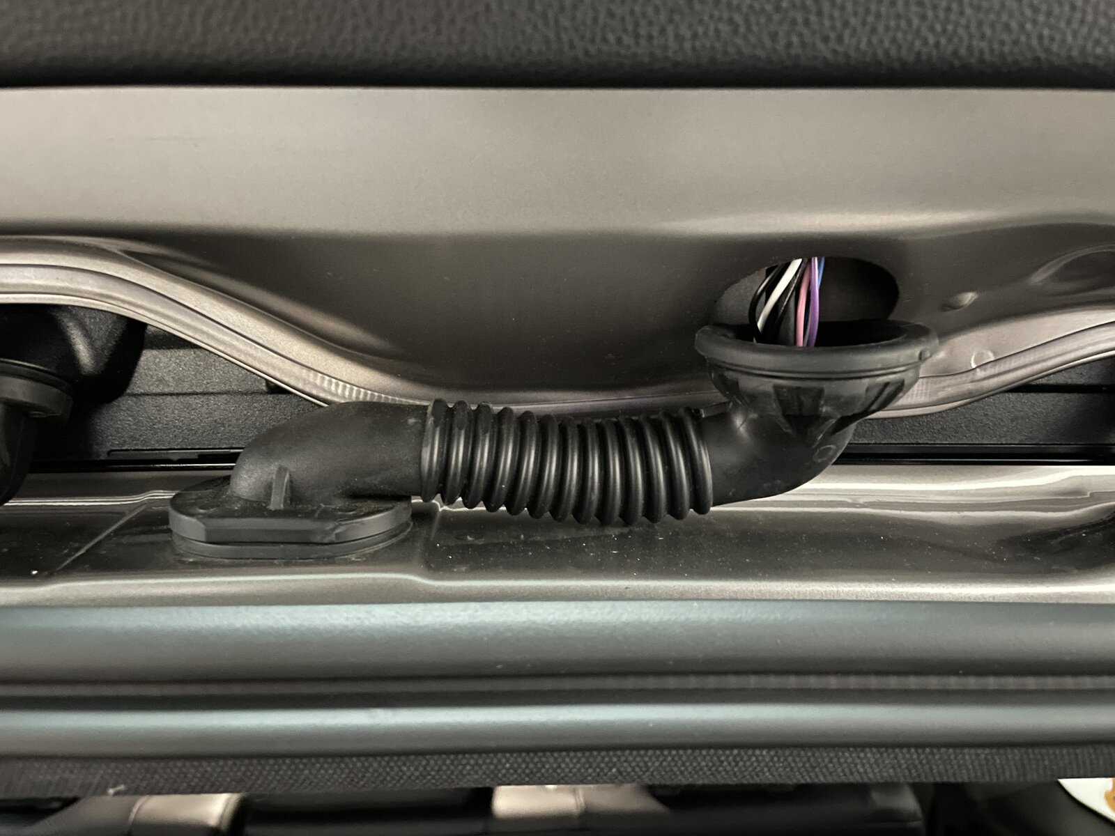

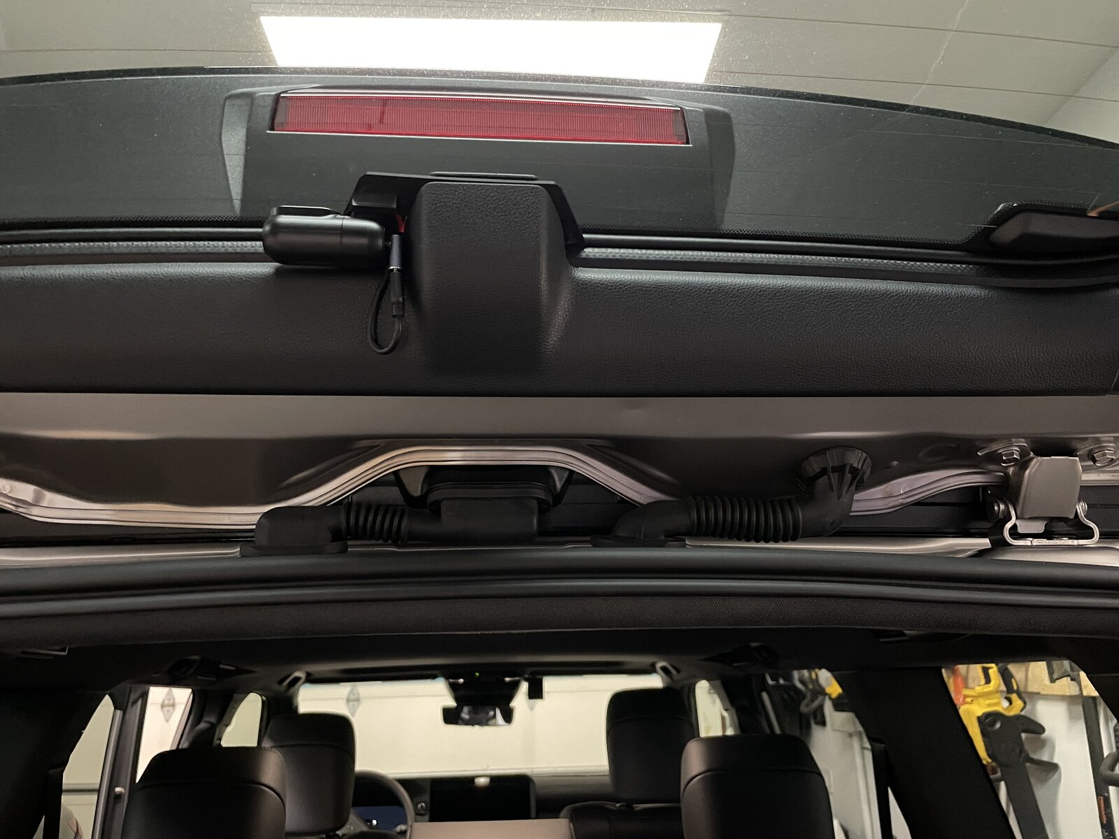

Snaking that wire through to the liftgate was the hardest part, but a super-clean look in the end with no visible wires to snag or catch, and out of the way when loading things:

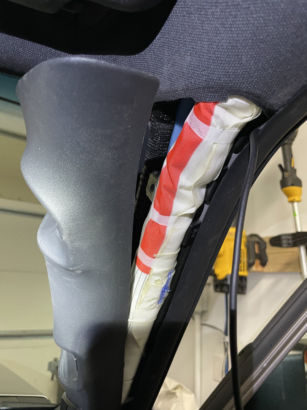

Once out of the liftgate, the wire was easy to run along the headliner to the front. Once there, I popped off the grab handle and A pillar trim to route it behind the airbag, back up to the windshield headliner, and down to the main unit (just to the right of the rear view mirror mount and out of my sight):

Looks great. I love to see the 3d printed solutions.
View attachment 5397View attachment 5398
View attachment 5401View attachment 5402
View attachment 5403View attachment 5404
View attachment 5405View attachment 5406

Brother!! Thank you so so much for this write up! I went with almost this EXACT same set up. I went with the 2 channel A229 Pro version, which uses the same exact rear camera and slightly different camera in the front. I did indeed go with the Dongar Pro, which I plugged into the factory 5 pin power source in the headliner. Getting the rubber grommet to reconnect to the bottom of the rear hatch almost did me in! Finnaly, thanks to Google I was able to find tips/instructions on how to do it.
Is there any way you would be willing to share what you did/how you did it to make the mount for the rear camera? Or possibly make another and ship it? I would be very happy to healthily compensate you for your efforts including paying for all expenses/shipping if so 😎

How much trouble was it to get the lift gate panel off that covers the camera? Have the same camera but will be hooking up to battery pack for parking mode.
For that panel (the one directly over the rear camera) it was not challenging. Use two trim pieces to get a bit over separation on either side and then with firm gentle pulling on both sides and center pull straight out. I think it's just 4 push clips that hold it in. The hardest part for me in all of it is the rubber grommet on the lift gate that was the hardest to remove/replace in order to properly snake the wire through concealed from view.
