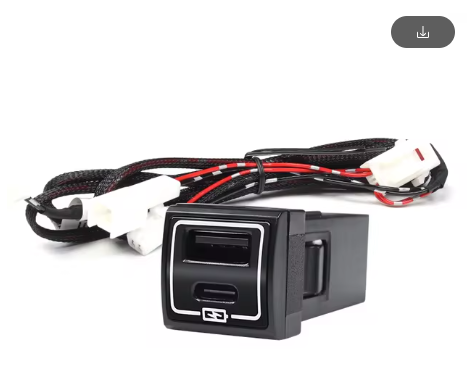

Looks like none support QC / PD. I see a retailer offering a plug, but I need to tear out the center console and see if it will install easily.
Max I can get out of the supplied plugs is 14W.
Never had a LC USB out before but if it's anything like the Taco, the higher amp aftermarket one wasn't plug in play, had to use some JB weld to center it in an OEM housing.
This is what it looks like. Also never mind. It's only QC 3.0. 18w max maybe?
