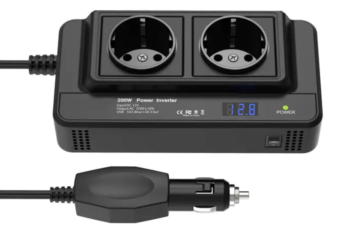

I have a 2024 LC - non-Hybrid version, 2.4 Turbo only - UAE/GCC Version - the output from the USB C ports and wireless charger is the lowest I`ve seen in my past 10 years of owning cars. I have an S24 Ultra and an iPhone 16 Pro Max. When I connect my phone with a 15% battery left on the S24, it shows 4 hours and 30 minutes remaining until full charge. Does anyone else have this problem?
I bought a few power up units to be installed behind those ports, and next time I am taking stuff apart to install switches or other accessories I plan to ump the power for at least one of the ports.
I bought this. Put in your 65W charger and you have a fast charger. The Toyota Land Cruiser it's ports are useless. A real shame.
