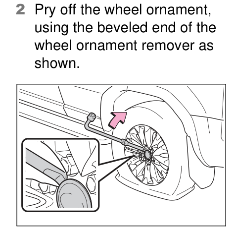

The owners manual shows them just prying off from the outside
