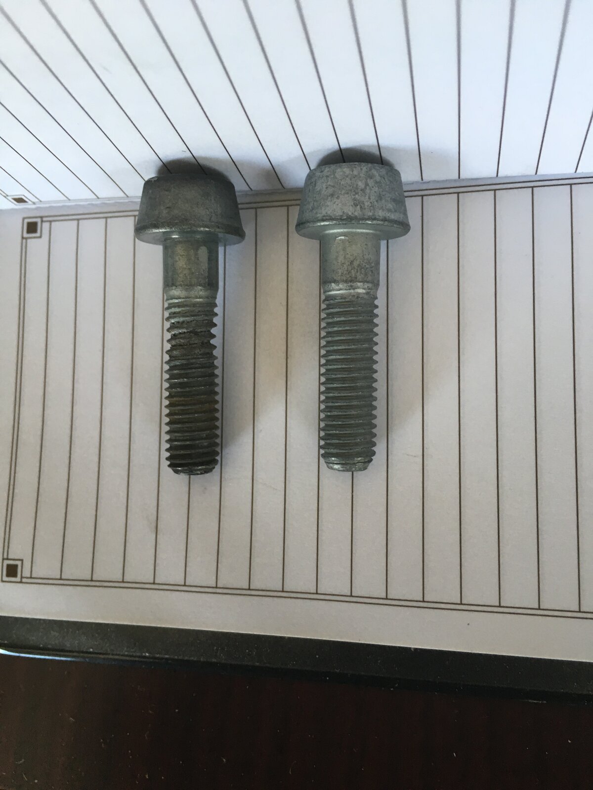

I’ve mentioned this before, but I use torque wrenches when working on my bikes, and anything else mechanical.
13 years ago, before retirement, decided to let a guy who’s wife and I were in the same profession, work on one of my bikes. He was a commercial pilot, was building a plane, had valid A&P credentials, and had 20+ years experience in a BMW bike shop in California, known for their high quality work.
I was watching him retighten my front wheel brake calipers to the fork stanchions. Shocked, I asked, “Why don’t you use a torque wrench?” His reply was that he had “educated hands” and didn’t need one.
Skip forward 3-4 years, and I was putting new tires on my bike (avatar) at my cousins house in East Tennessee after moving back east. I was shocked to find that ALL of the bolts used to hold the caliper on were significantly stretched. Up until him, I was the only person who had removed those calipers (for new tire installation), and I always used a torque wrench.
The bolt on the right is one of the new bolts that I bought to replace all four of the ones that he destroyed. Luckily, the damage he did was visible to the naked eye. I never measured the added length to the original bolt. I don’t know how close it was to failure, which could have been life threatening for me.

TL;DR
This torque wrench thread lead me to a YouTube video about torque wrenches myths, busted. One of the myths that the guy debunked was that dropping the wrenches caused them to be inaccurate. Five years ago, I dropped one of my favorite German made wrenches from about 2-3 feet elevation. I was distraught. Found a place that could check that wrench, and the other three that I had, one going back to 2001 ($49 from NAPA). All of them were spot one.
