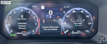

While driving out of my neighborhood and accelerating on to the main road there was a sudden loss of power....felt like the gears disengaged. I can hear the ICE increase RPM as I stepped on the gas but the car was not moving like it should. I had some power; enough to get me to the side of the road and park. These errors popped up on the dash:
1. Drive-Start Control Malfunction Visit Your Dealer
2. Hybrid System Malfunction Visit Your Dealer
3. System Malfunction Visit Your Dealer
I had the LC towed to the dealership courtesy of Toyota Roadside.

This exact thing just happened to me. 452 miles ODO. Waiting for tow truck
Pictures of Malfunction Warnings

There are several different culprits that can trigger the first message for Drive-Start Control Malfunction on Toyota vehicles. Did you check your gas cap as mentioned above? These reports are concerning, especially if you are traveling with your family in remote parts of the country. Hopefully the culprit is sorted out soon enough...
If you're still stranded waiting for a tow vehicle and are able to disconnect the negative terminal on your 12v battery in the back and wait a few minutes and then reconnect, it may clear the fault codes and allow you to get to a dealer.

So the dealer cranked up my LC the morning after towed in, put it in drive and drove flawlessly around the parking lot. The warnings were gone and he can’t duplicate the issue yet. I wonder if he had run the diagnostic analysis when the vehicle rolled off the tow truck rather than waiting until the next morning if we’d have different/better information.
He did ask if I opened a door while the vehicle was in Drive and possibly moved forward with the door open. Codes indicate that this occurred. I did open the door while in drive to hand something to neighbor, but if I rolled forward it was no further than 2’, if at all. Hard to believe that this could be it, but that’s one line of thinking. If this is the source of the problem they really need a way for the owner to reset this. I was very fortunate to be 50’ from my house.
Service director is working hard to get to the bottom of this. Unfortunately despite multiple attempts he cannot yet duplicate the issue. He has escalated and opened a case with Toyota. We’ll see…..
