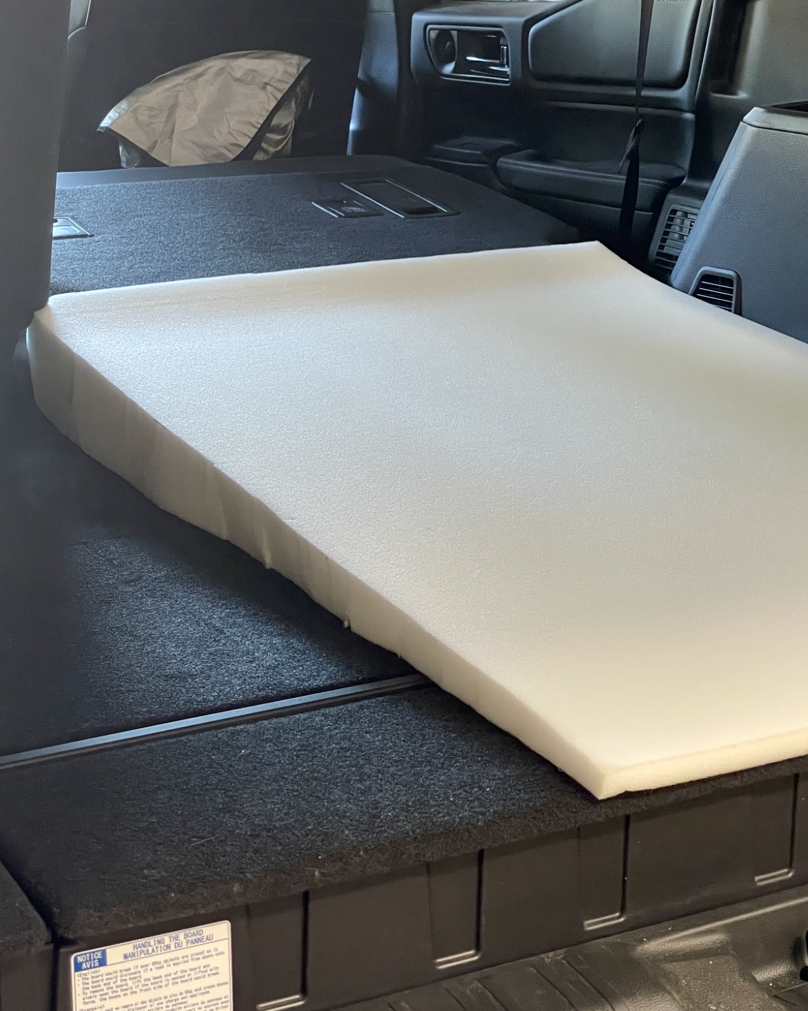

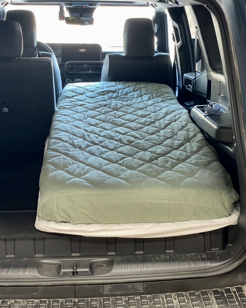

Went overloading last week on the BDR in northern Washington and this setup worked perfectly. I got a foam mattress wedge that is 7.5 inches at the head and cut off the bottom (foot edge) 43 inches (the length of the cargo floor) with an electric knife. It meets the 3.5” step-up to the folded second row seat back exactly and produces a perfectly level sleeping surface since the second row seat back is at the same angle of incline as the mattress wedge. I covered the wedge with a crib mattress protector, then put down a 3” trifold mattress with a 1.5” gel foam topper on it. I flip the folded seat's headrest for more support of the head-end of the mattress. Sleeping is important to me, as is headroom and quick conversion to daily driver.

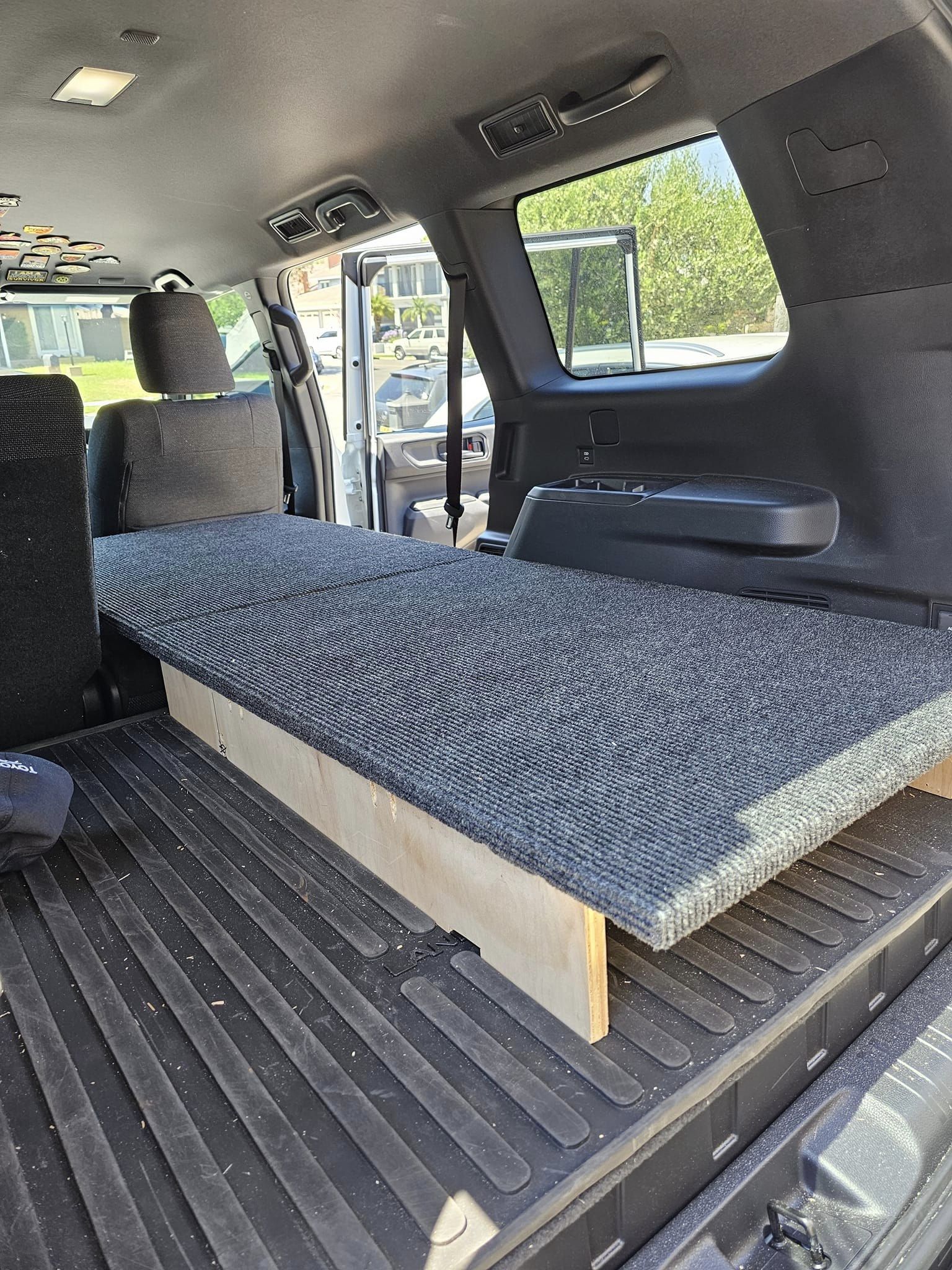

I was looking for something to do on the holiday, and since I happened to have the material kicking around, I made this.
I will be finishing it off with a self-inflating mattress pad to create a comfortable full length surface. I’ll also sand the surfaces and perhaps cover with carpet or fabric.
My personal requirements:
  • Level out the back with the folded seats.
  • Be easy to pick up, move and store.
  • Allow use of the back seats while installed.
  • Be modular so I can use one or both depending on if my wife is with me.
Nothing fancy, but it works. Just in time for nice cool fall weather camping!
