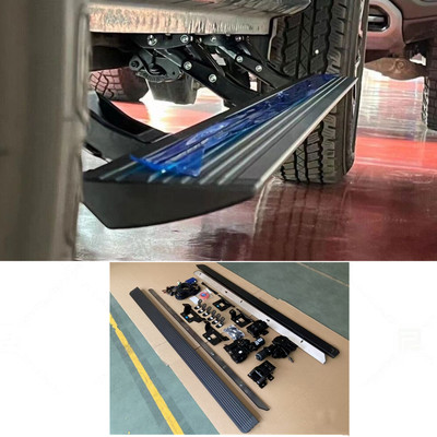

There are power board options on eBay as of today. I have not seen a brand name, but I’m thinking about getting them. Anyone else?
