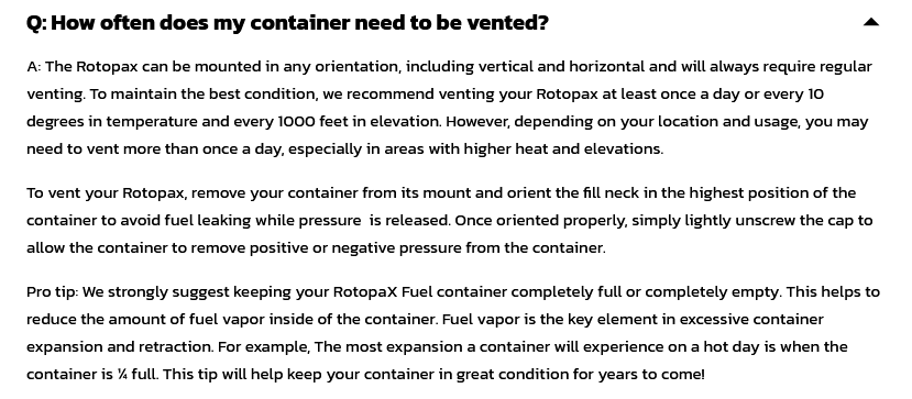

There's a lot of good reading on the Rotopax FAQ page. They recommend venting occasionally and keeping the container either full or empty to minimize fuel vapor inside. Good idea for any aux fuel container.
RotopaX | Frequently Asked Questions | RotopaX

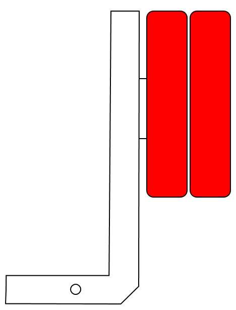

A lot of valid points above. (I don't think top heavy would be a factor) If you don't plan on doing any rock crawling or hard core trails, I think a receiver hitch mount would do you just fine. A very simplistic "L" shaped mount would be more than strong enough to support a couple of rotopacs and if you really needed to, you could remove the mount to get past a tough spot, then reattach it.
(edit) any welding shop should be able to fab something like this in 30 mins.

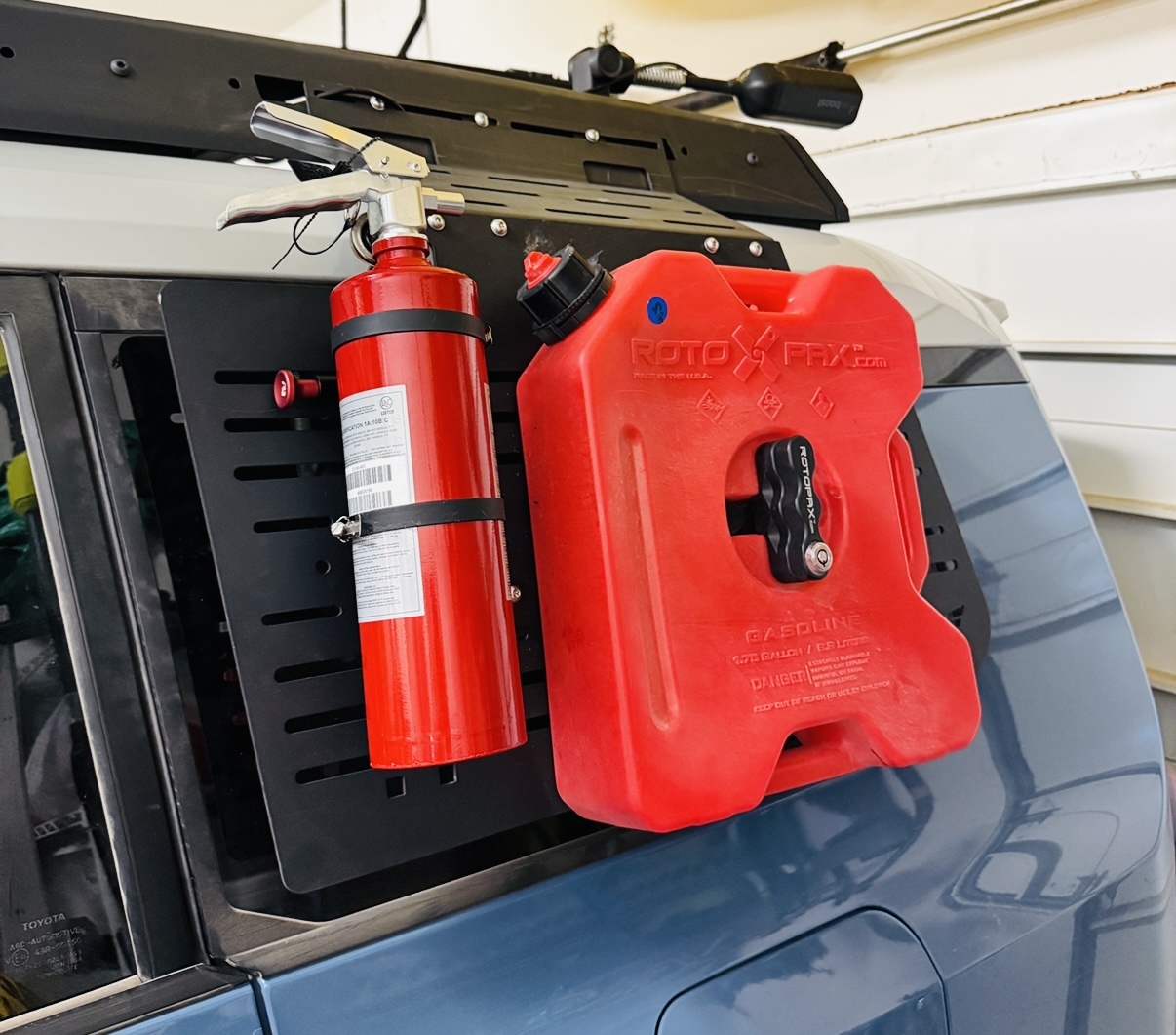

Take home for me is that the side window panels are likely the best way to go (though a bit pricey). Appreciate the good advice.
Regarding side mount rack options, I recently spoke with the owner of Prinsu. He mentioned they're looking into some designs that would work with existing factory racks.
My main concern was definitely wind noise with side-mounted items. However, he told me that with their design, the mounts would be far enough back that any wind noise generated wouldn't be close enough to the driver to be easily audible.

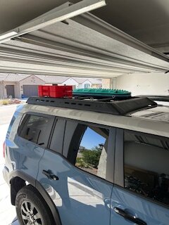

While I am not necessarily a fan of mounting fuel on top, I did just that prior to a 3 week, 3,000 mile trip from southern Arizona to northern Wyoming last month. Our elevation ranged from 3,600' up to over 10,000' coupled with temperatures ranging anywhere from the low 70's to as high as 110. Because of that, I only put 1.8 gallons into each (2 gallon) containers. We had zero issues the entire trip
While I am not necessarily a fan of mounting fuel on top, I did just that prior to a 3 week, 3,000 mile trip from southern Arizona to northern Wyoming last month. Our elevation ranged from 3,600' up to over 10,000' coupled with temperatures ranging anywhere from the low 70's to as high as 110. Because of that, I only put 1.8 gallons into each (2 gallon) containers. We had zero issues the entire tripView attachment 44332View attachment 44332

Victory 4x4 makes an LC250 side panel for just over $200 that fits on the factory rack with the only mod being opening up the top angle a little bit. A machine shop did the bend for me for a $20 donation to their donut fund.
That metals is a little thin. How is the stability
