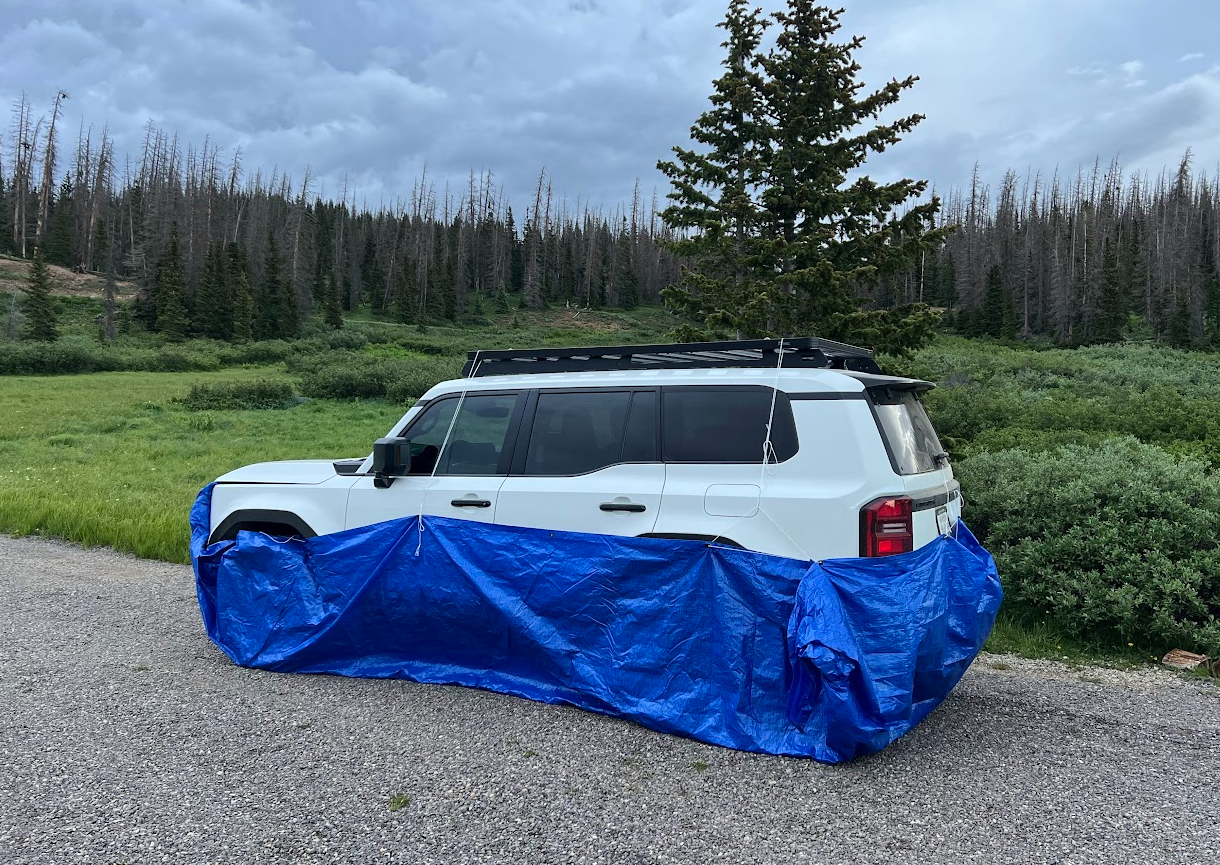

For porcupines and marmots in high country Colorado, driving over a giant tarp and tying up the edges is the only strategy that deters them in my experience. Pain in the arse to set up but it works (so far). I think these two rodents are after the road salt that collects in the undercarriage, but with my luck they'd still chew on the wires if no salt was present. Didn't want to risk it with my month old 250 here.

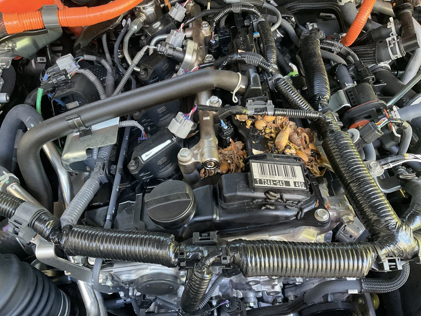

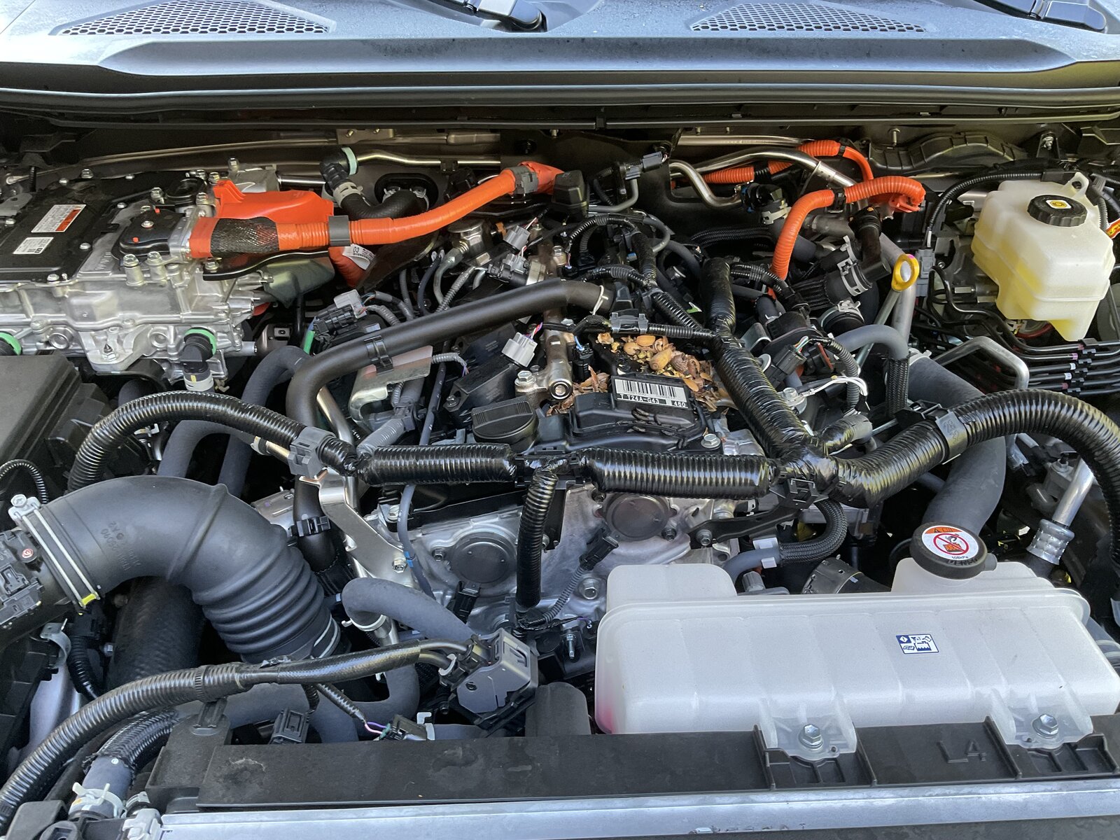

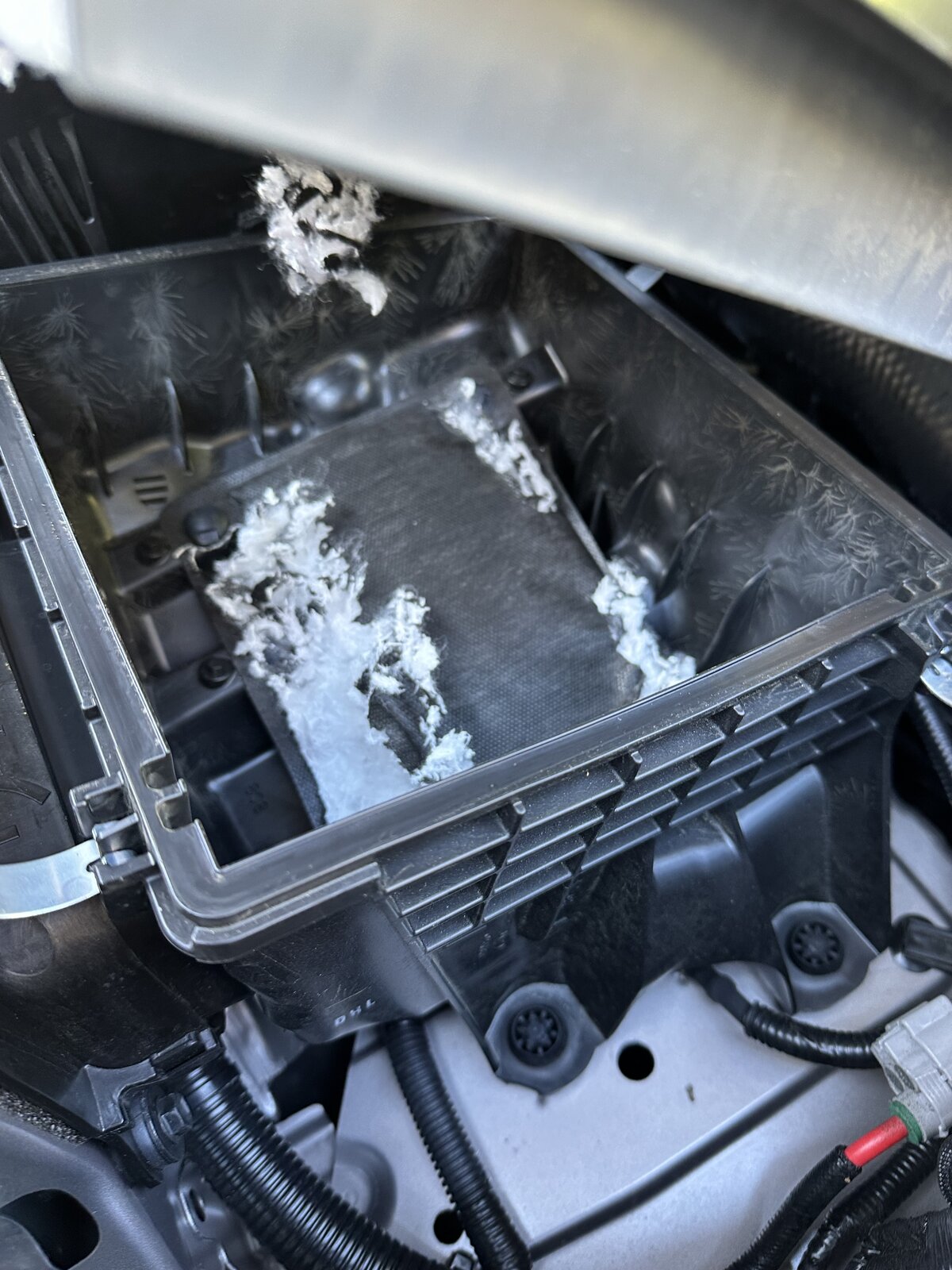

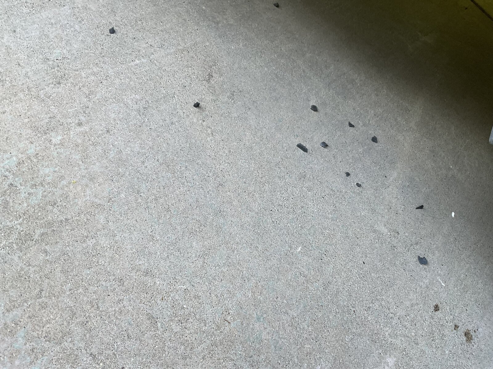

Well…the mint didn’t deter them. All clear last night. This morning I noticed the rubber crumbs by my front tire. Opened the hood…turds and acorns on top of the engine. Opened the air filter box…chewed up and building a nest. I’m going to open up the wheel well…bet they are nesting in there too like they did on our old car.
I slacked off on setting the traps when it was raining. No more…8 traps going back out right away.
Thinking about getting this installed too…they were in my wife’s BMW’s air intake too. $2,600 ain’t cheap, but I am tired of the rats!

Decided to try “fencing them out” from the air intake with some 1/4” mesh. I went inside the air box since the intake is buried under the wheel well liners. Figured it was the same thing to do it inside and easier to access. Also pinned down the chewed up pad inside the air box to keep it from flying apart. Apparently it is not an essential part and replacing it means replacing the entire lower air box ($150) since the part is fixed in place and not sold separately!
