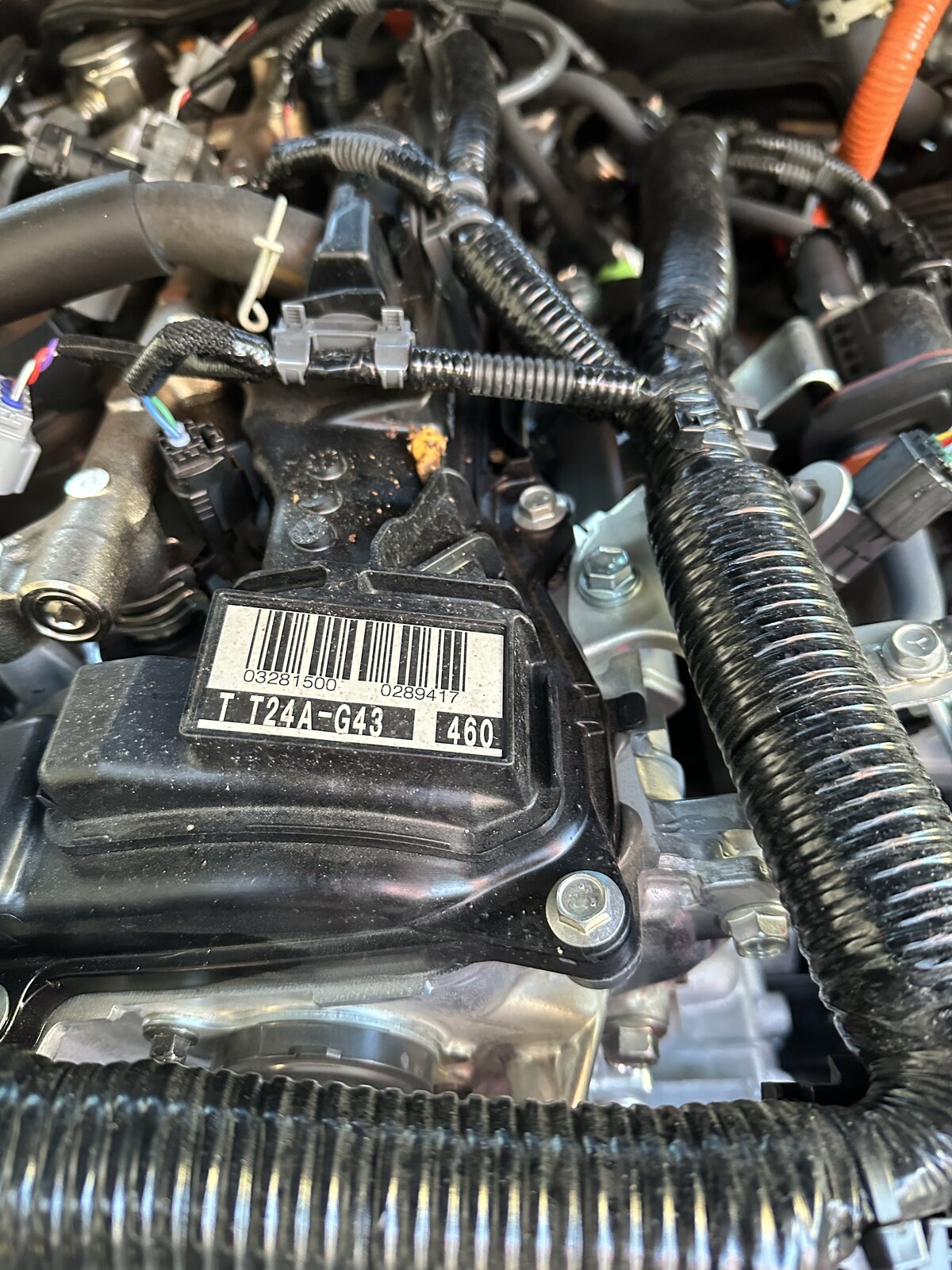

I have a long history of fighting the war on rats in my cars. Had them chew up the inside facing firewall and hood insulation of two Audis. They used to nest on top of the engine of our GLS 450. I also live next to open space and am very familiar with the issue. Haven’t had them nest in my LC yet, but they did sit on top of the engine eating acorns and I quickly put a stop to that (see image below from today…wasn’t being vigilant enough). The only way to stop them is to trap them because they keep coming back. Once you trap one batch, you will have a break, but a new family will come in soon enough.
The only way to have a chance of keeping them out is constant vigilance and not letting your guard down…ever…especially when you haven’t trapped them yet. Here is my current routine (product links below):

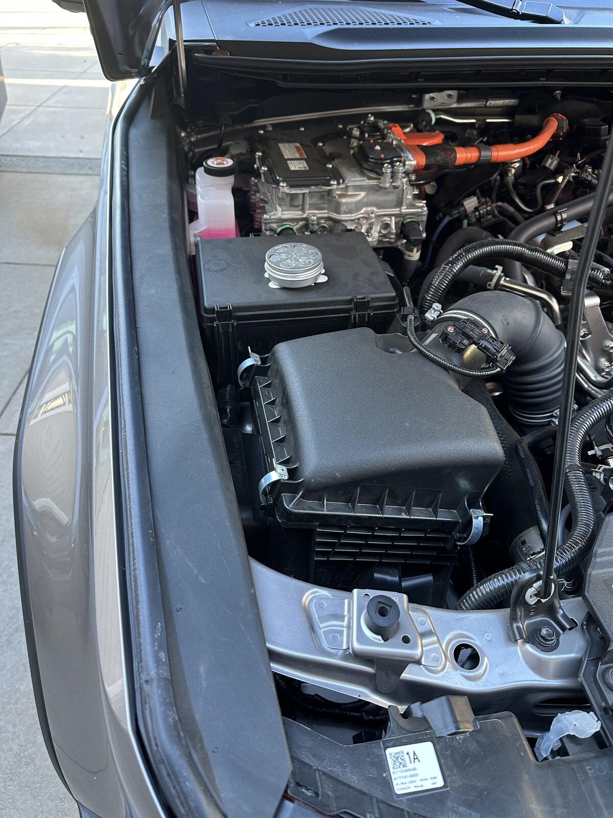

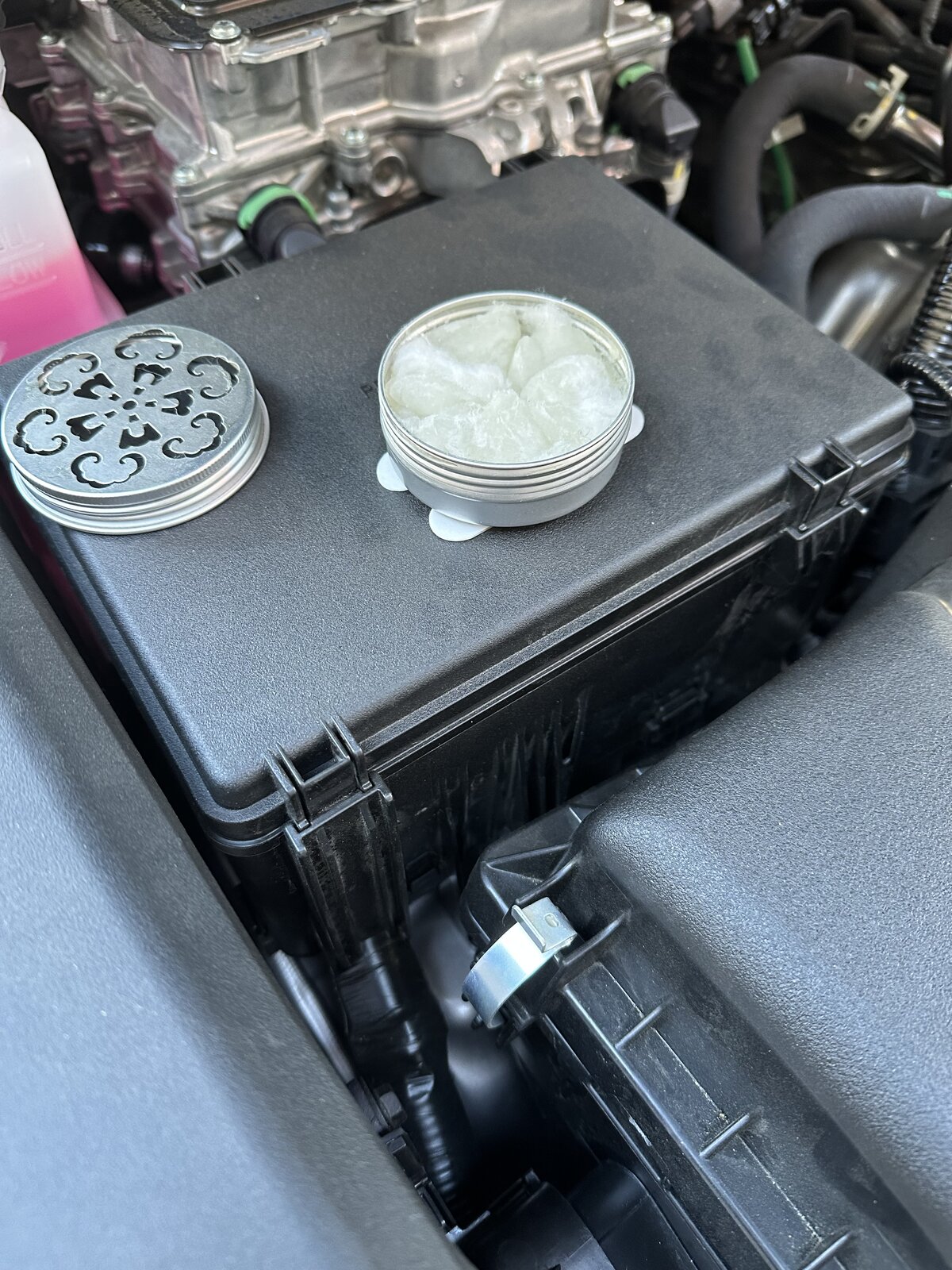

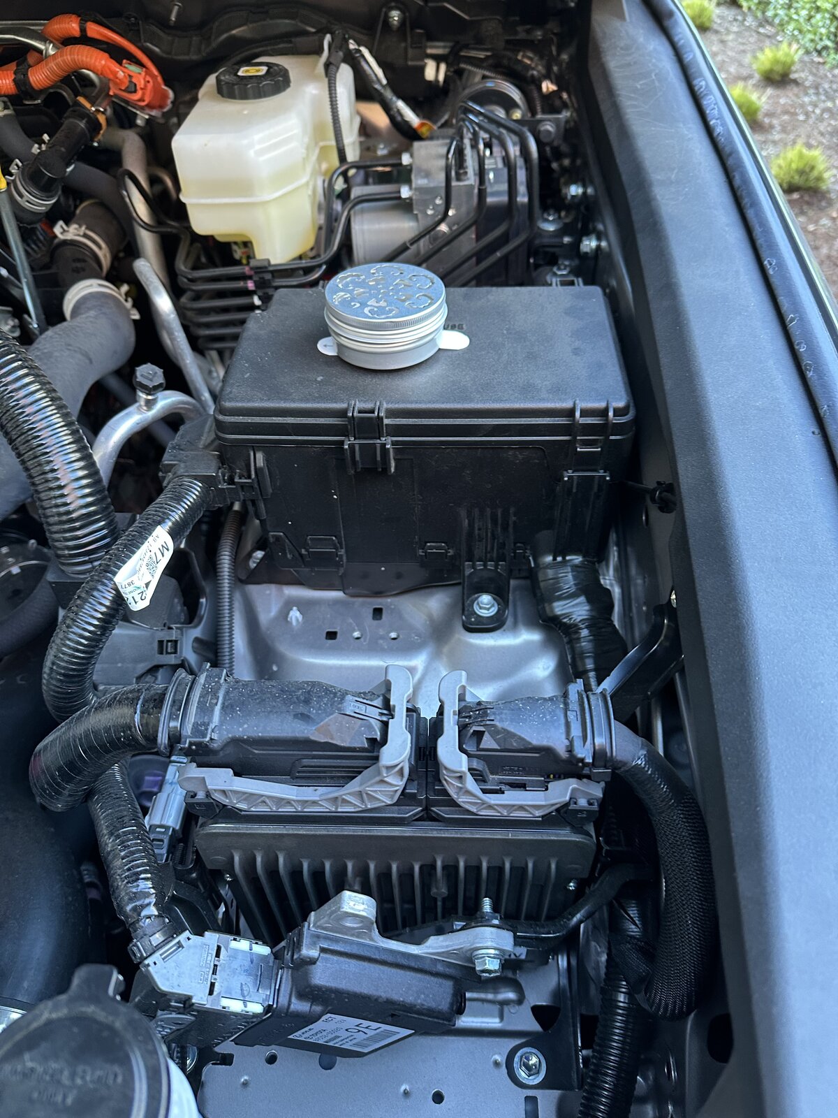

Deterrent…

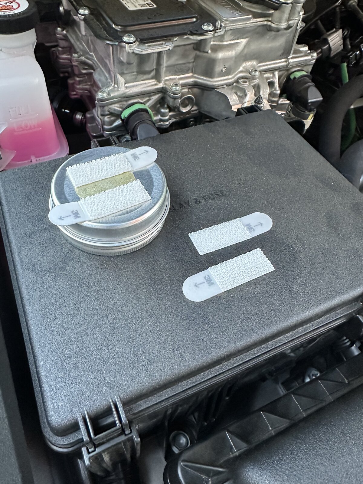

I use 3M command adhesive Velcro strips to attach repellent cans to the top of each fuse box. Use the 3M strips as the adhesive that comes with the cans is hard to get off. Be sure to remove the cover and take off the foam cover inside the repellent cans. Screw the lids back on loosely as they are hard to get off otherwise.
The repellent cream doesn’t last too long, so after about a week, I usually replace the contents of the cans with 5 cotton balls soaked in the peppermint oil shown below. About 15-20 drops per can will do it initially and then 10 drops at least weekly to replenish. I replace the cotton balls and start over every month or two. If rats are active, I add drops daily through the holes on top of the can.

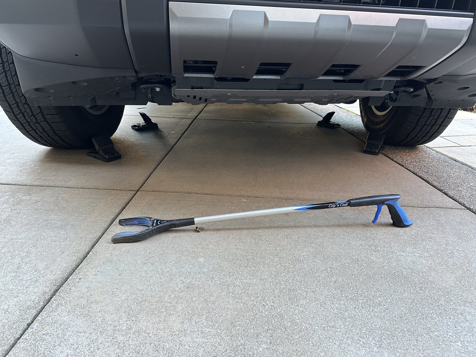

Trapping…
I use between 4 and 8 tomcat rat snap traps under the car. Two against each front wheel as shown and two or four under the engine area. All on the ground.
To bait the traps, I use one piece of dog kibble per trap and top it with a blob of the rat attractant gel. This is clean and works well and doesn’t leave peanut butter goo everywhere. Rats come quickly to the attractant gel when they are around anyhow and makes trapping easier.
The grabber makes it easier to place and remove traps under the car…especially when there is a dead rat in the trap. Works great…dry weather is easy…rainy weather is messy but still works. I find the rats come in to hang out on cool and dry evenings…especially if the engine is warm. Since I live on open space and don’t use poison, I just drop the dead rat onto a shovel and fling it over the fence to feed the wildlife.
