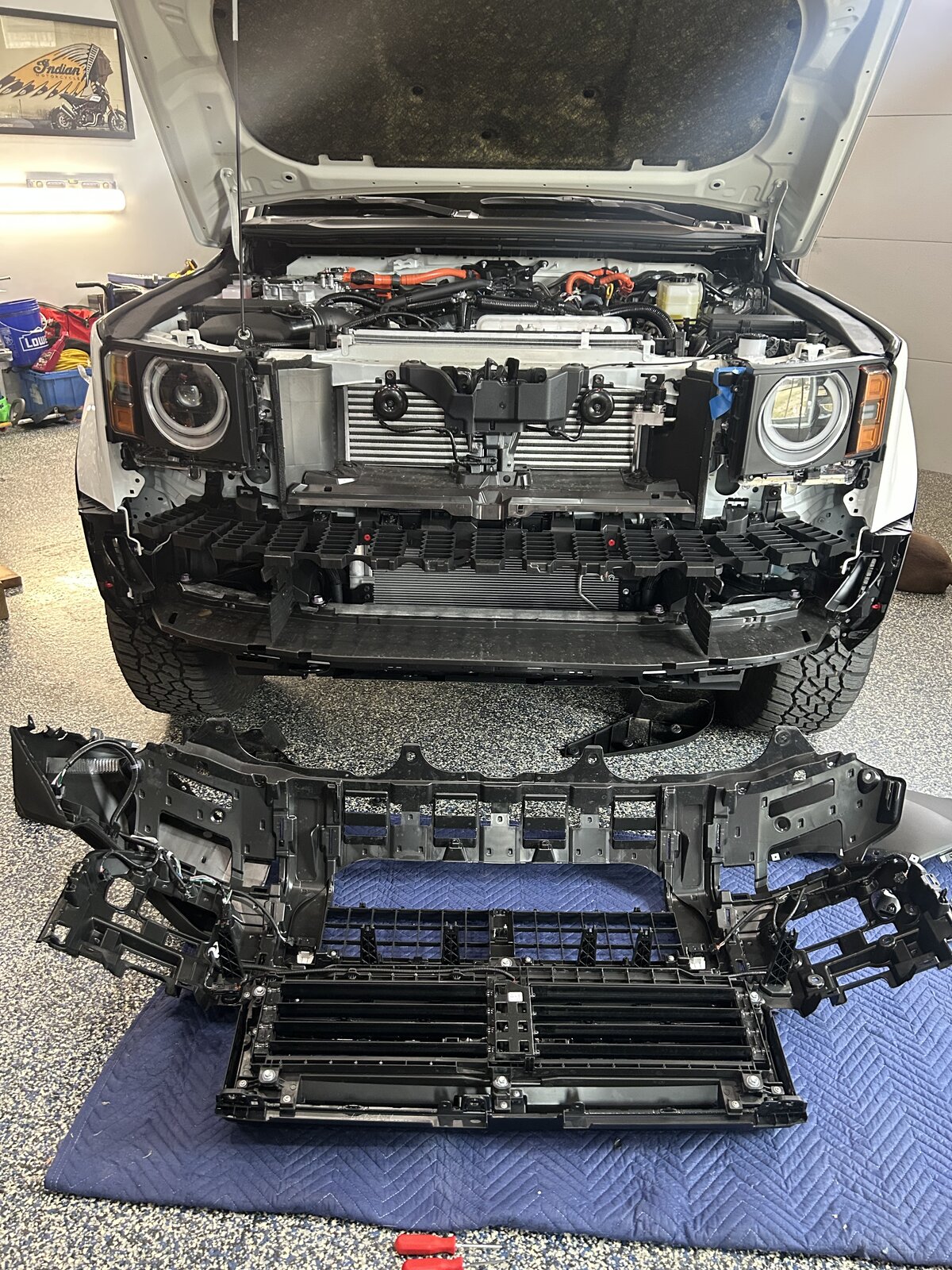

It’s a job to swap these out. There is a video on YouTube that walks through it, just do a search. This is mine when I took it apart to paint them.

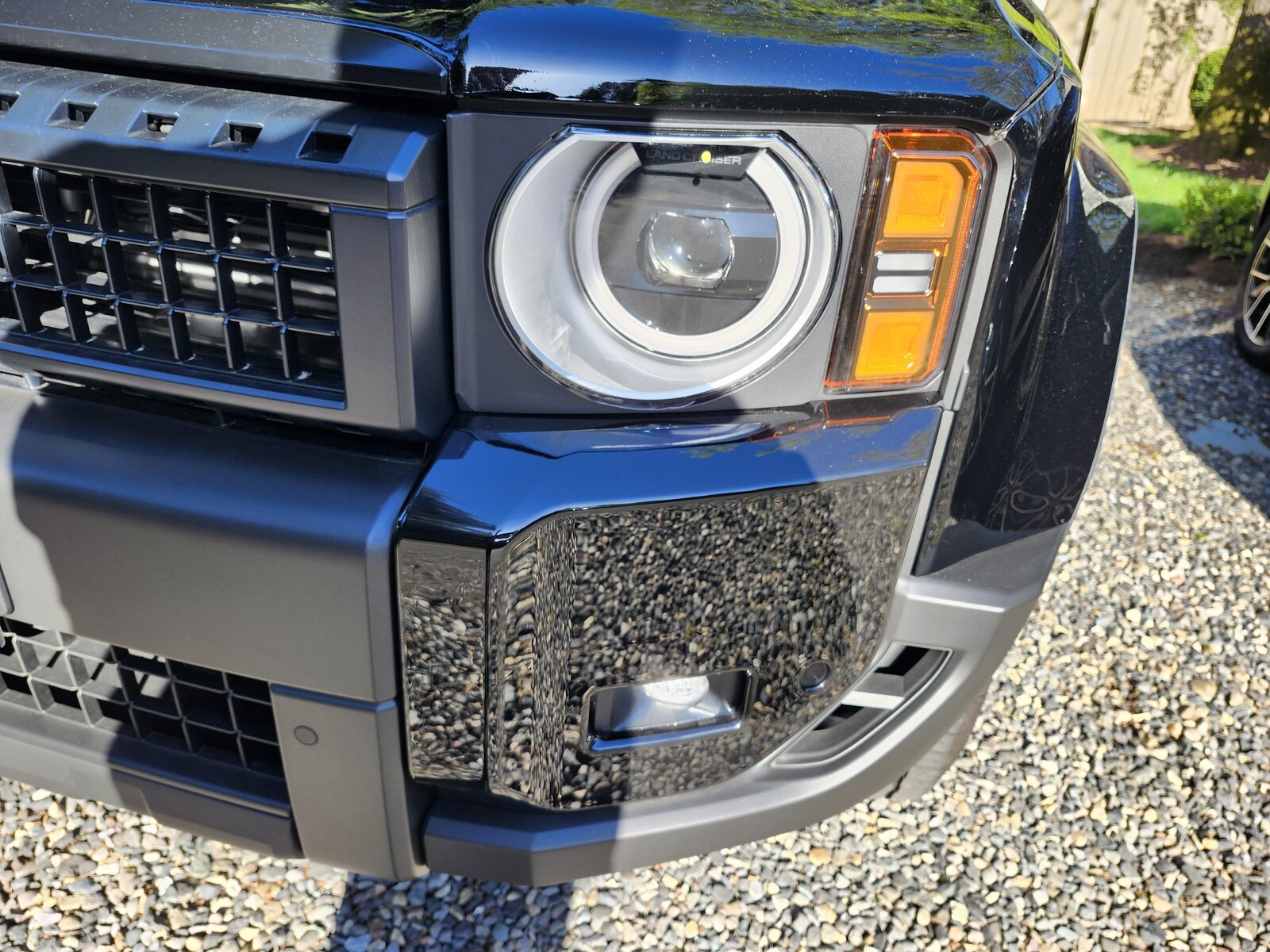

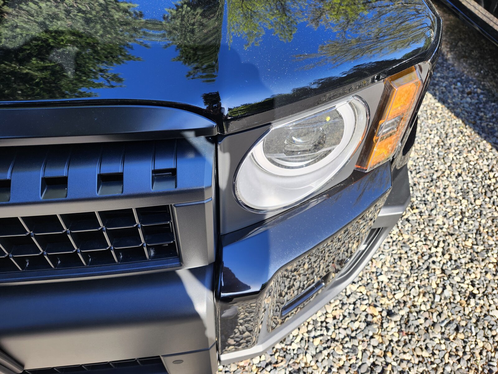

It took 5 min to installed both sides and no paint required in black. I don't have any affiliation with the vendor.

The bumper covers came with double side tape inside. The first part is to clean the surface area of the LC250 front bumper with a little wet wipe that has adhesive accelerant in it, then peal the double side tapes from the bumper covers and finally attach left and right side covers by adding pressure with your hands. I think the vendor added a notice to do this at room temperature and avoid car washes for 24hs. I got them installed 2 weeks ago and have zero issues or regrets, it looks factory.
Sure glad I asked! I didn’t realize these were covers! Can you upload pictures closer to where the seams are? Thank you!
