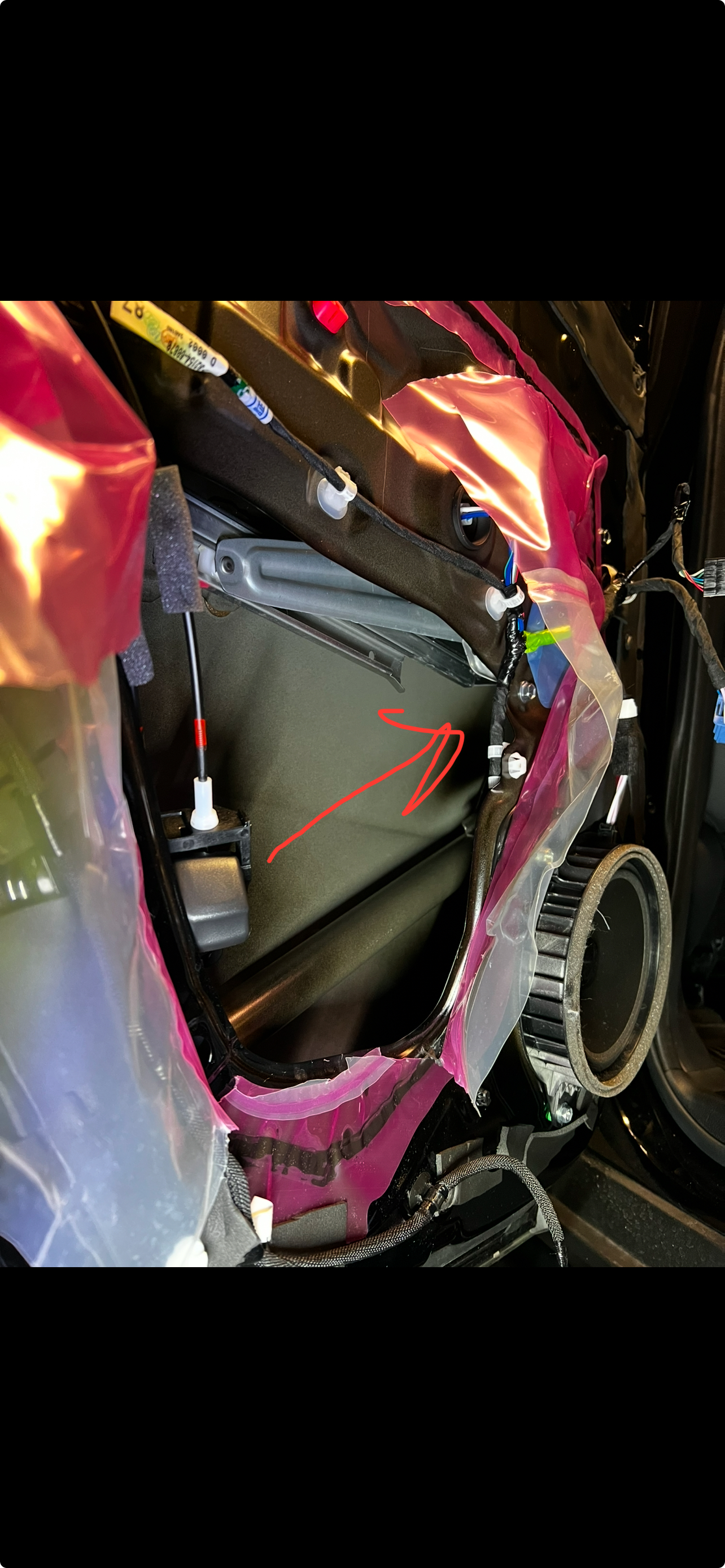

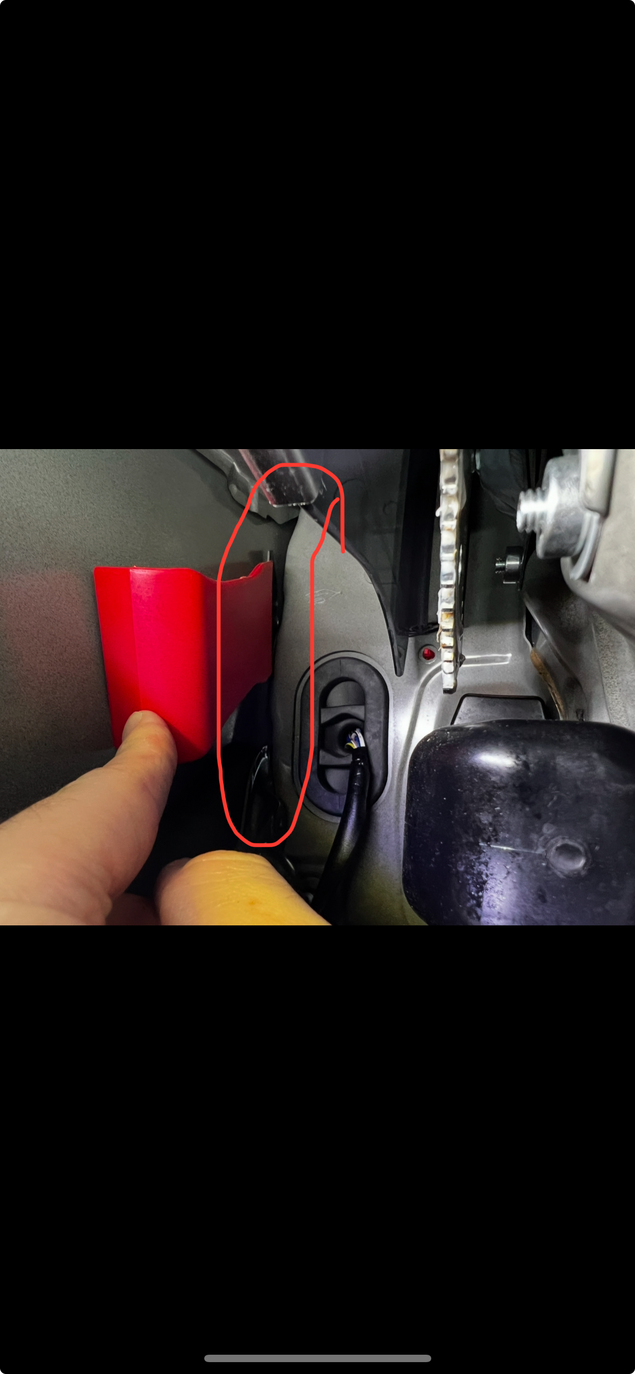

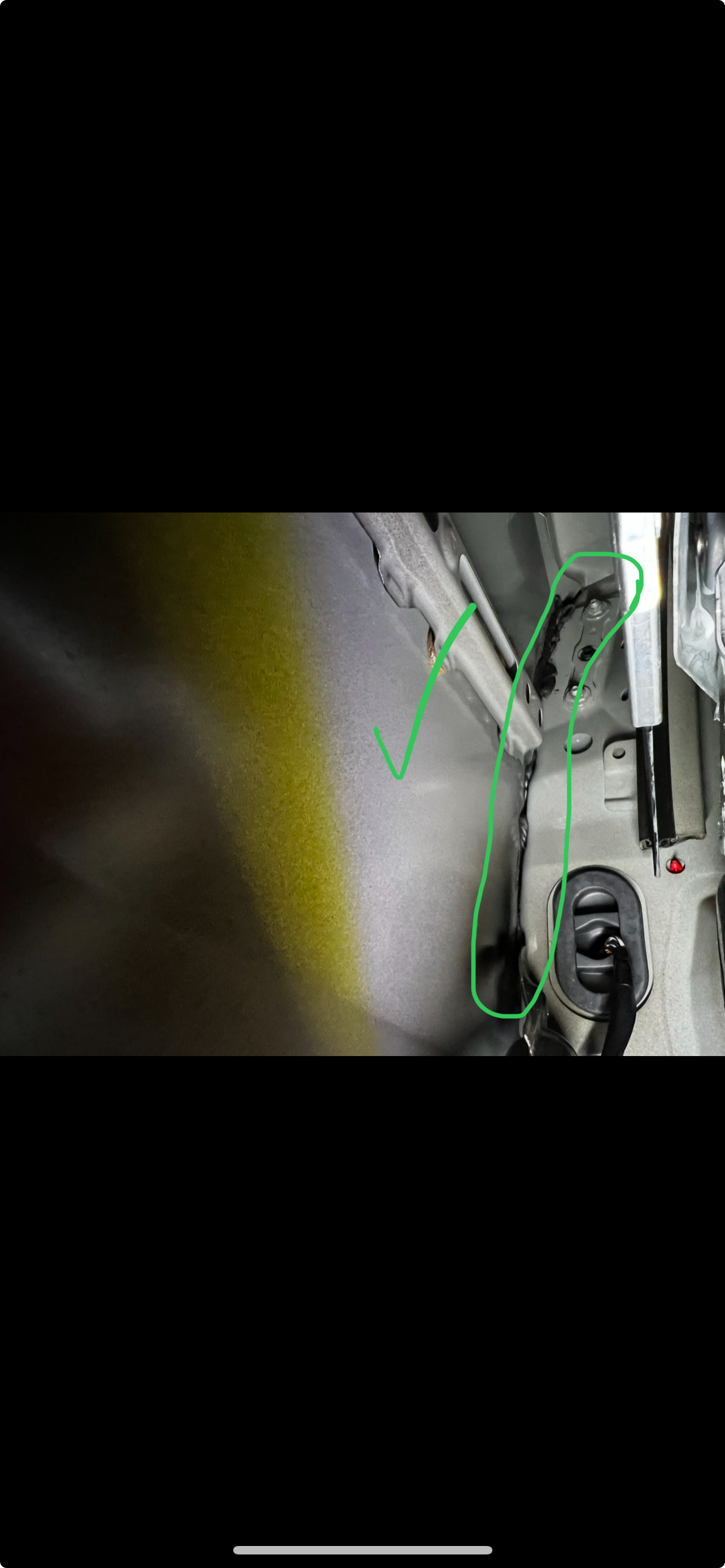

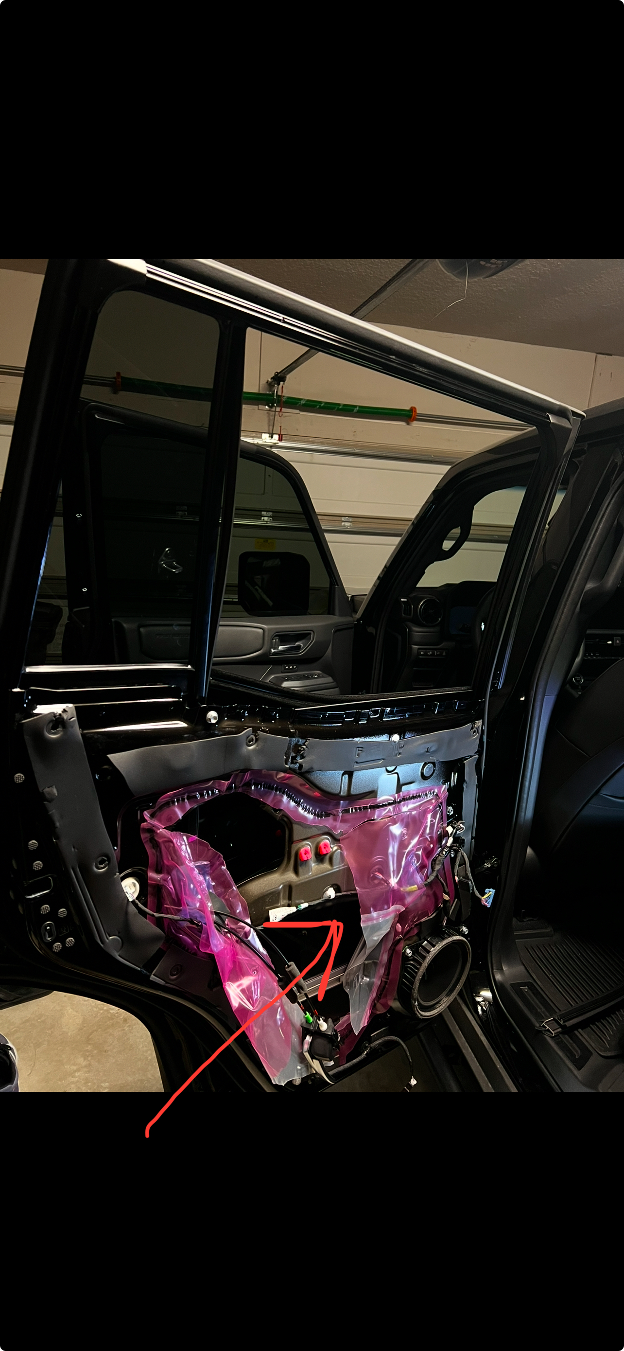

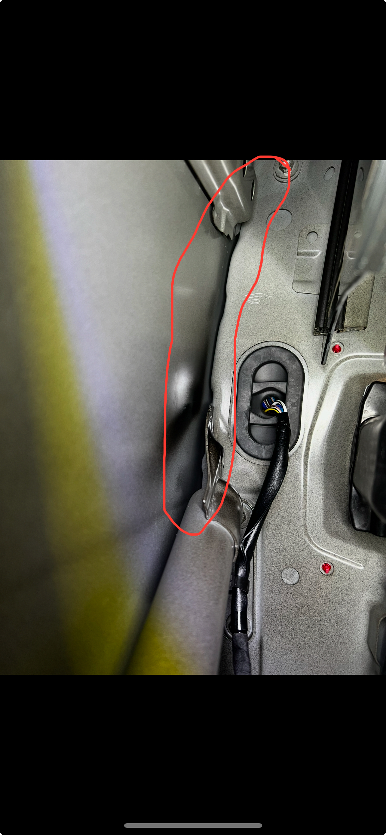

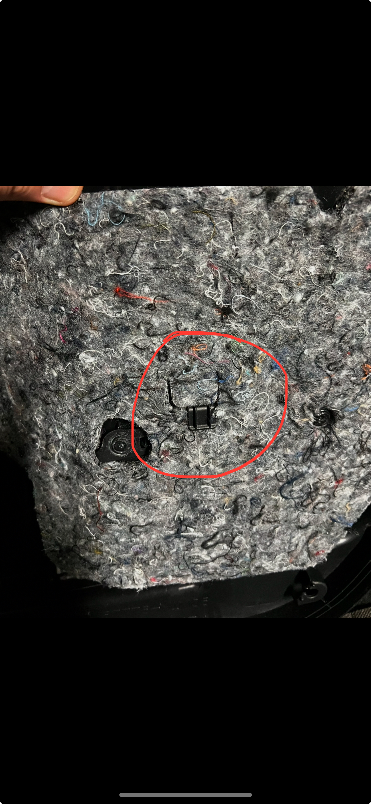

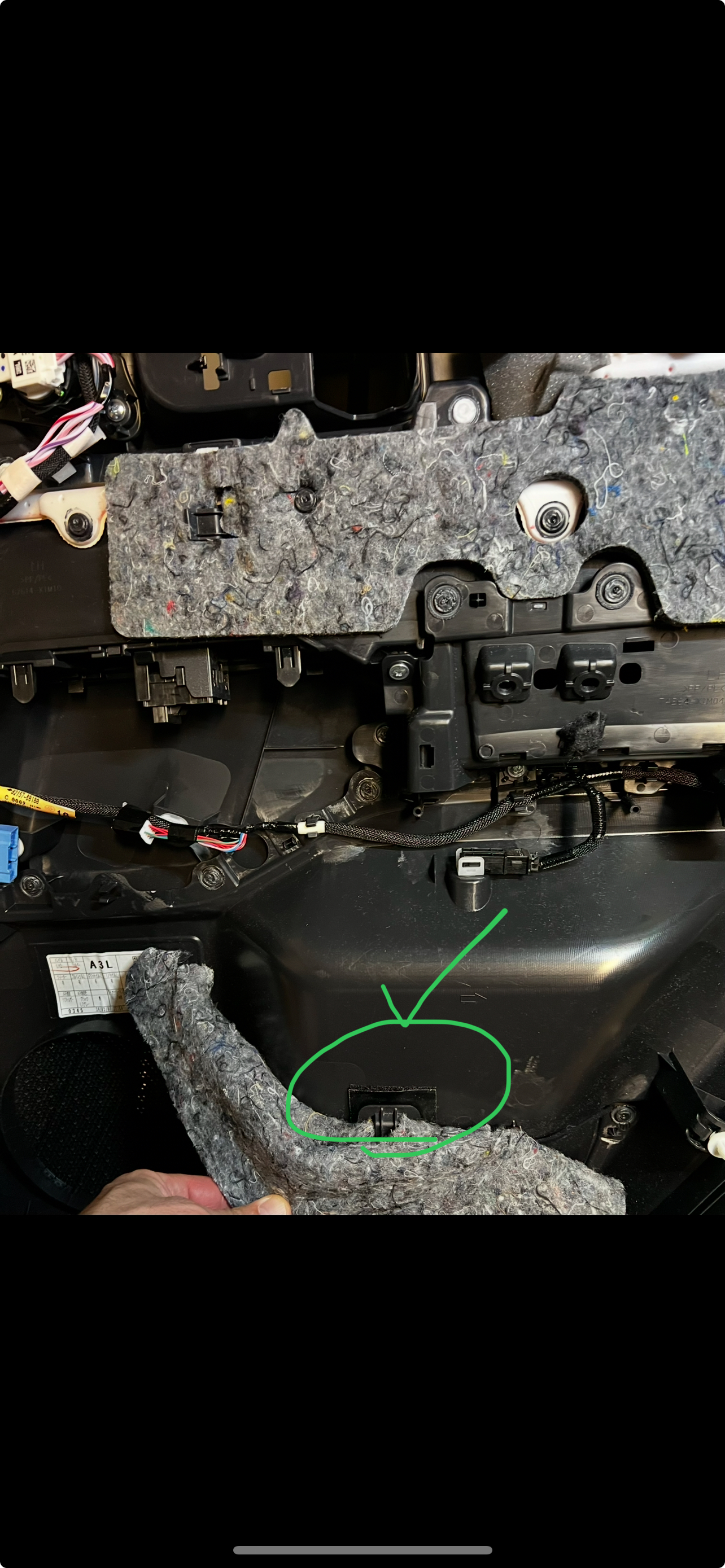

Partial fix. I did all of the other suggestions from other posts. Thank you for the suggestions. I still had the dreaded rattle. I finally have a definitive source and fix. Well two. #1 culprit is metal on metal contact inside the door. If you pound the outside of the door over the drivers side passenger door near the upper door hinge you will hear a tap. It’s the outside door panel clicking against inner bracing (see photos/red). I took off the door panel (again) and wedged sound deadening foam in the groove between inner door bracing and outer body panel (circles in green). Hopefully, that does the trick. I noticed one possible source on the backside of the interior door panel near the bottom (red circle). It’s a cheap bracket that holds the sound deadening material (go figure). I padded the backside of it (see pictures-green circle) and the sound is gone from that area. I also added some 3M double sided foam tape below window frame seals to add tension. I still hear a click over subtle bumps and washboard roads.
