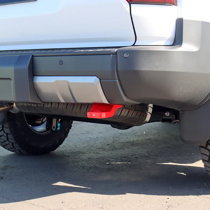

I fit two soft shackles, recovery strap, some utility paracord in the rear storage, a random shackle and a Factor 55 hitch recovery point in the front storage.

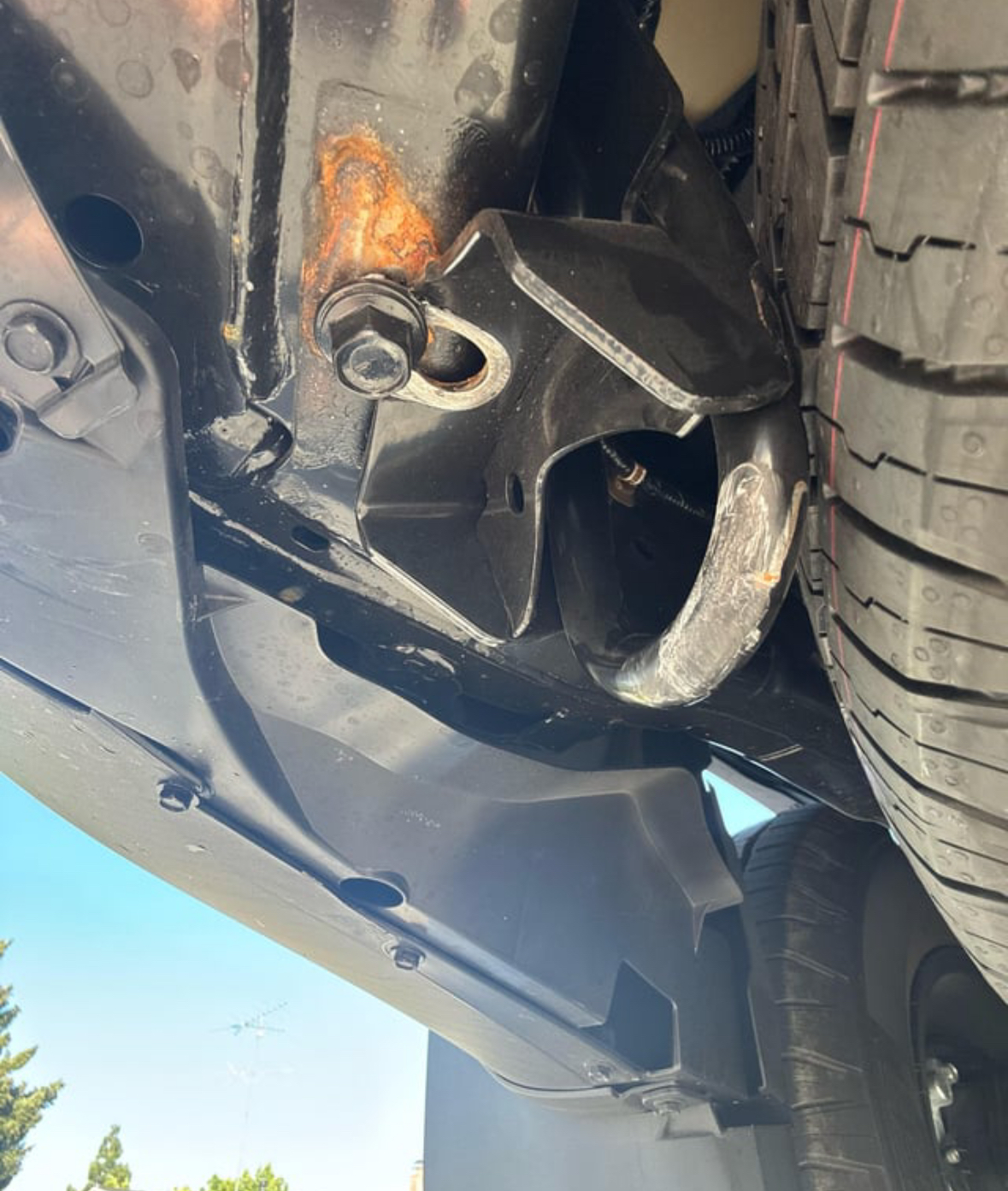

Because the OEM "recovery point" is actually not rated as a recovery point. The OEM part is actually just meant to be used as a tie down during shipping or transport. Worst case scenario is that so-called recovery point breaks during a recovery and bad things happen.

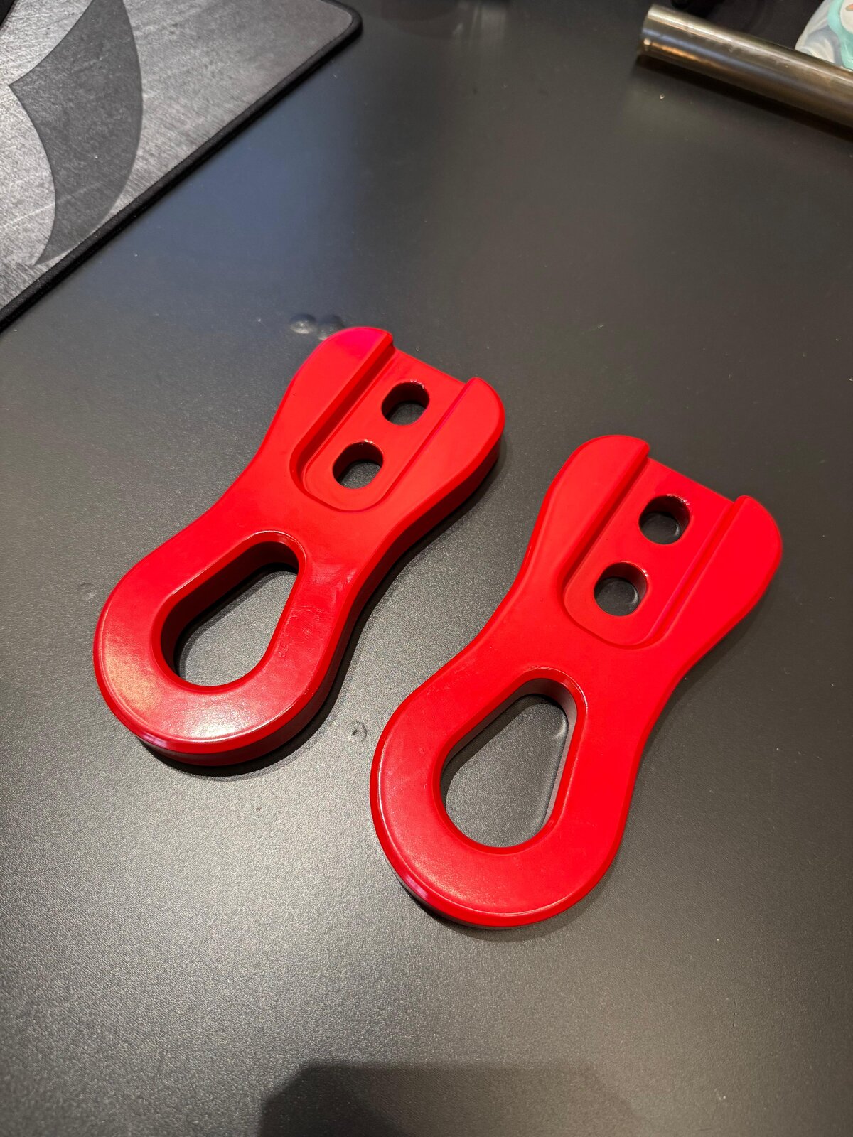

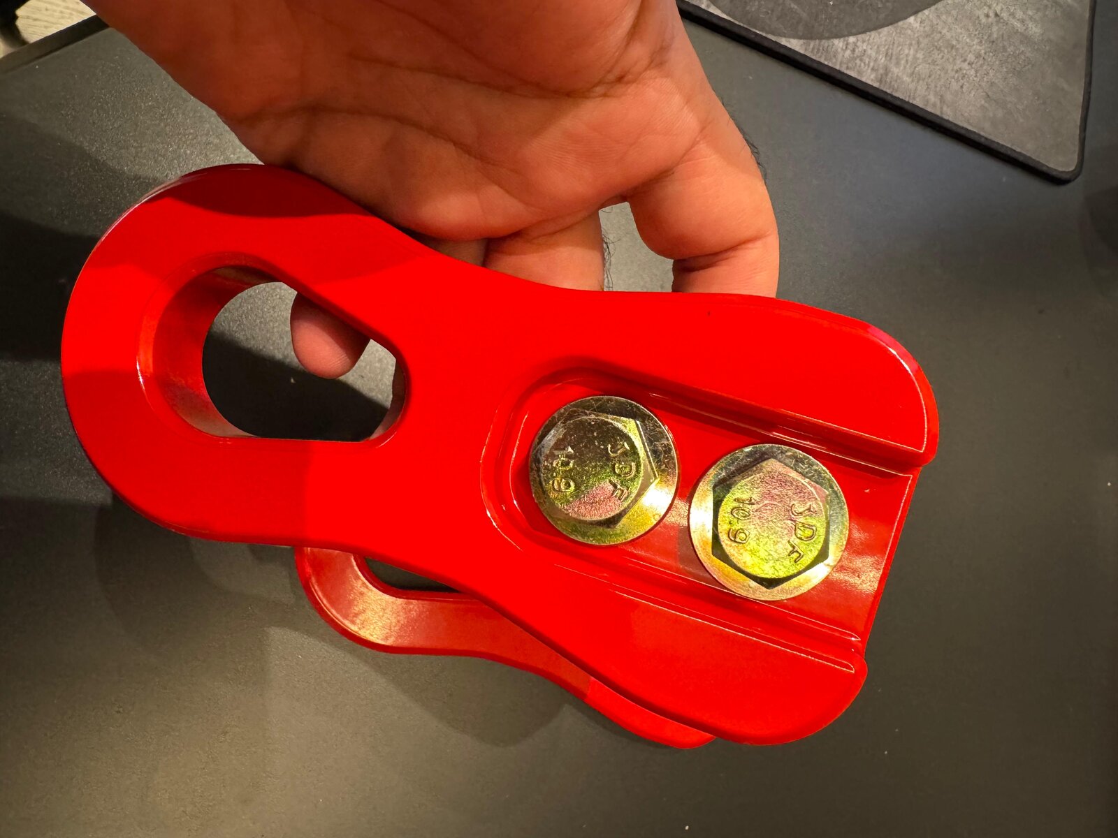

I looked at the bonobo but ultimately decided on the nytop as it was $50 cheaper and the construction is steel vs aluminum.
Just double-checked - looks like the NYTOP is rated at 10,000 lbs on the LC (The recovery point mounts directly to the frame, and has a Working Load Limit of 8,000lbs on 24+ GX550, and 10,000lbs on 24+ Land Cruiser) and the bonobo is rated at 11,000 lbs (Boasts an impressive 11,000 lbs. working load limit, offering reliable performance when you need it most.)
For $50 I'd take the extra 1,000 lbs in the rating, but that's why there are options for everyone! I was surprised to see the GX550 at an 8000 lb rating though - must not be as stout of a mounting point. +1 for the LC!

I got my Victory 4x4 front recovery points yesterday, they look amazin
I went with the nytop one as my insurance is covering some of the cost. When I got it I was kinda shocked to see how beefy it is. I’ll take some comparison photos and weights when I get back home.
Just order one (NYTOP). I like steel than aluminum.

The OEM one is not rated for recovery especially when vehicle stuck in rocks, muds, steep slope ( its weight can be extremely heavier than stock!). Also, the OEM one hidden under the bumper so that with awkward pull cable…the bumper can be destroyed easily.

I went with Victory 4x4 because they were available and ready to ship, they're made from steel cnc cut plate, and replace factory bolts with higher strength bolts, and i liked their design with the bolts tucked in and not sticking out, you can go wrong with any of them, but so far I'm waiting for a better option for the rear recovery point, currently i'm using Factor 55 hitch mount recovery point.
Hi there, new member here. Just came to chime in that yesterday I was just involved in nearly an identical accident on my brand new LC250. I’m not sure if there is any frame damage. The rear recovery point saved my vehicle. Thanks for everyone’s feedback on this thread. @ptahkeem is there a reason you decided to stick with the OEM bumper? Was thinning about using this as an opportunity to upgrade to a dissent rear bumper.
