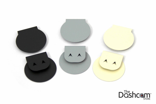

How do you secure them?
It’s a simple metal piece that has serration on the smaller/tab so that it holds in the space between the rear headliner. Then I just added some Crazy Glue (Harbor Freight version) between a flat magnet that I had from AMZ and the adhesive pad on the cam itself.
Including shipping, I think it was $23 which felt like a lot for a small piece of metal, but it solved my challenge instantly and people need to make money for their creativity and marketing.

The dashcam store has one for Toyota SUV . It mounts on the metal channel. Viofo 329s is what I have. Easy install
Thanks. I have a Garmin mini 3 in front and was looking for something that would fit in the back.
