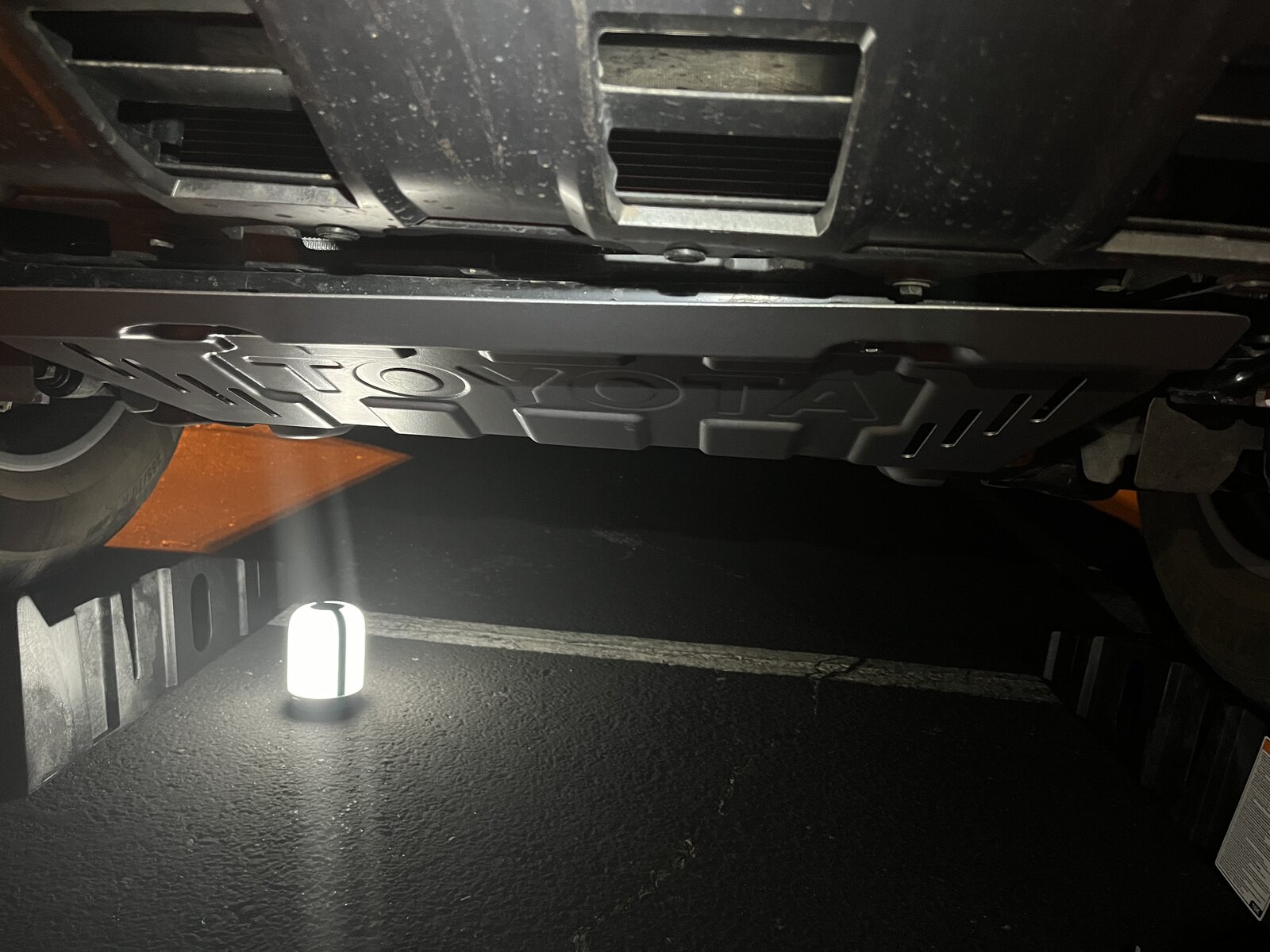

They seem easy enough to install if I can find somewhere to act as a ramp
I picked up ramps at Autozone and ordered both skid plates online to install on my own. Still came out ~$500 ahead compared to what the dealership quoted me.

I did it without ramps, and it was admittedly a bit of a PITA, but doable.

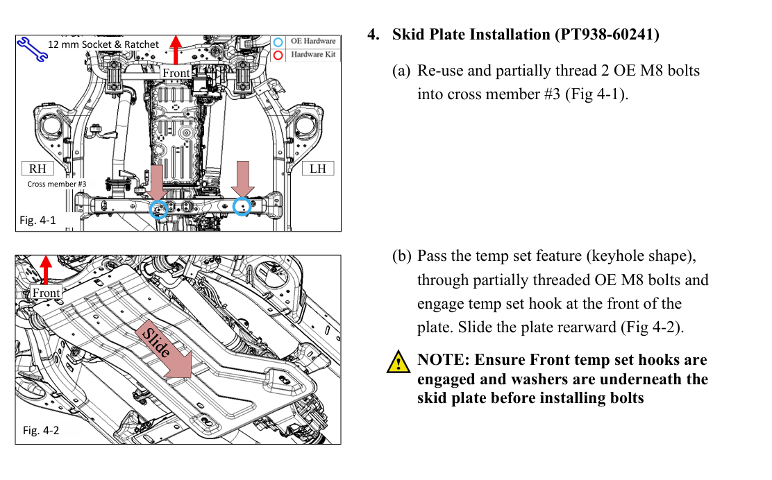

The FE skids cover the Xmsn
I mean if I put the FE *
I mean if I put the FE front plate in only (part 60242), might I be able to install the trans skid of, say c4 fab in the future and then further down the line upgrade the front skid
Got ya........ I'm not sure about compatibility, but anything can be modified........

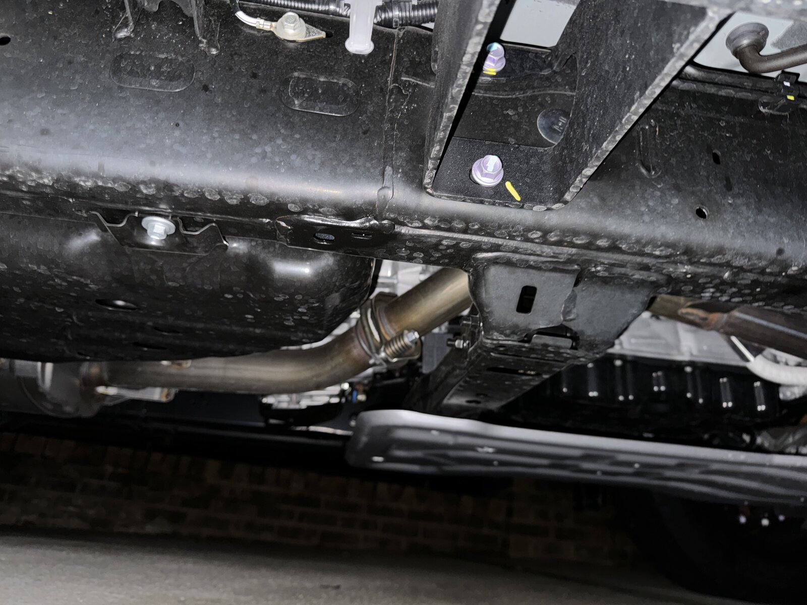

Whilst installing my skid plate, wouldn’t ya know…. Noticed my Radiator bracket is bent
If you're looking for a way to unbend it, Wrap a chain around a 4X4 (or like item) and drive the front tires on top of the 4X4, creating an anchor point. Attach a pulley on the chain so that the pulley is right below the point of where you want to pull down. Run a cable through the pulley and attach it to the point you want to pull down. Gently start pulling the cable ensuring the metal is being pulled in the direction you want.
Clever, though admittedly I worry about the welds breaking
I am also looking to have some kind of steel reinforcement fabricated that will attach to the recovery points; guess I should have just gone with one of the aftermarket’s and waited. Wasn’t keen on not even having a debri shield though
