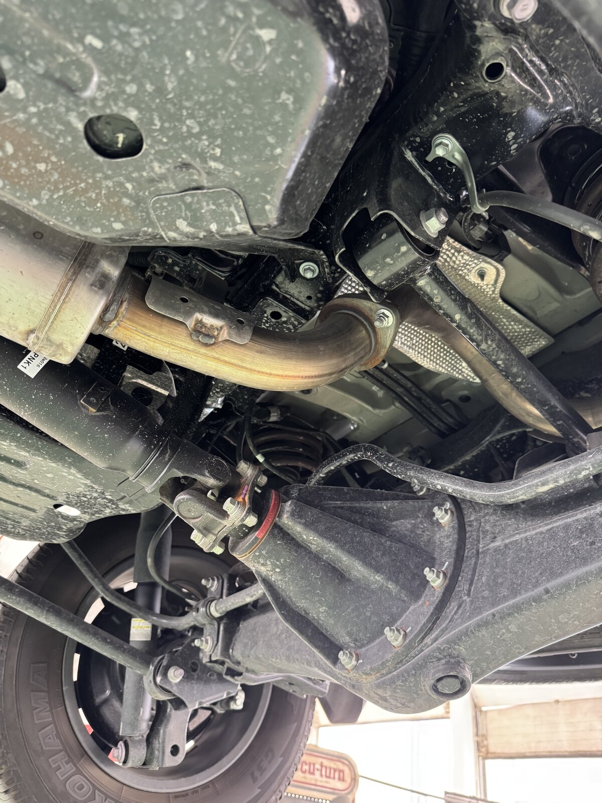

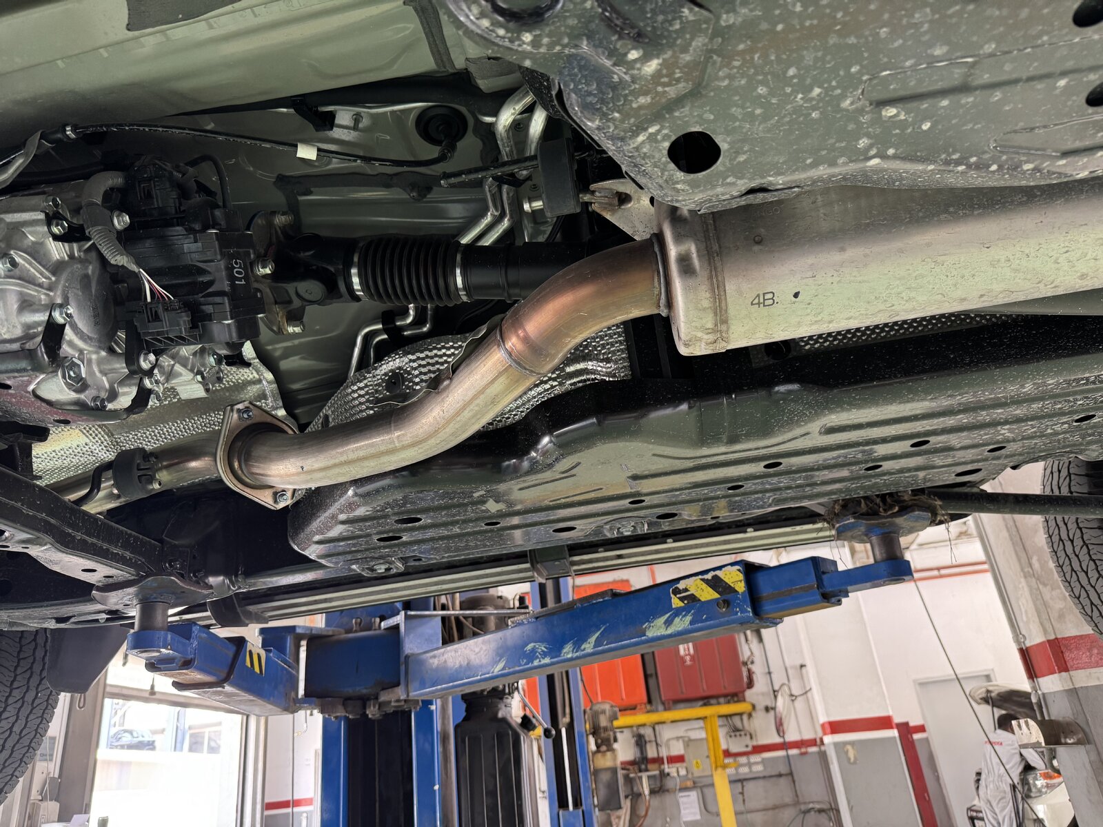

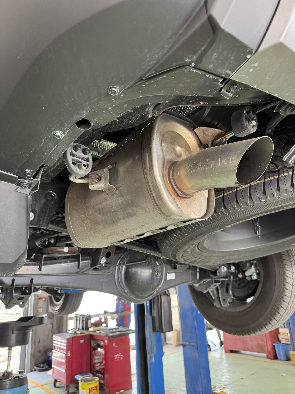

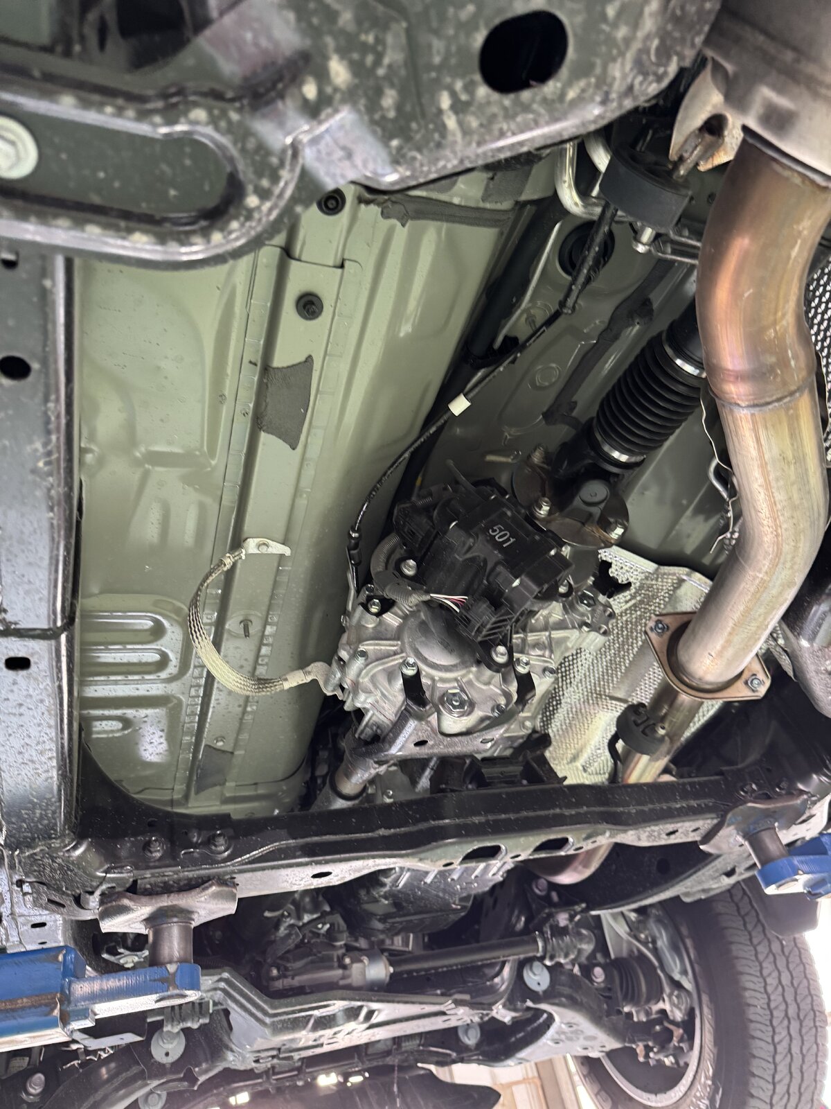

Thanks for the reply, would be great if you can post pictures of the exhaust side to side, our exhaust is much different of the US version i believe, here’s some pictures i took when they changed the oil.

Please let us know if you can use the tail pipe only on stock center pipe, since i only need the clearance not the sound.
does the performance cat-black exhaust increase the clearance in that area?
