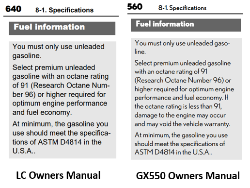

    The Land Cruiser’s manual recommends premium fuel but doesn’t warn of damage if you use regular. Compare that to the Lexus GX550 manual, which explicitly says, “damage may occur” if you use less than 91 octane. The lack of this warning for the Land Cruiser tells me that regular fuel won’t harm the engine—it’s just about optimizing performance.

    The Land Cruiser’s manual recommends premium fuel but doesn’t warn of damage if you use regular. Compare that to the Lexus GX550 manual, which explicitly says, “damage may occur” if you use less than 91 octane. The lack of this warning for the Land Cruiser tells me that regular fuel won’t harm the engine—it’s just about optimizing performance.View attachment 24056

The same warning is also on the LC manual, it is on the next page.
