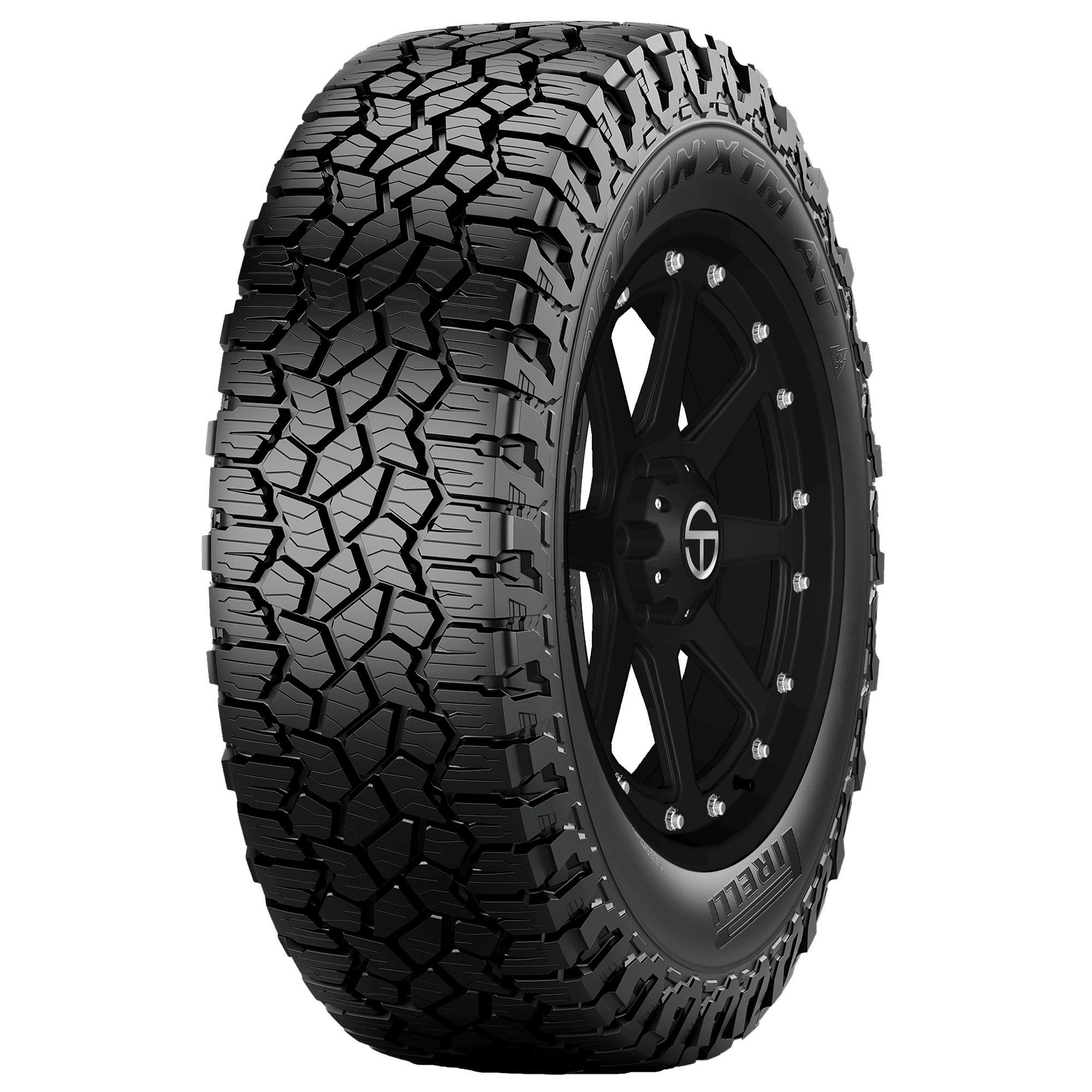

Pirelli Scorpion XTM AT look compelling. I may go that route for my next set.​

I have an appointment to swap out the wife's 275/60-20 Scorpions with 6k on them for a set of G3s in the same size XL load this Friday. I was waiting to post here until after the deed was done. I've had them in for three separate road force balancing sessions and even had one replaced under warranty due to requiring far too much weight to balance properly. They have been hopping in the wheel wells since we turned 3k on them during our trip to TN. I've also heard great things about them, but my experience has been anything but. Darn shame given how much they run.

Ouch! Pirelli wont want to see this post. I was planning on getting same tire, but had already found a few reviews complaing about the pirellis. G3 also my choice now

I’m sure they won’t ever see my criticism, and I’m not stressing it. I’m just glad it happened early in their life and I was able to come out clean. I am also stoked to get the wife into some XLs.

When you have those kinds of issues, look for flatspotted wheels or a lateral wobble

Again, are the wheels true? Have them spin a wheel with nothing on it. Check not just circumference but lateral as well. You'd be surprised. I had a wheel on my 2004 Jag that was round true but had a lateral runout issue. Total PIA!!!
