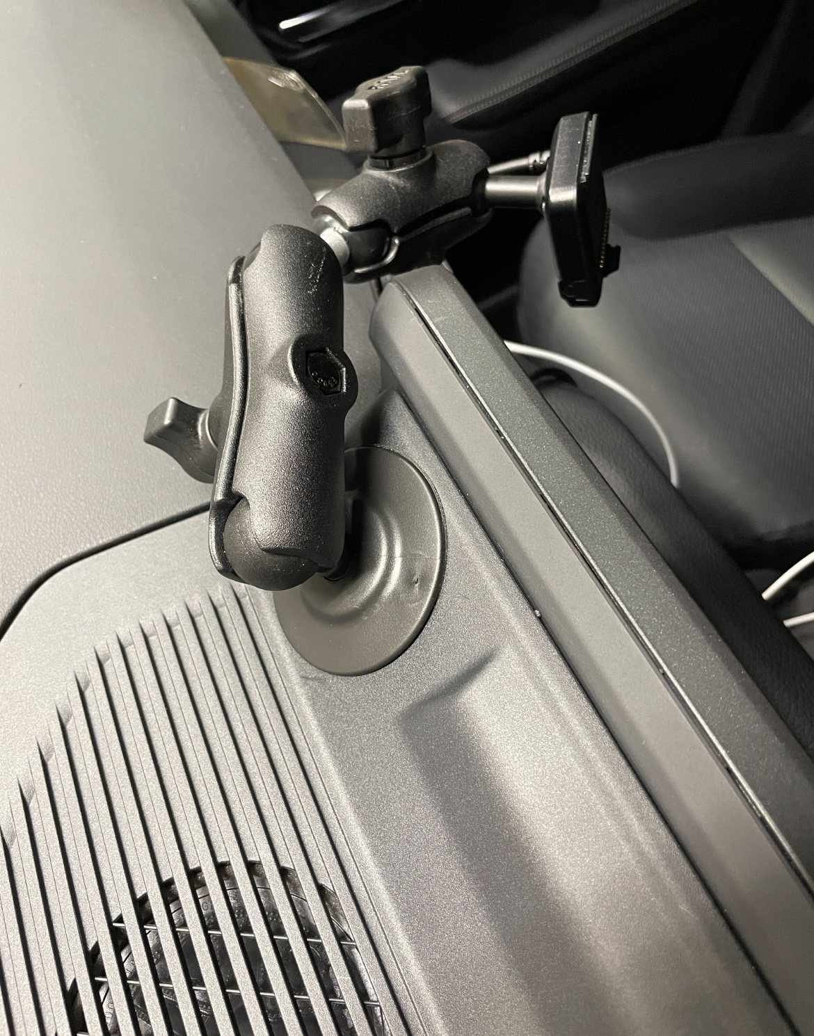

I used a Ram Mount ball mount system. I purchased the 1” ball mount with adhesive and placed it on the flat side behind the media screen. There are flat areas there that seemed to work well . I then used some of the mounts to bring my Garmin nav to the right side of the screen.

Yep- I think it is 3M VHB. It seems to adhere very good. I used that area because the other parts of the dash are a soft material. Also Ram Mounts has lifetime warranty, even if the adhesive comes loose.
