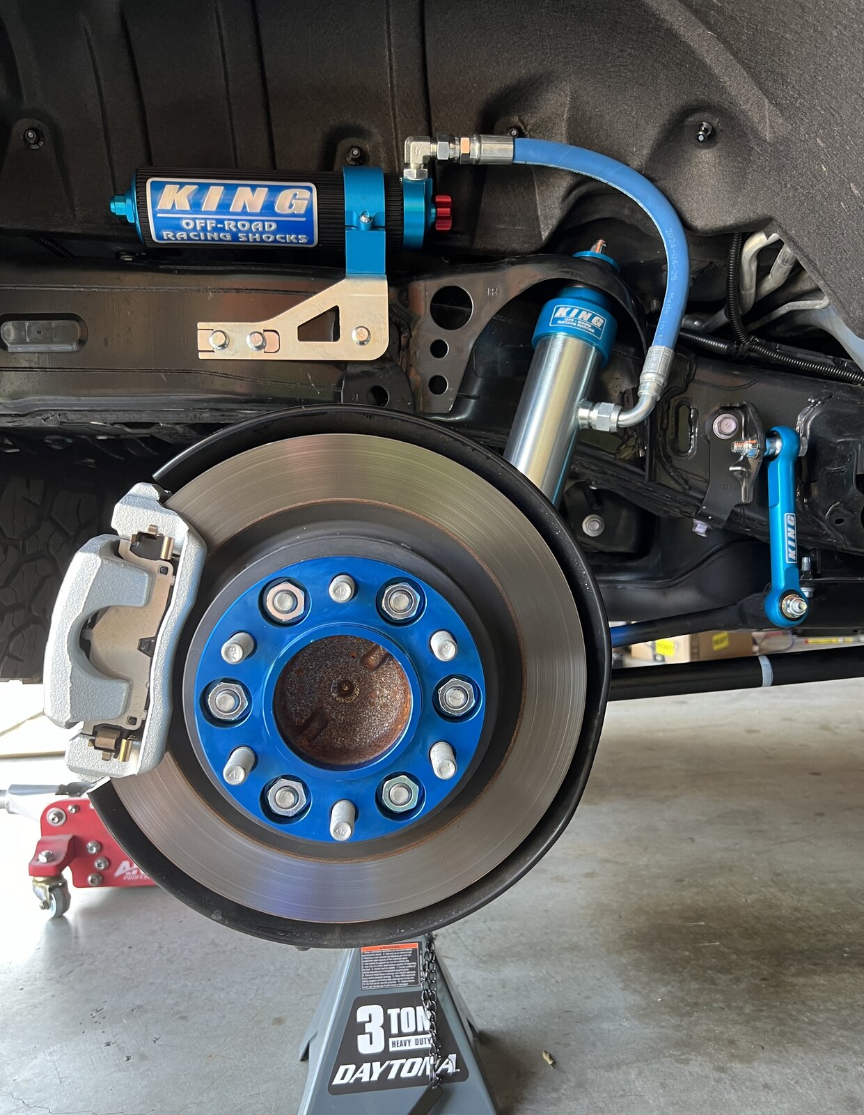

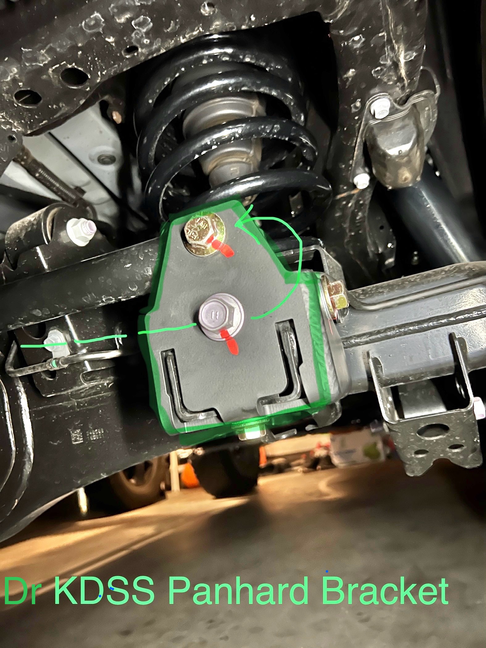

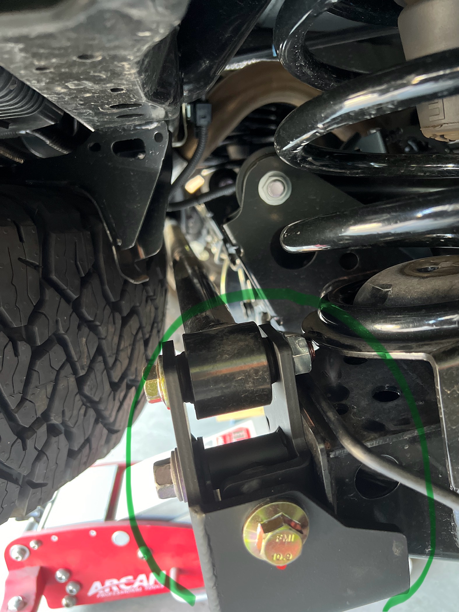

Look at my attached photos.
My suspension kit + Dobinsons 2” lifted rear springs (170-330lb gear weight)+ panhard bracket. Installed by RPM Garage in SoCal. Run super sweet and bring me pleasure smiles in every single ride ;)

All attached photos are mine.
I believe that stock angle is not perfectly horizontal.
When 2” lifted…the bracket helps to bring the other end of track bar +_2” up.
Anyway, I just shared my real life experience with my setup. To me, it is “perfect” ;)

Your running factory track bar then with Dr. KDSS shorty bracket?

Correct. OEM track bar + shorty bracket. Mine is 2” rear lifted.

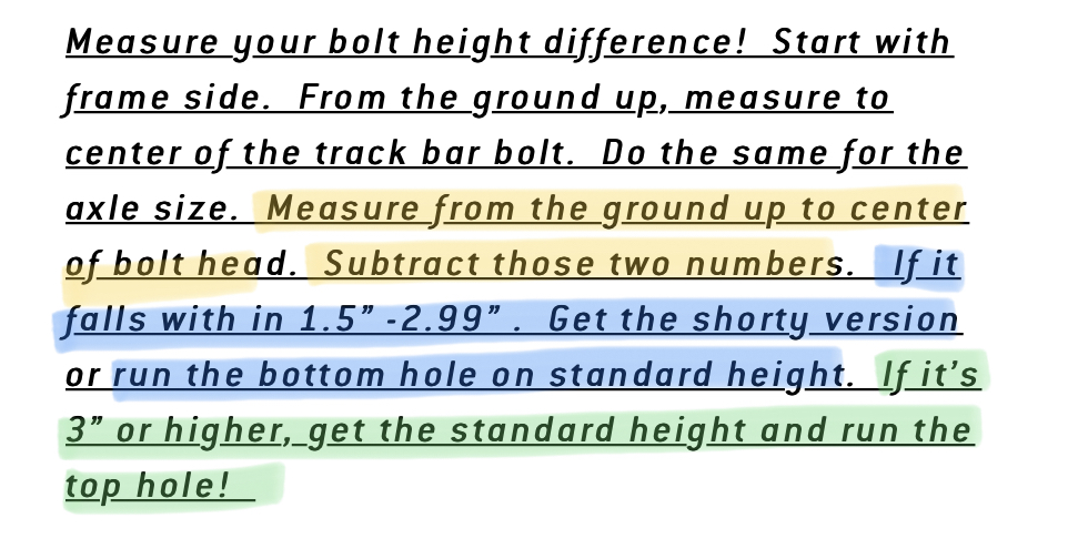

You can get the “standard” bracket with 2 holes, then attach to lower hole if 2” lifted…or upper hole for 3” lifted.
Here is the website. Good luck, bro
